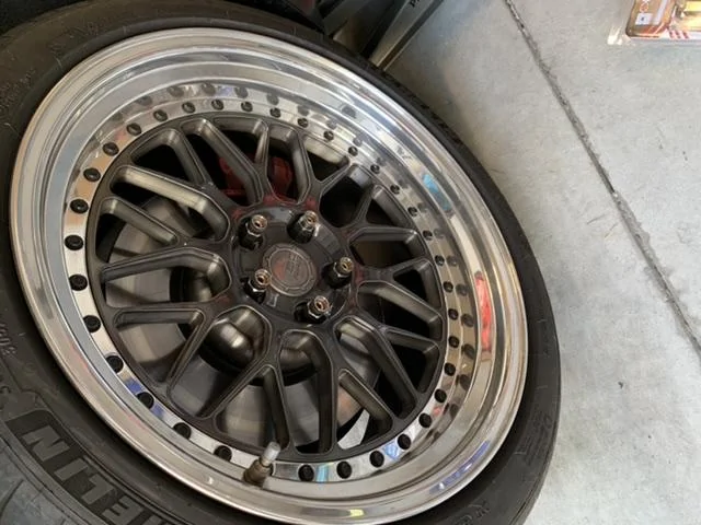

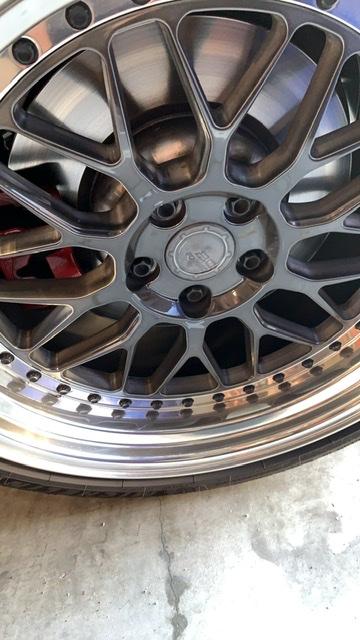

Just started on my wheel stud and lugs conversion. Running the 14x1.25 to 14x1.5 conversion studs but not really feelin the lugs I picked out. What is everyone else using for conversion lugs?
Before
After with studs

Stud conversion, long enough to handle 15mm spacers if I want to add them later. Went to lugnuts similar to what you show, but darker in color and they fit into the stock wheels more so they aren't as out of place as yours look.

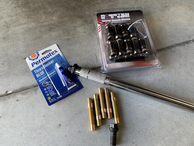

I used a 75mm stud. From what I've read these are only good up to a 12mm spacer if I decided to run one. There are 80mm and 90mm studs available online as well. Bought these on eBay but Motorsports Hardware has a few of the options.
