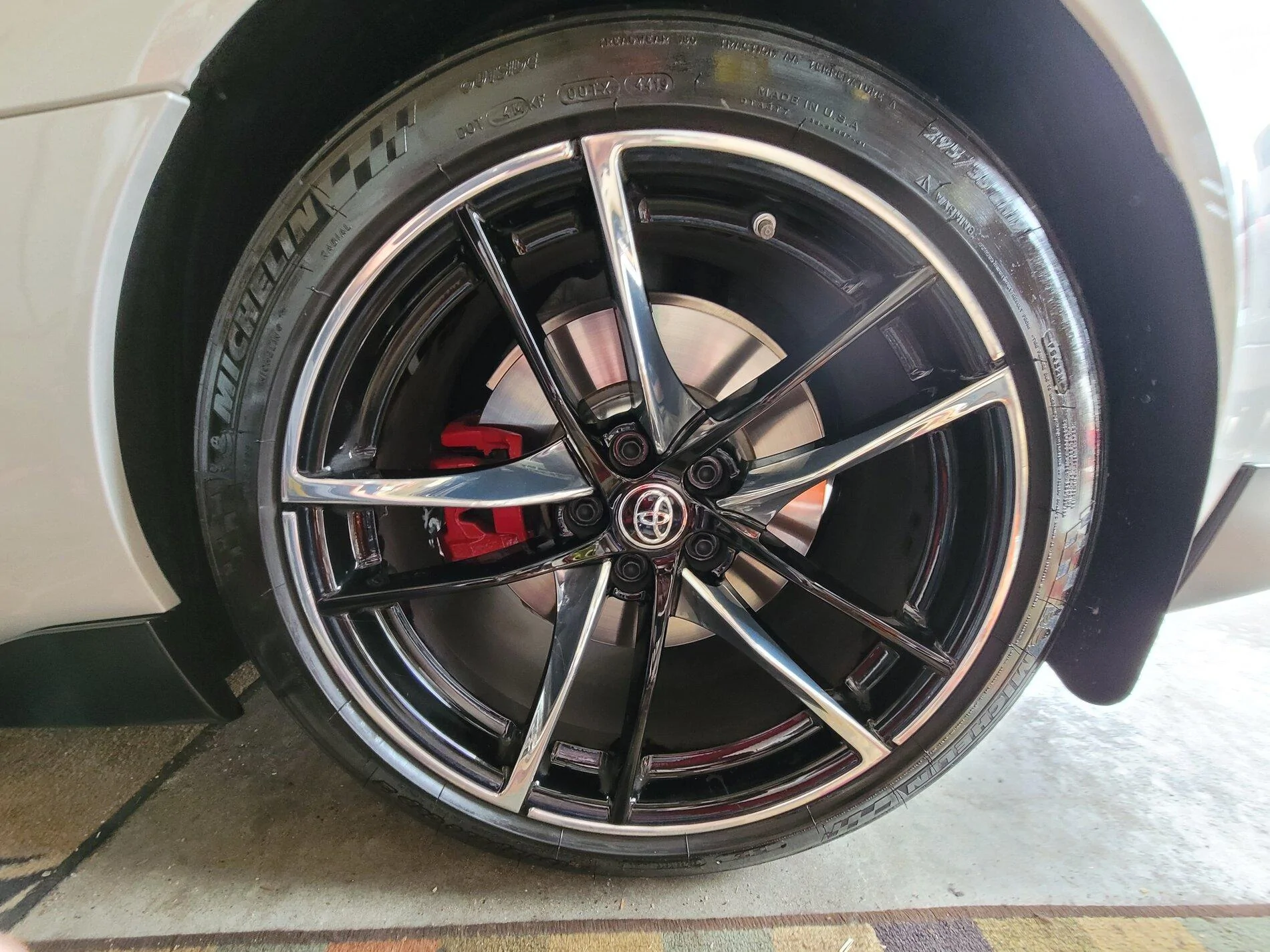

I’ve been running 305/30/19 Michelin PS4 with 10mm spacers for a year now and they feel great. Lowered on H&R springs and no rubbing. A little spin in first gear but grips great afterwards (stage 2 tune). I also run 275/30/19 up front and the car feels planted.
This is brilliant, If you’ve had them on for a year I’m assuming at some point you’ve pushed them pretty hard so I feel confident in going with either option.

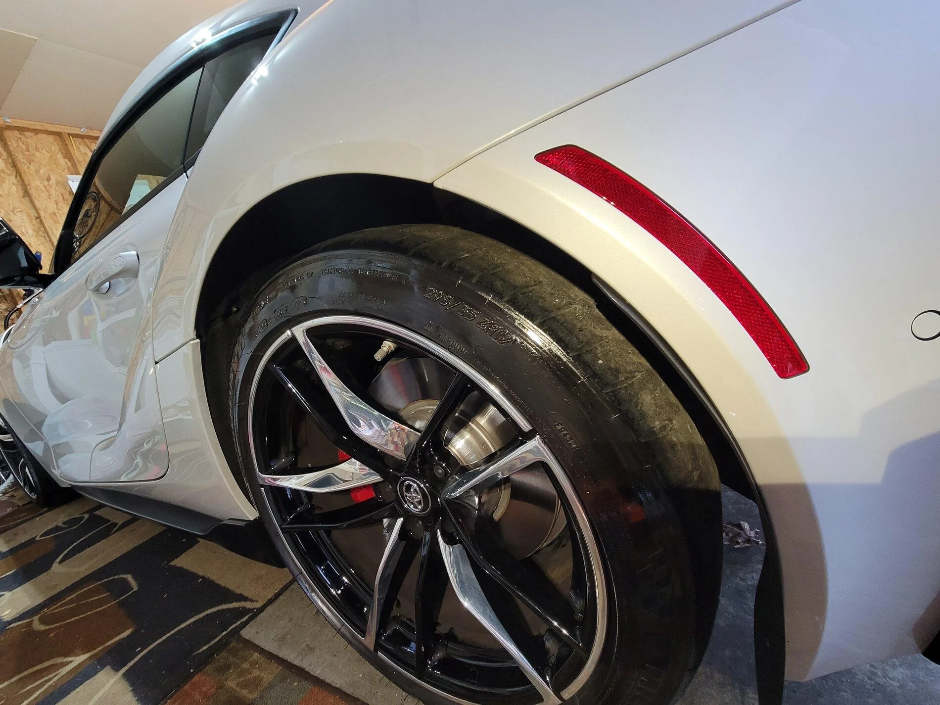

here ya go, 295/35r19 Conti ECS
Anyone know of data measuring the delta in grip (maybe in Gs) in moving from one size to another? I know it’s complicated and best measured by a before and after on same vehicle, same tire type, same road conditions, but I’m wondering how this might change grip laterally and longitudinally.
I did a track day, autocross and drag strip with these tires and had no issues. The events were my first time doing them so I don’t have a comparison to the stock setup or other tires.
