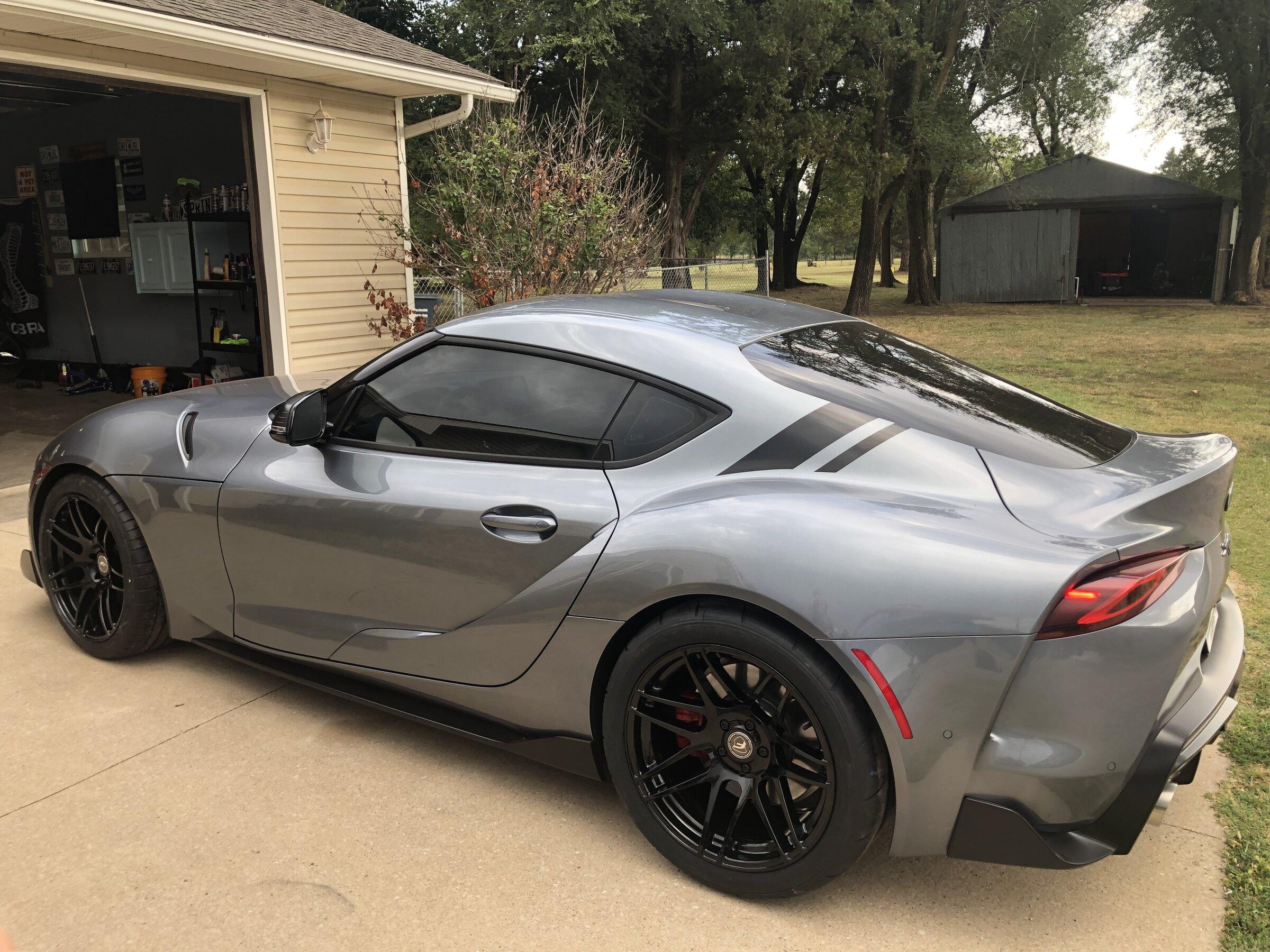

Im running 19x11+38 305/35 and 19x9.5+23 275/35 If you ever want to come up to Enid to check them out in person to get an idea just hit me up.

19x11 with 305/35
