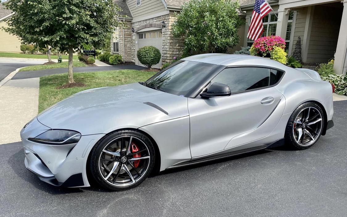

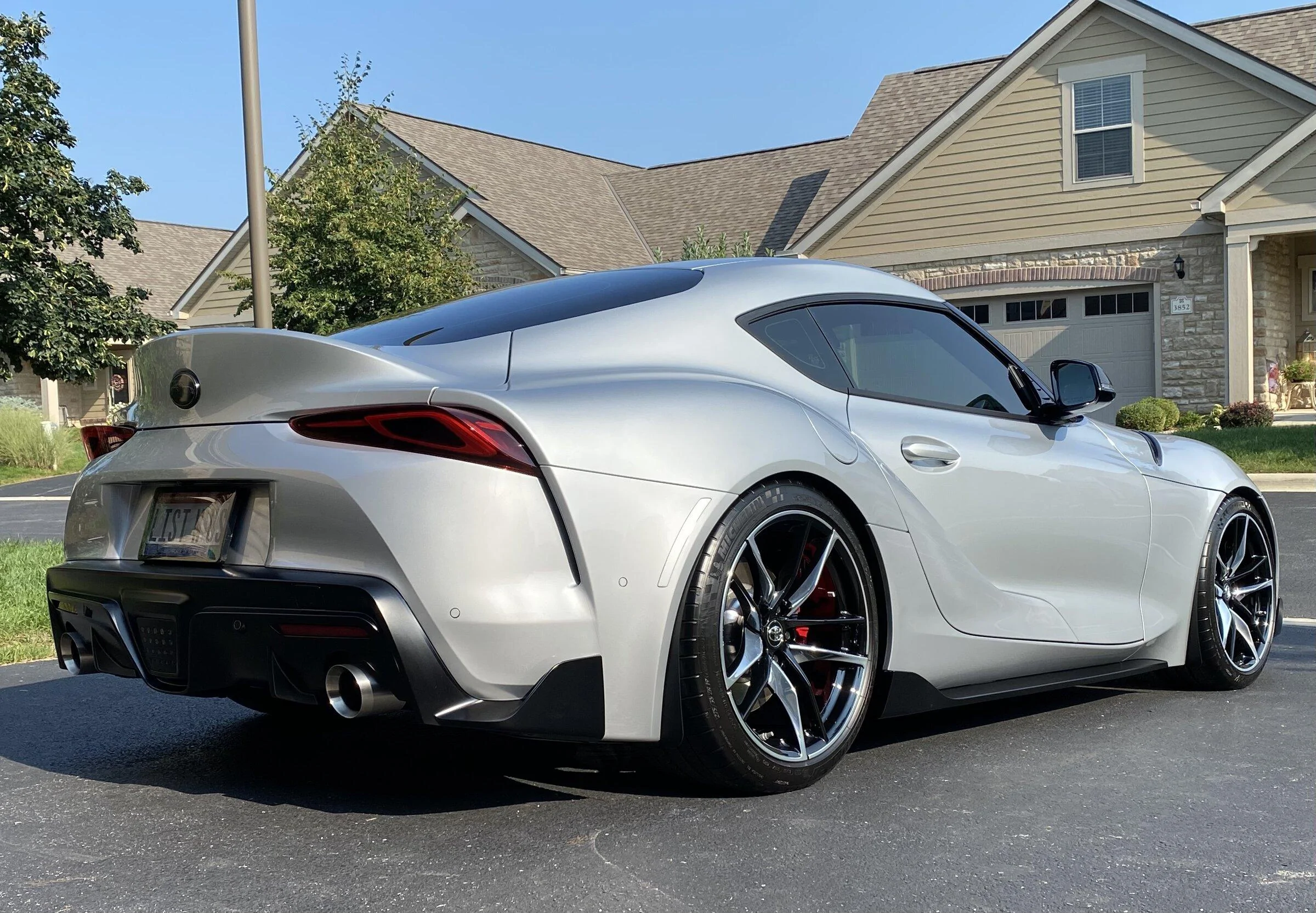

That’s a personal taste question.
I like to live on the conservative side and I’m running Burger Tuning spacers in a 13mm rear and 10mm front.
Some like to aggressively push the wheels outside the fender (w/ 20-25mm) … I think it looks goofy and that one’s trying too hard… but as I mentioned… personal taste.

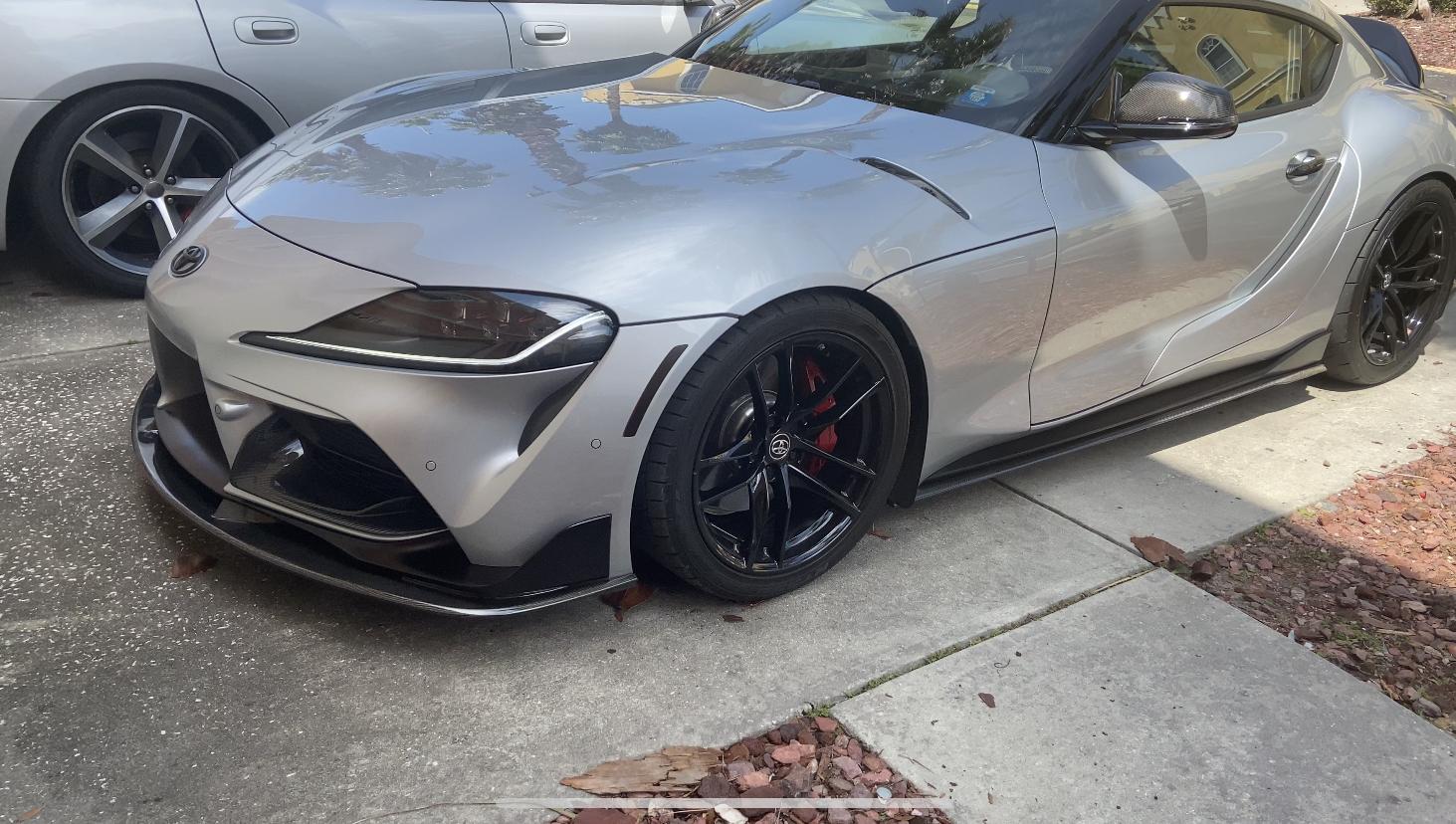

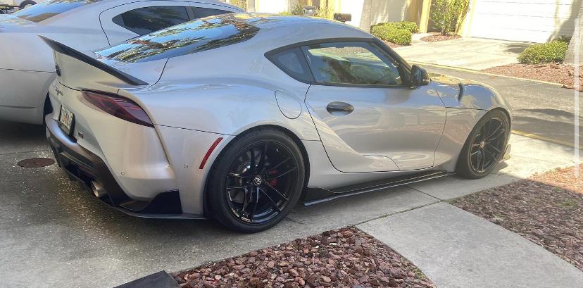

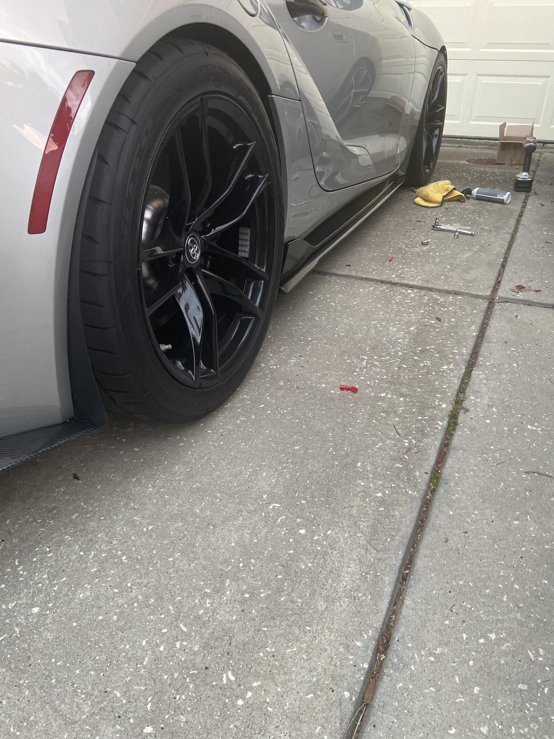

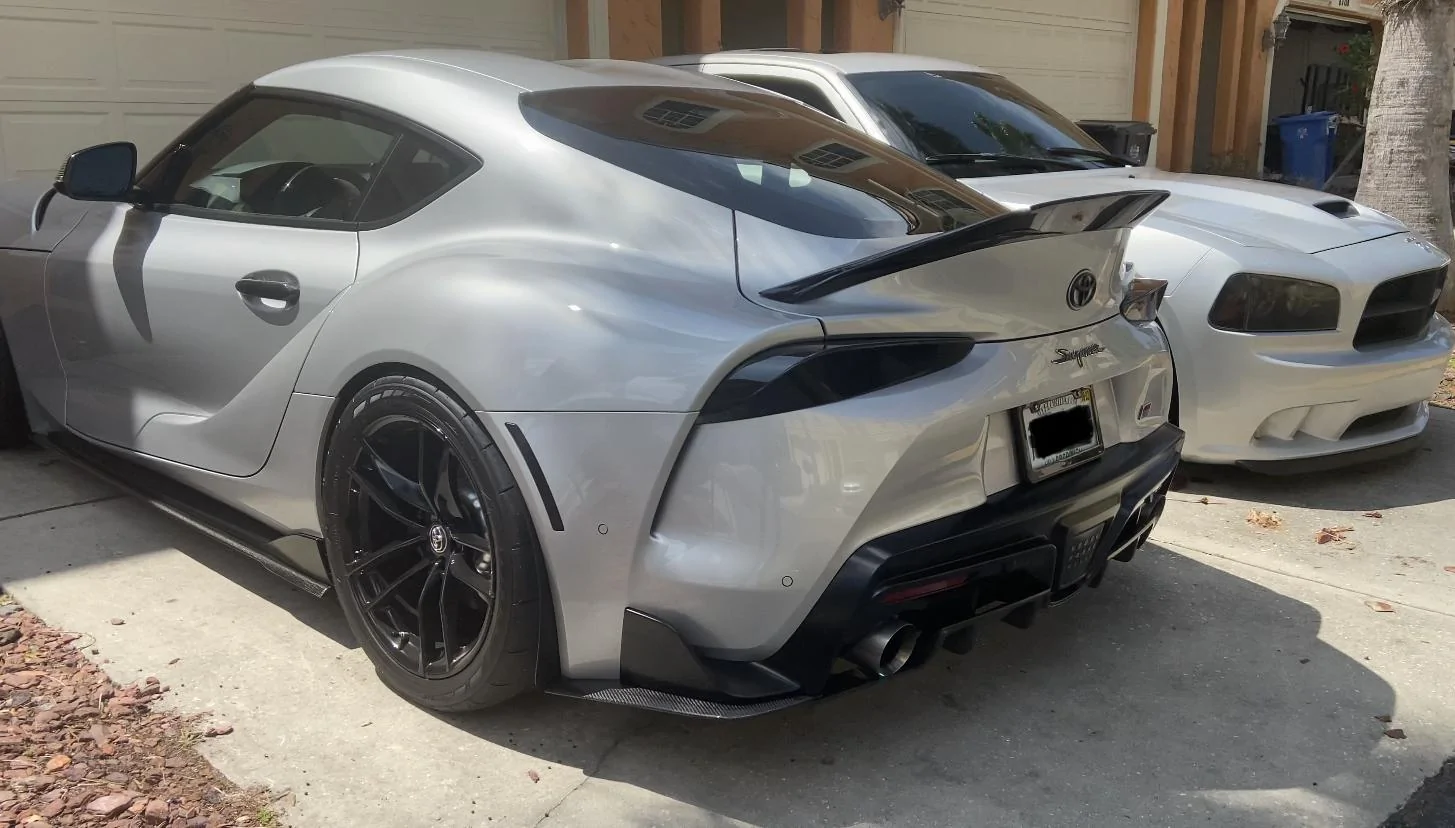

I am using the following:
IG: wun6ck_mkv.813 (Can provide full list of current build)
  • BMS 13mm(f)/15mm(r)
  • Lowered on Eibach Euro springs
  • Nitto 555 G2 265/19/35
  • Nitto 555 R 285/19/35
Shaun
Nov 5, 2021
Tampa, FL
Toyota GR Supra
Are these red lip things just bolted onto the factory sideskirts and rear diffuser?
My front lip, skirts, and rear diffuser are bolted and 3M.

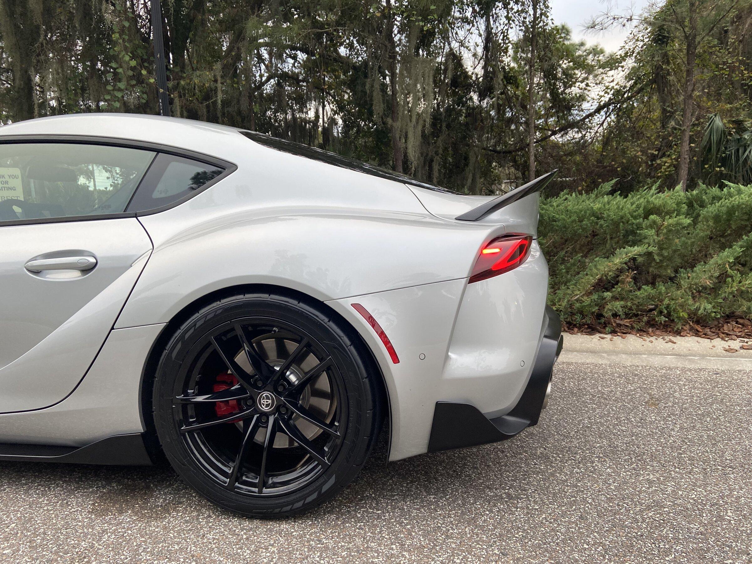

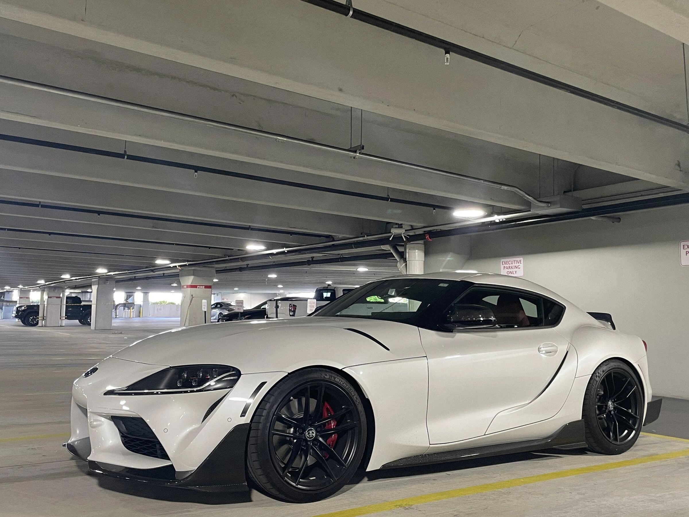

lowered on swift springs, stock tires 13/15..
love the even drop on the swift springs. Very close to OEM rake and comfort.
If I stay stock tires would def recommend moving up to 15mm front and 18mm rears.
