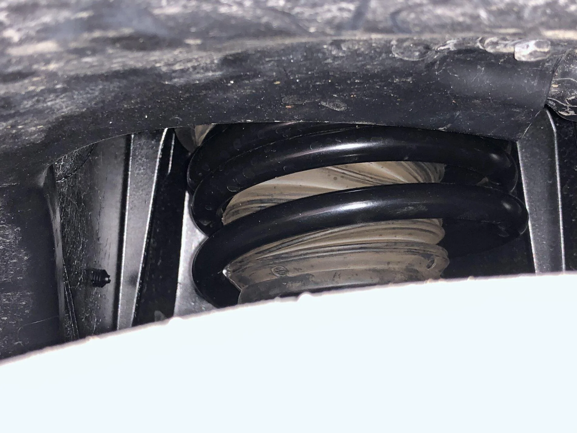

Now if I can only figure out what's causing the front right to rattle... Hard to describe the sound, it's not a low end thunk or clunk, but a tap sound, not quite a high pitch click though. It doesn't happen everytime I go over a bump, and large bumps don't always make it rattle. Sometimes even a small bump will do it.
I noticed the boot is squshed a bit, but I ensured everything was properly aligned when putting it back into the mount. When I get the bump stops, I will make sure the bearing assembly is put back together corrently (which I am pretty sure it is). Attached is a photo of how the rubber boot looks when there's some load on it.

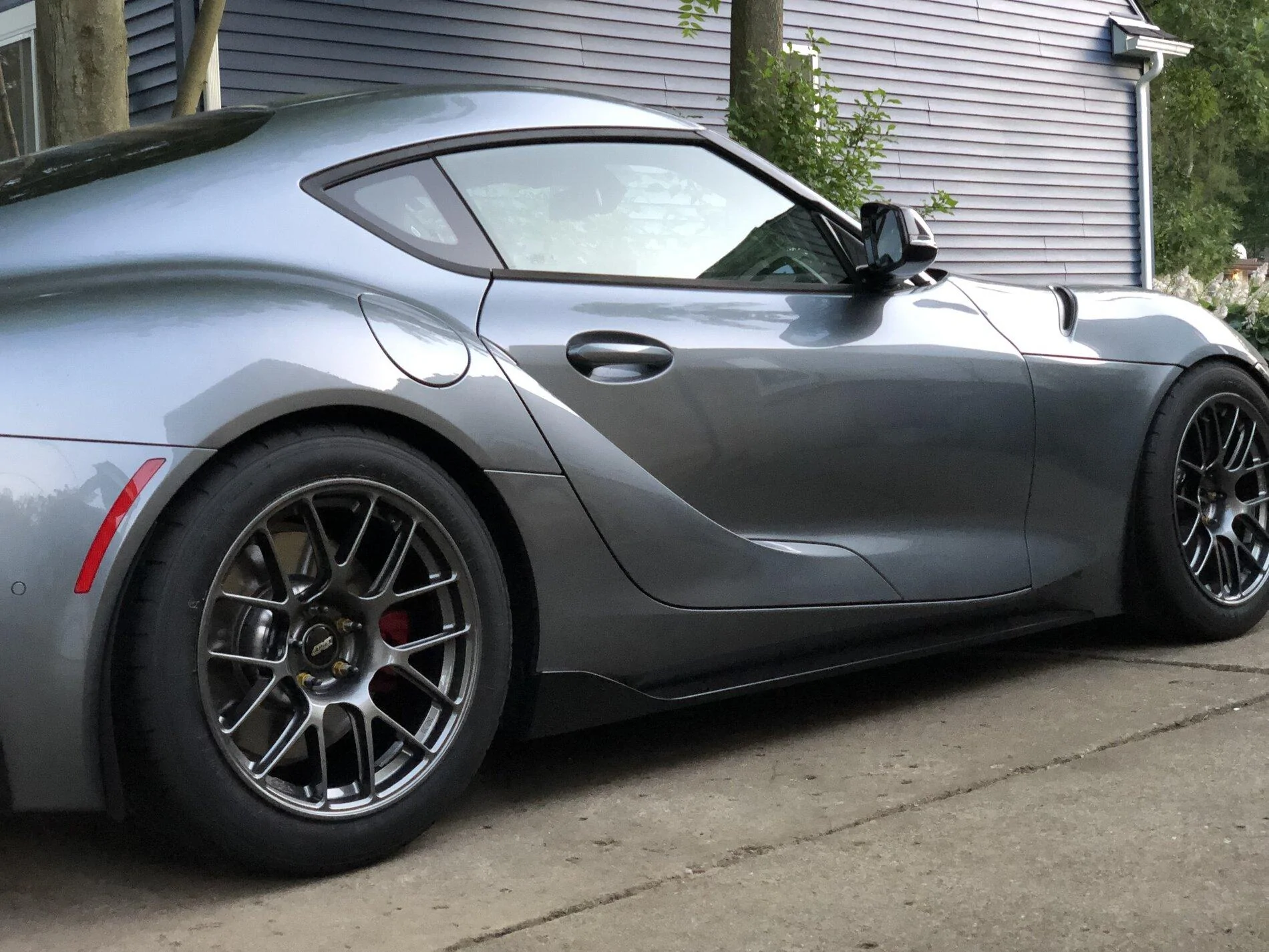

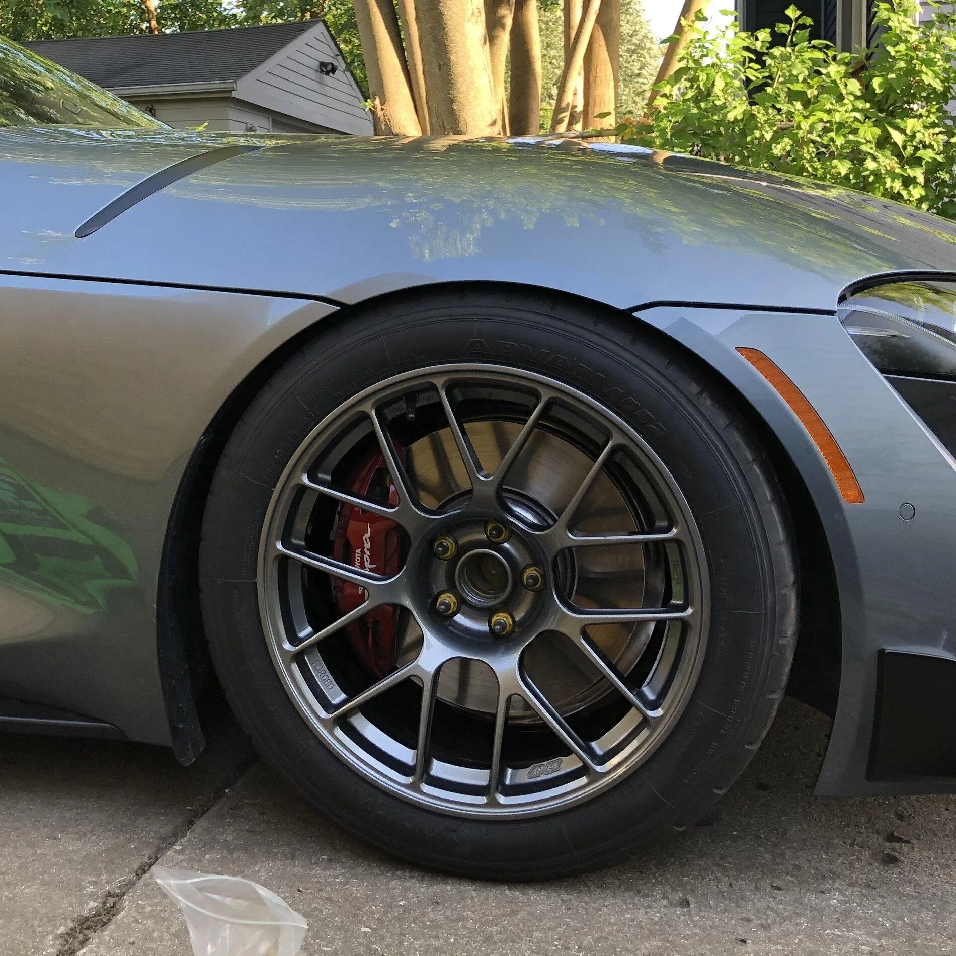

New bump stops and studs installed along with new wheels with 12mm spacers in front. Car rides great, no rattles.
Unfortunately the front tire rubs very slightly upon compression. Running 275/40-18 squared. Not sure if I can get any more negative camber up front with stock parts. If so, I am not sure what I could even adjust to do it myself!
Attached are a couple photos of the wheels and tires. I know, I know... Close up photo of wheel doesn't have center cap installed yet ?
