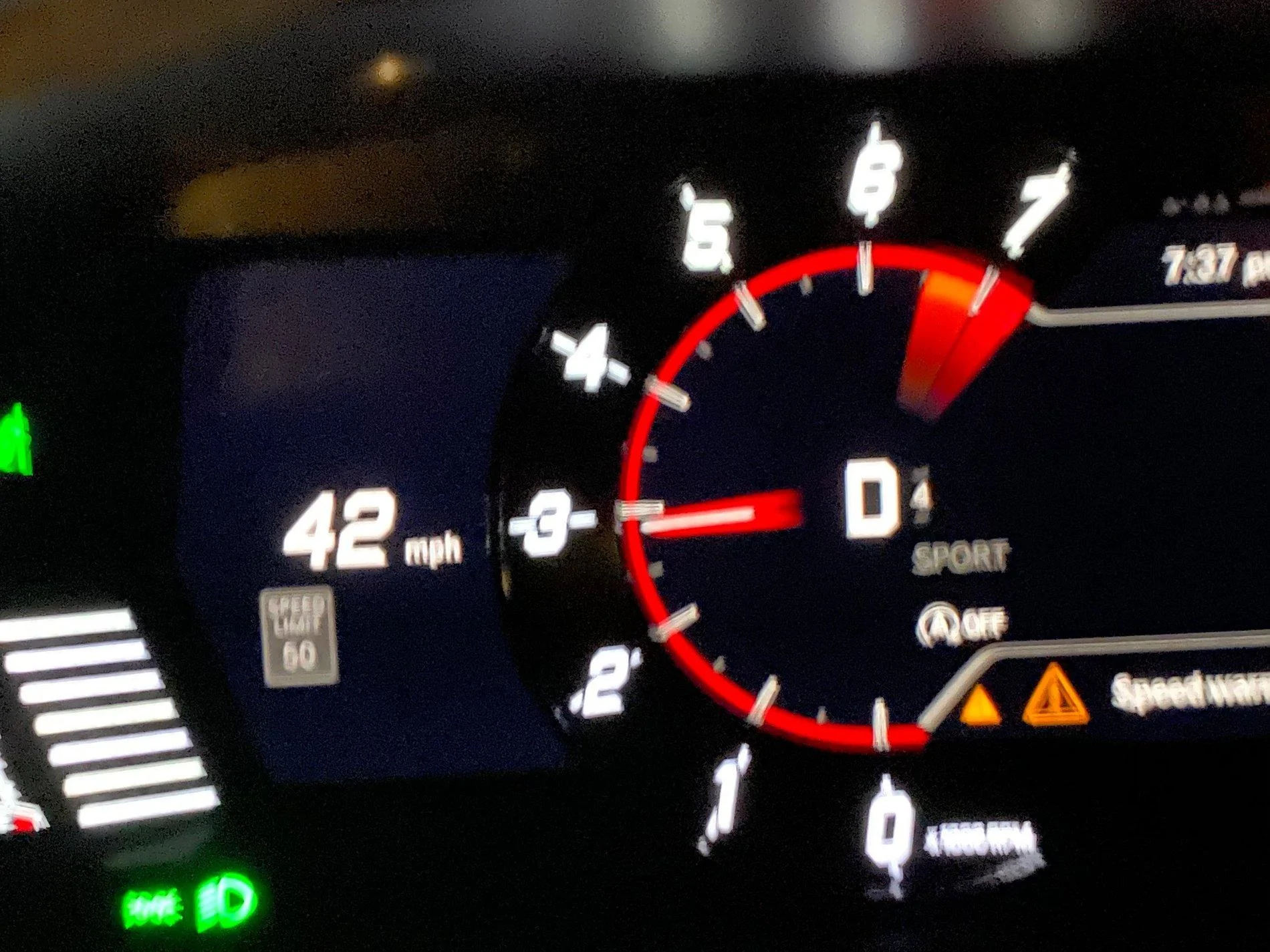

Who know what the little orange Triangle is?

I looked in the manual but can't figure it out. It comes on when I drive but goes off when I stop. Not the bigger one for speed but the little one next to it.

It looks like symbol for scheduled maintenance is approaching due...

Speed warning. I couldnt figure mine out for a while. I accidentally set it and it would come on anytime you go over the set speed which was annoying since mine was at like 5mph. You can take it off through the menu on the infotainment screen

That is the big one. I mean the little one to the left of the speed warning. :^)

Owner's manual says 'Maintenance or an inspection required by law is due soon.' for the orange triangle (the left one).
The right one is just the 'normal' vehicle message.

So did you figure it out?
As I mentioned earlier in this thread and it's also mentioned in the owners manual the smaller triangle indicates your getting close to upcoming scheduled maintenance...

No, contacted the dealer and they didn't know. They asked me to bring it in next week so their one specialist could look at it and try to figure it out. No scheduled maintenance is due, only a little over 600 miles on the Supra.

The small triangle was coming on because the car had been set to a max of 4mph and anything about that triggered the triangle (small one). So went to the dealer, they figured this out (their super tech that works on the Supra) in a couple of minutes, set it to 165 and all is good. Easy fix but they couldn't figure it out from the manual either.
