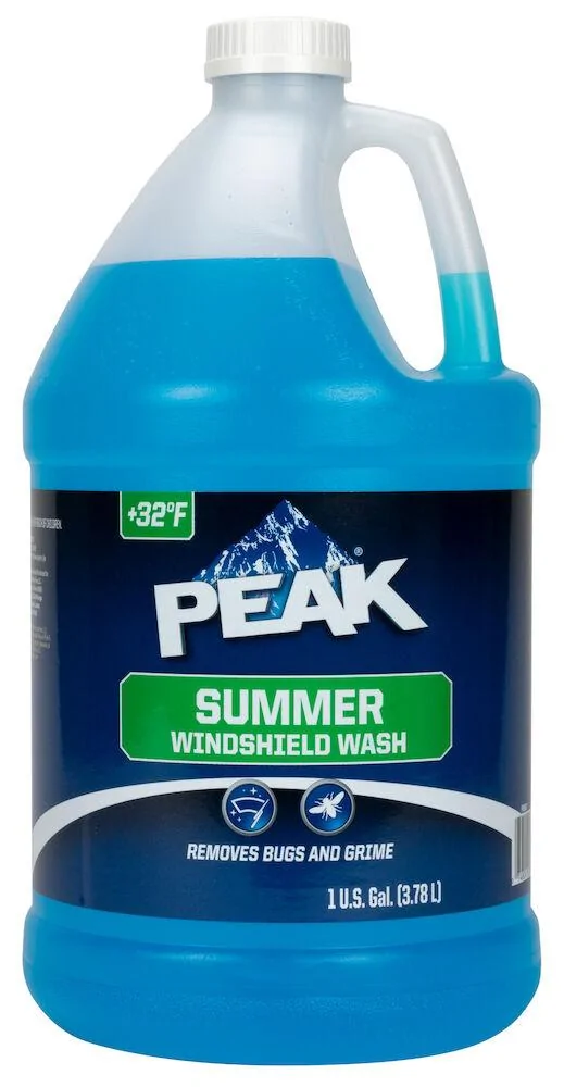

I typically don't pay attention, just grab this or something like it from the gas station shelf. I don't think it does?

Usually the summer/bug and such formulas have a silicone in them to aid in removing the bugs and such (think in terms of not sticking). Rain-x for example uses silicone for the water beading they market. Side note, Rain-x currently has a law suit against it for damaging/clogging pumps and claiming it works in all vehicle types. It doesnā€™t work long term in BMW systems or most German manufacturers.
Thinking you possibly just have a clogged filter since you mentioned that you can hear the whining of the pump working but only dribbles coming out. May not need the entire pump replaced. The reservoir and components couldā€™ve gummed up during the week of no fluid. Iā€™d stay away from any ā€œspecial formulas,ā€ for lack of a better term, of washer fluid to be safe. BMW does make a specific fluid, probably pricey, or you could make your own fluid with something like a waterless wash mixture.

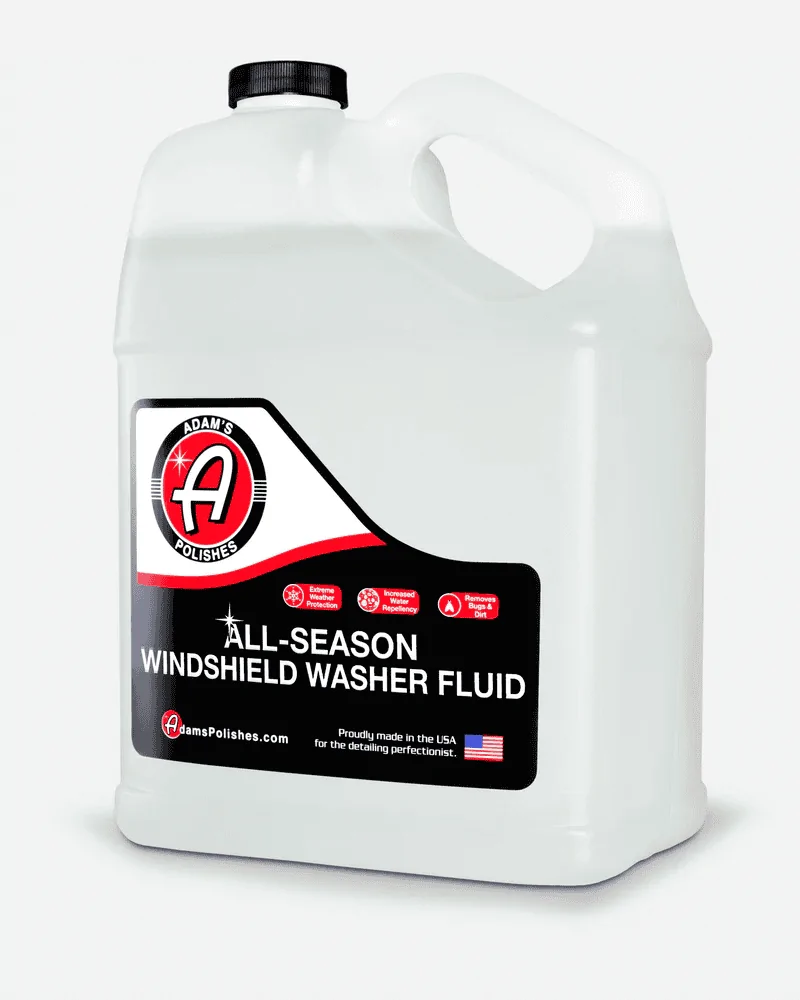

Turns out that the impeller connected to the pump broke into pieces which subsequently went into the hose causing a partial clog. My guess is that the high temps down here in FL combined with the reservoir being empty for a week or so made the plastic brittle and prone to breaking. Probably nothing to do with cheap washer fluid but I'll try out that Adams stuff.
