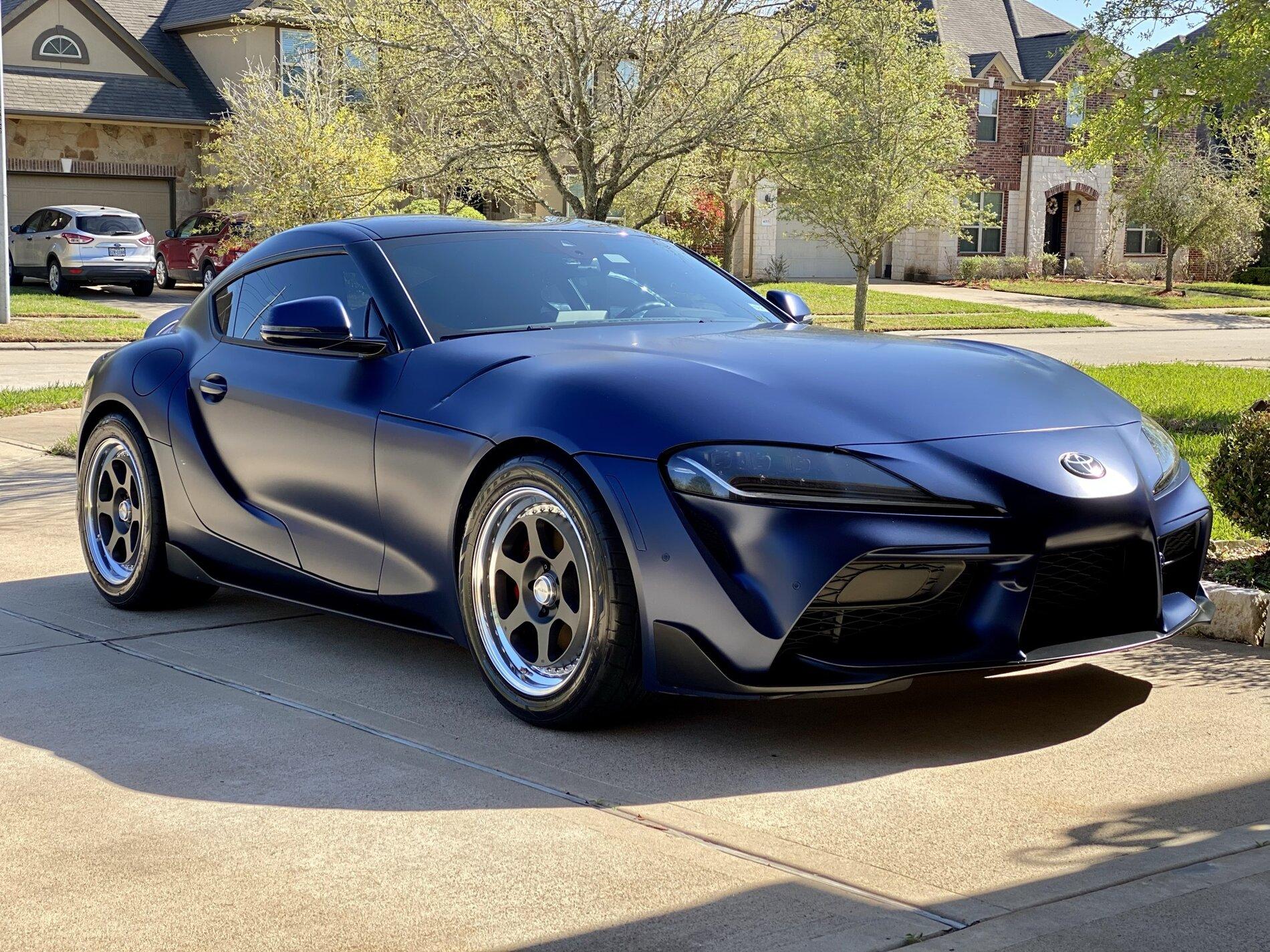

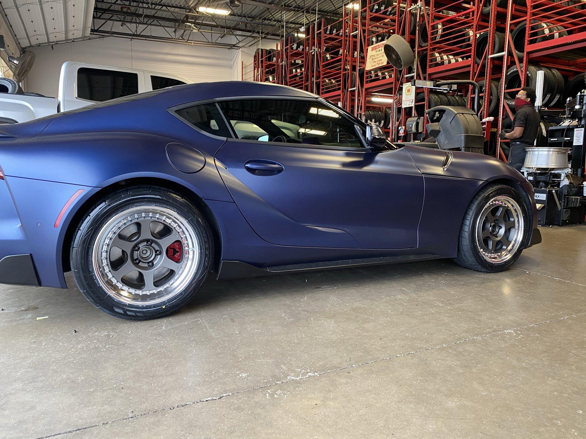

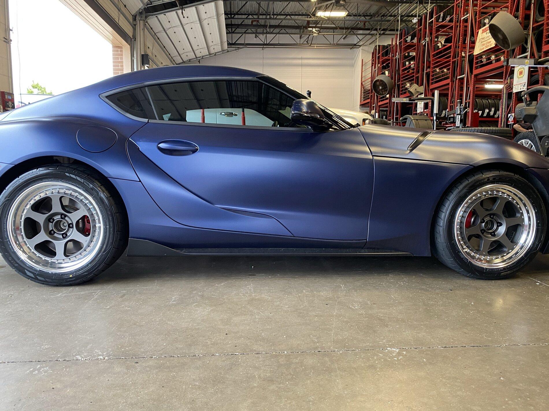

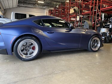

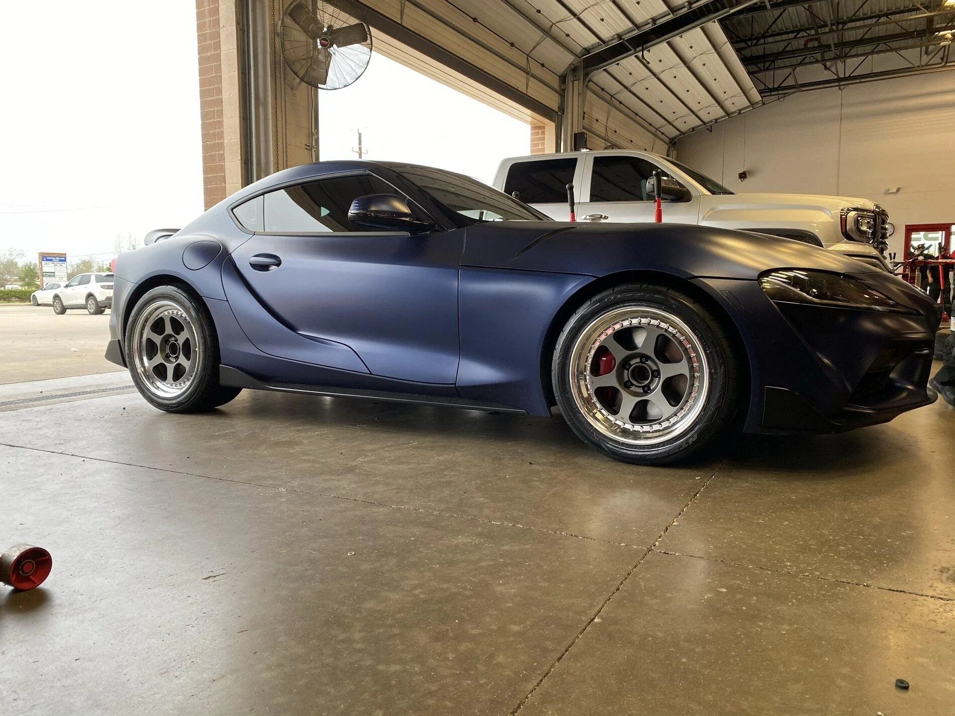

I got some pics posted on the forum. But I will add them here too so you can see what they look like without a drop. I didn’t drop on purpose because I wanted to know how much room I had left.
