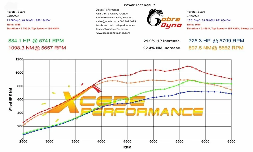

Thought I'd start something as it's been exciting times for me...
Own the car for about a year now.
Started with the basic Ecutek tune, dp, intake and e40 tune. Just shy of 500whp.
My stock turbo then decided to blow the seals, and that sparked the new build.
So off the car went for a transformation.

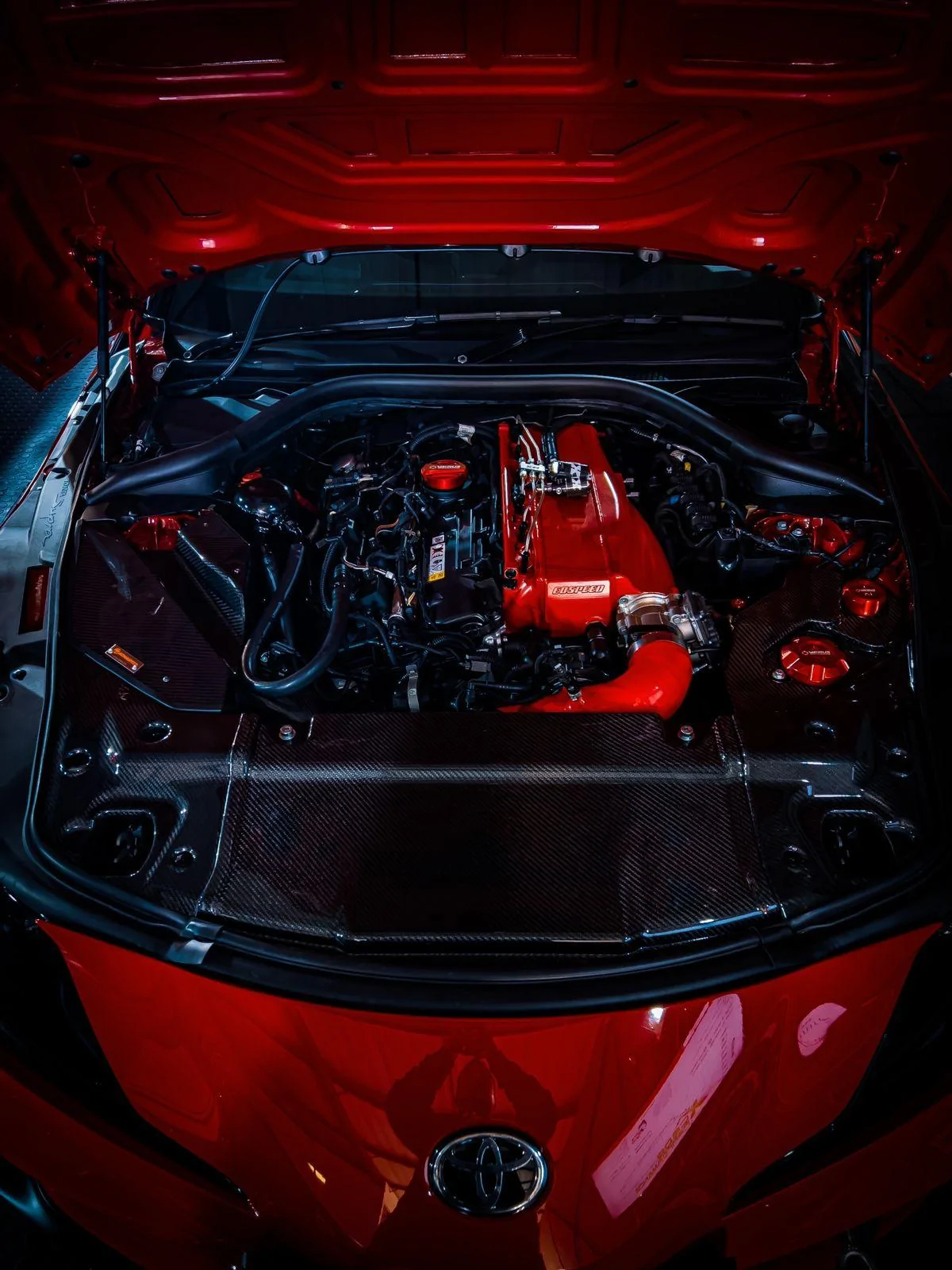

2 port stock engine
Locally built ball bearing hybrid turbo
EOS manifold
Port injection with ID1050
Visconti fuel pump and reflex
Direct port meth injection
Direct port Titan nitrous kit
Titan axles
Titan loop
Locally built trans by Budler Motorsport who own the fastest BMW in the world.
884whp
