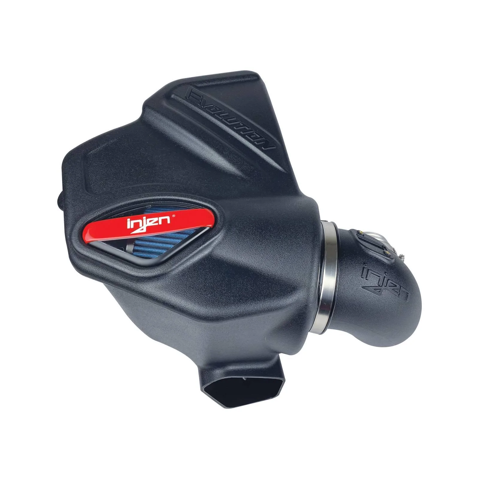

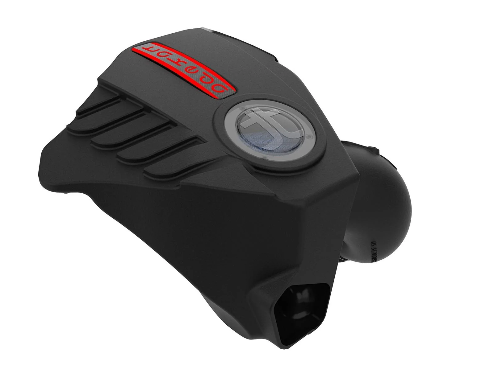

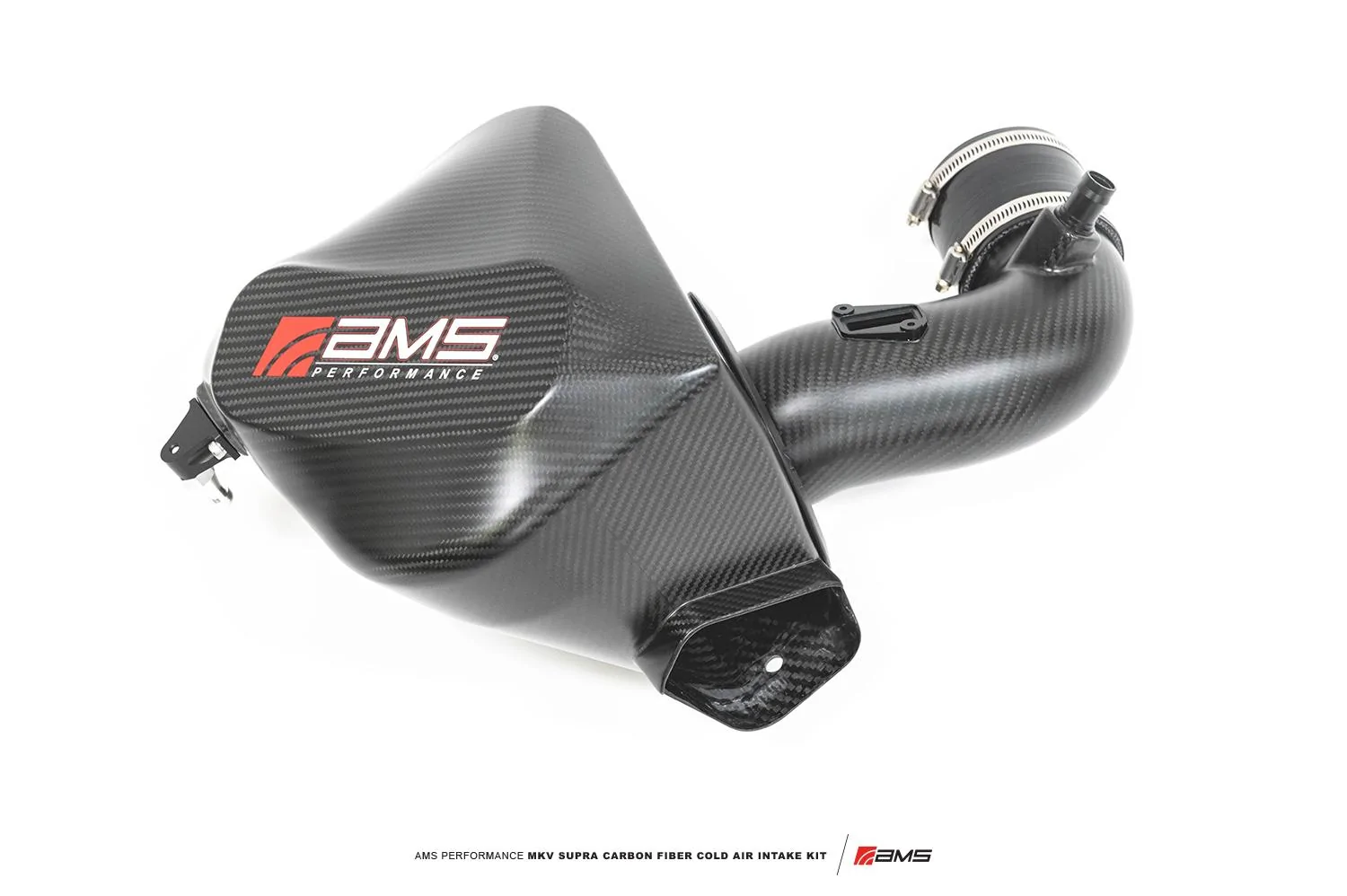

Any examples of these? So far I'm hearing the eventuri one
I have the Injen EVO 2300, but the AFE Takeda and AMS are also the same basic design.

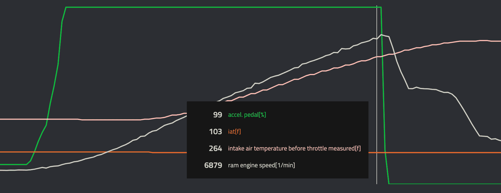

@razorlab @zrk This is a pull I did for Jesse, I'm probably just reading it wrong, IDK...
A 20-120 mph pull with the stock intake manifold will heat the IATs up WAY more than 8 F. Unless maybe this is the pre-turbo intake temp? I've never logged that so I'm not sure what its behavior is.
Bryan / Briana
4,682
9,330
Your moms bedsheets
Pre-manifold intake charge temps are easily 200F+ on a single gear pull. This is the delta I keep talking about. ;)

Pre-turbo intake charge temps are easily 200F+ on a single gear pull. This is the delta I keep talking about. ;)
Unless I'm mistaken, that's post-turbo, pre-intercooler. Mine hits nearly 400F there, I can't imagine the pre-turbo intake temps being anywhere near that high unless driving through an active volcano.
Bryan / Briana
4,682
9,330
Your moms bedsheets
Yea on track I have seen 350-390F. We don't have a temp sensor pre-turbo, unfortunately.
