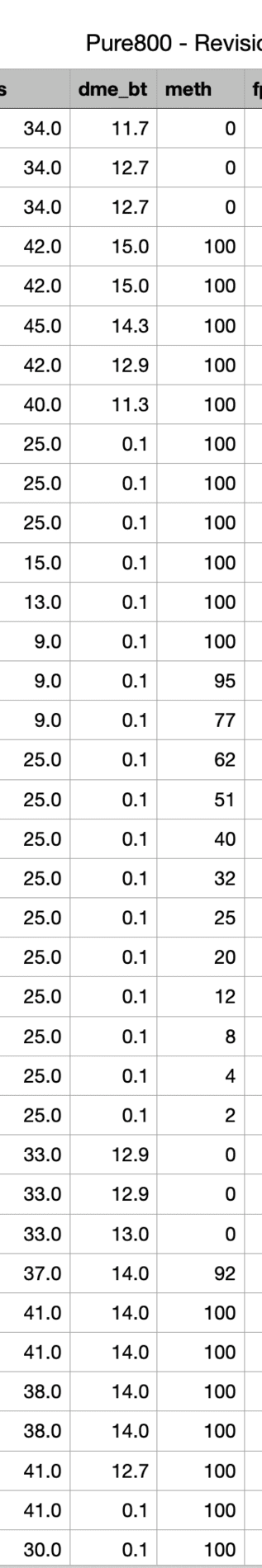

The dme requests varying amounts of boost depends on a whole billion different things. Here's a sample from a log I took recently. DME_BT is DME Boost Target. The amount of boost the DME is requesting.
Ok cool thank you, I’m trying to figure out if my
Jb4 is adding the correct boost or if I’m overboosting or what

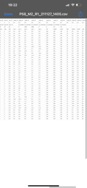

Latest log on map 2, shows a boost level peak of 22psi and an ecu psi of 18-19psi

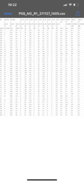

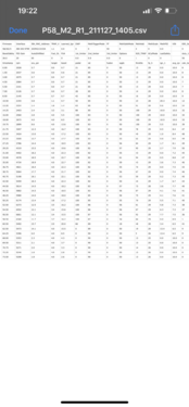

93 octane yea sir and it’s at 15.6 right around 6500rpm I attached the log so you can see it If you have time.

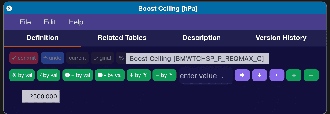

Wouldn’t there still be a “maximum” boost level that the DME allows before stopping more from being produced? Otherwise the car would just produce as much boost as possible for the requested load and added conditions like ambient temps, fuel type etc

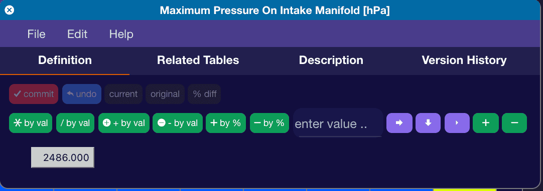

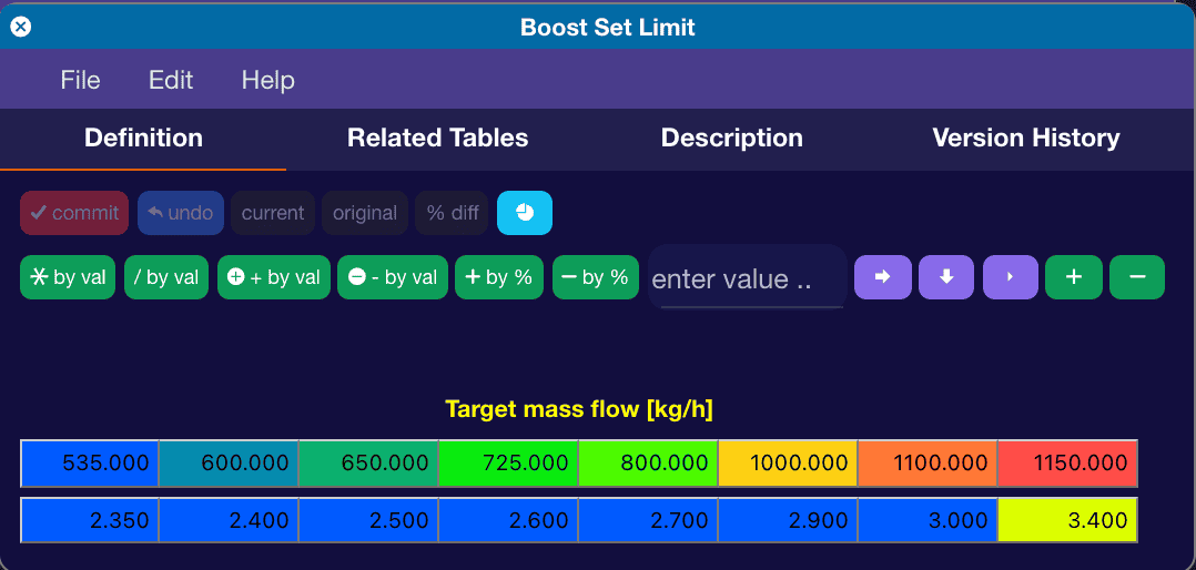

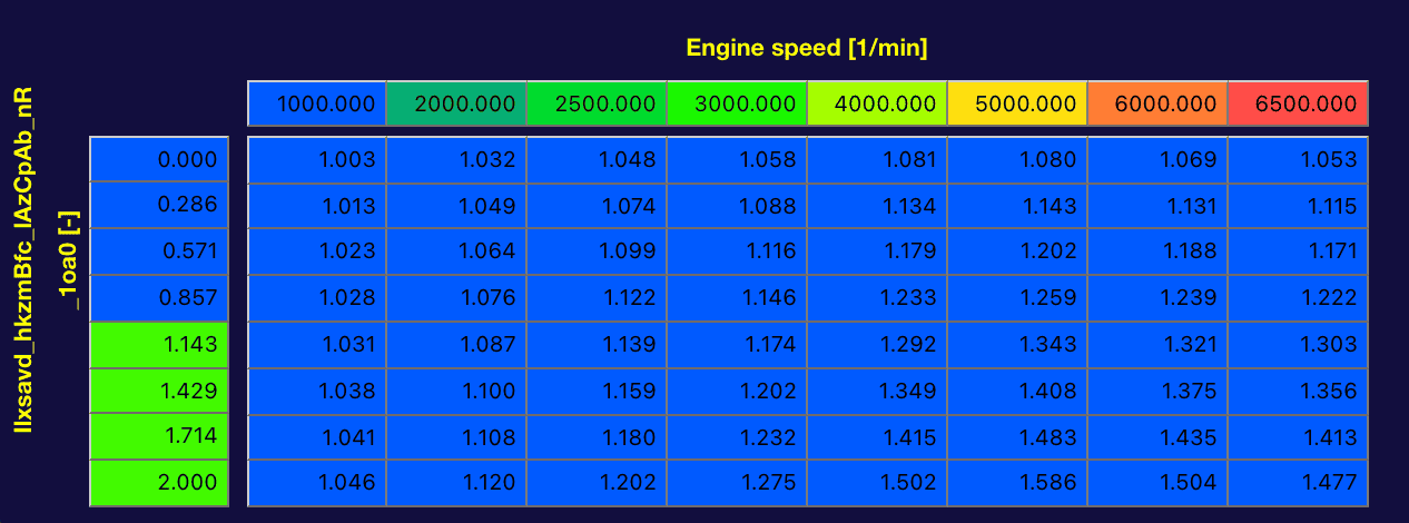

Yes, there is. Most modern ECUs are torque/load based but they still have min/maximum ceilings for boost as well.
Here are a few of those types of tables:
the minimum / maximum target is provided by the load, we measure it by PSI but that's not how it's programmed in the ECU.
As you see in the tables provided the values are all load based
In comparison to a JB4 where the value is provided by PSI
