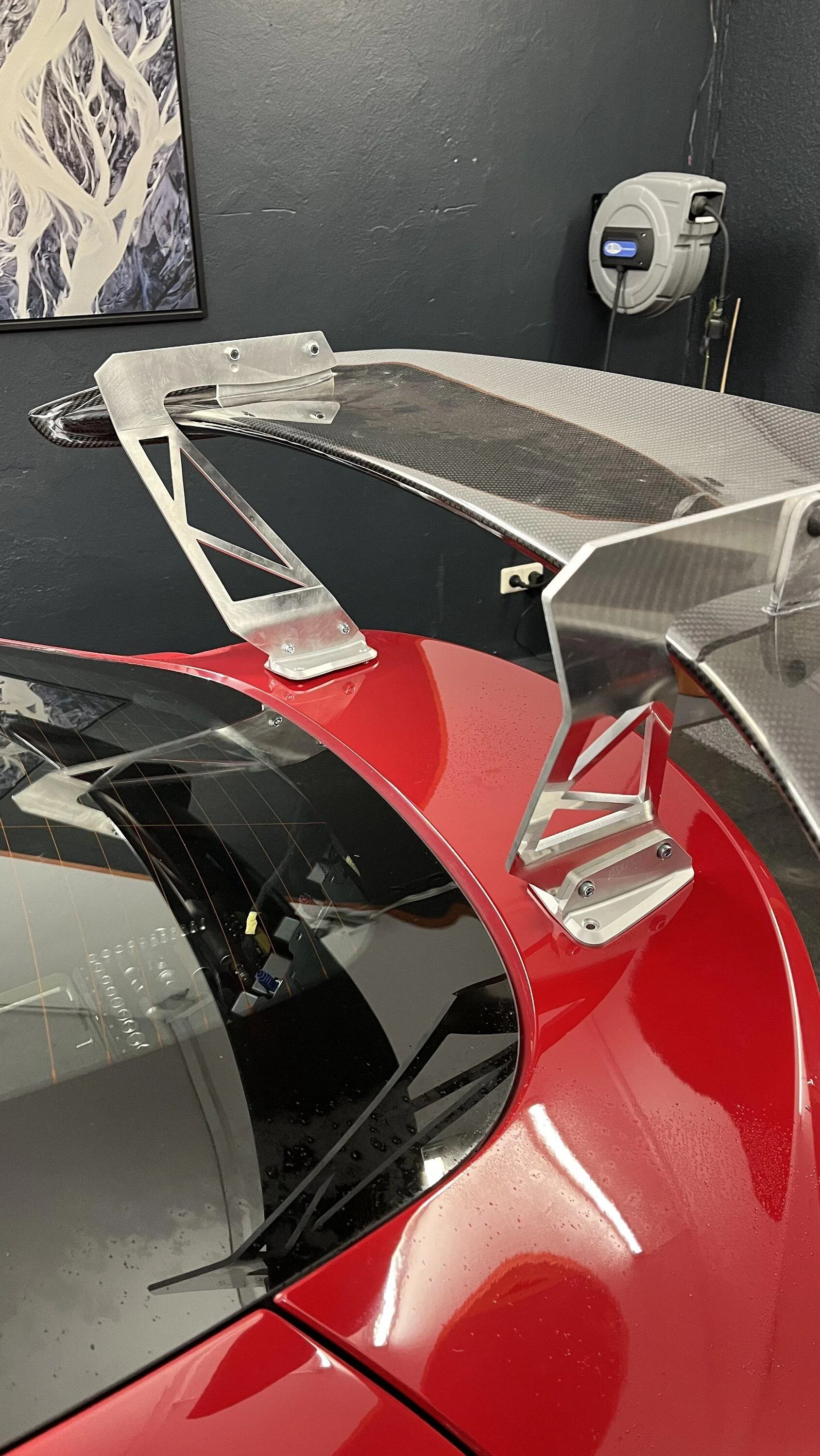

Are future modifications planned? - For sure! Right now im designing a hanging wing for Akiko, like the new GT3 RS has.

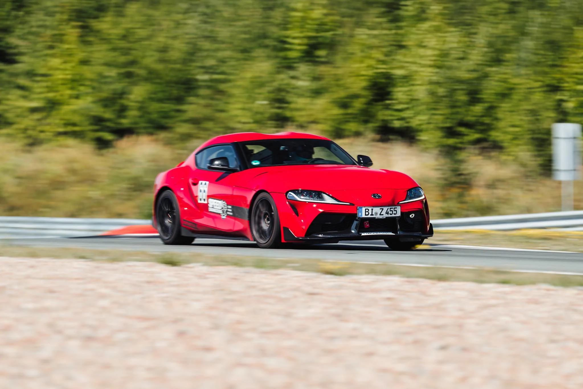

To slowly come to the end of my first posting in my track-supra thread, here's a track-picture! :
Location: Bilster Berg, Germany

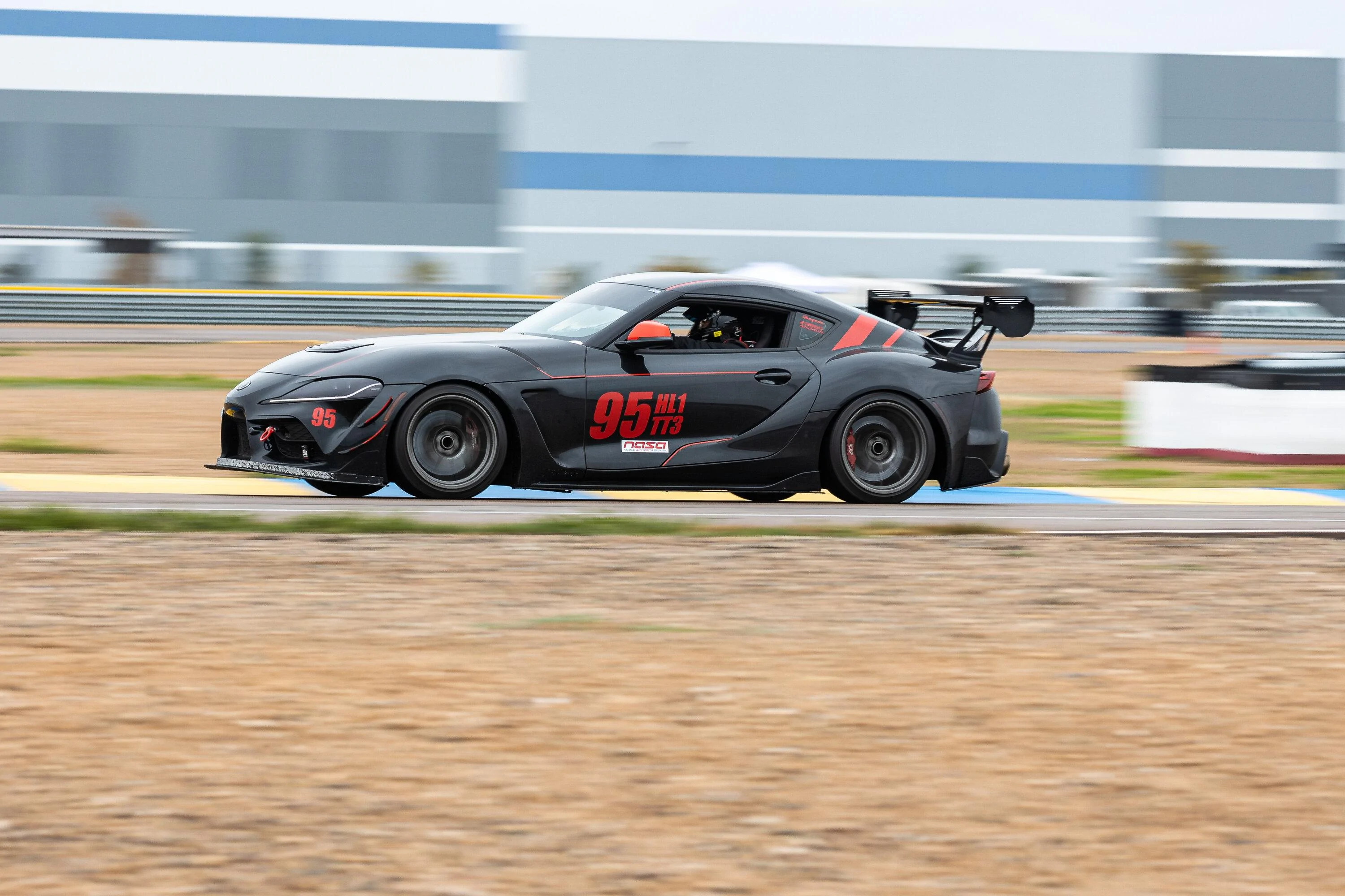

Nice to see another track addict. I have done a lot to mine and have 64 track days on the car. I also instruct for NASA and PCA in the US Arizona region. Happy to connect and share my experience with the car.

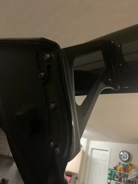

Your car is gorgeous, Tod. Great design. Since I saw your installed wing, i'm even more excited about my wing. Do you feel a difference? Can you describe that? :) This is the prototype I'm actually developing:

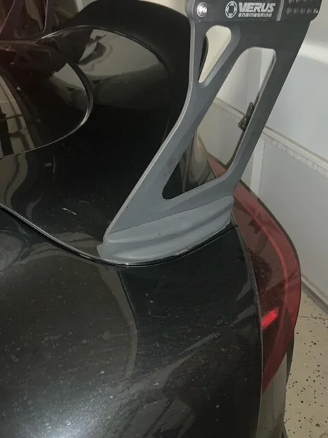

that is a lot of wing on top of a plastic trunk. needs some serious support and the downforce needs to be transferred to the chassis

Ok I see you are all in - as it looks like you have fuel cell ( looking through the window in your pick) So you are on your way to a full race one which is great. So on the wing. This one is from Verus Engineering - and I made a bigger custom end plate. It works really well. You really feel it at the end of the straights at around 100mph so it does affect the HP pulling which makes sense, you kind of run out of steam as the acceleration rate drops off. Having said that - we did a test to see if was faster with or without on a track that I had very consistent lap times and it made about 2 sec difference, even though you are getting more drag on the straights. And even at 50 to 70 MPH corners it really helps keep the rear end planted. So this with a splitter and, drive planes etc and it is supper planted. So not sure if yours is bigger you may just want to make sure it is not too big to pull to much HP down the straights that would impact lap times. Otherwise then you need more Power to support your big wing(lol) Going down that rabbit hole!

Sorry one more thing on the wing. As it helps plant the car it makes a slower tire faster as it gives you more grip! So you can use cheaper tires and still get pretty good times. I have not went to purple crack yet and got a set of Hoosier R7 but it is tempting. Estimate moving up to that level tire the you can pick up 2-3 sec - Speed costs how fast do want to go ( lol) but then you are running full on race car times and I think at that point probably need the cage.....

@Rocksandblues Yes, you're right. But the bonnet will be supported in the trunk. That should work. Background: german regulations. Everything of the spoiler needs to be covered if you stand in front of the car, watching in a 90 degrees angle onto the car. Everything. - So unfortunately i have no option... The wing itself is not the biggest too, but it's the maximum you can mount without moving yourself instant to jail here. :bump: (Of course that's an exxageration, but the limitations are not.)

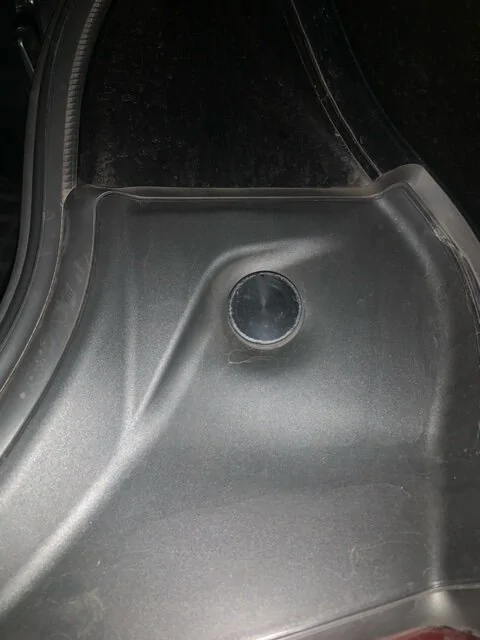

ok now that I know bit more will add to the comments about the supports as the trunk is plastic. If you see how this one was done the uprights are rights on the outside edge so it is on rim of the body, with a metal plate underneath. Also they replaced the rubber foot that is the level stops with a bolt and aluminum foot as that is where the trunk stop rests on. So I am not sure those middle mounts will be strong enough. Other wise you need to sort out how to built a bracket/ support underneath. Mine said it was 500 pounds of downforce?
One last small point, Also the weight of the wing will be too much for the standard trunk struts/ supports. I just measured and found some on line I think the were at 80 pounds each, which I thought was too high but when you look at it, it is a lot of weight once it is open and fully extended. Hope this helps, nice job engineering it!

@Todday1 Thanks! You're absolutely right. I already have a support for the trunk in construction. I did a few calculations. The Wing-Profile is the same of the GT3-RS, but cutted down to a new width. I'll write something more in a few days, but it shouldn't exceed 270-290 pounds in downforce. But that could meet your specification very well. My wing is a lot smaller than your's, so less downforce.👍 80 pounds for the wing? - Should be less, like you mentioned yourself, even if the wing is big. I didn't weigh my wing, but it should be around 25 pounds max. .

I was referring to the weight rating on the strut shock. I think each has to be stronger to lift the whole trunk and wing. So will have to get them stronger than what ever they are stock. So is lifting the total weight of the trunk and wing
