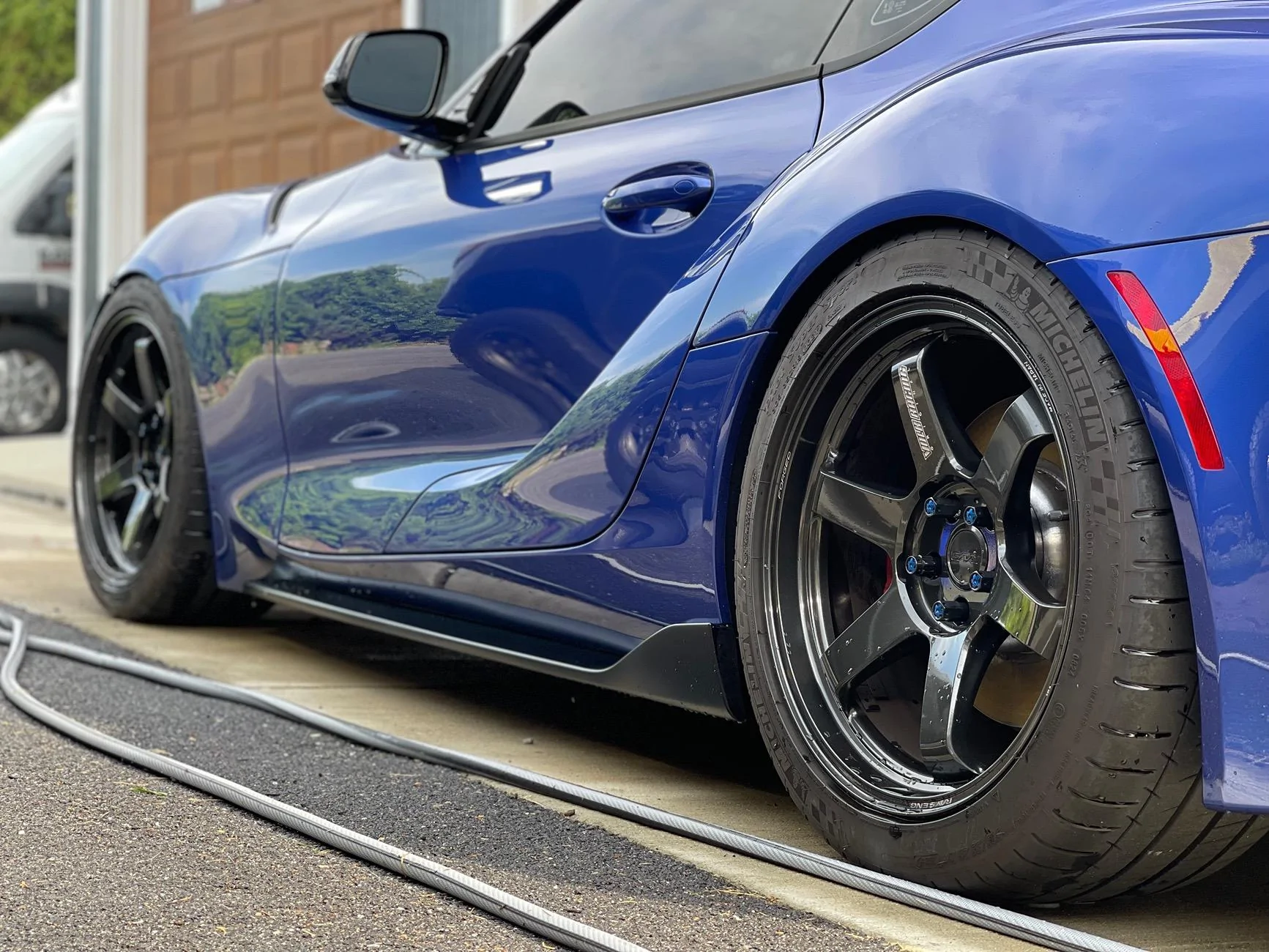

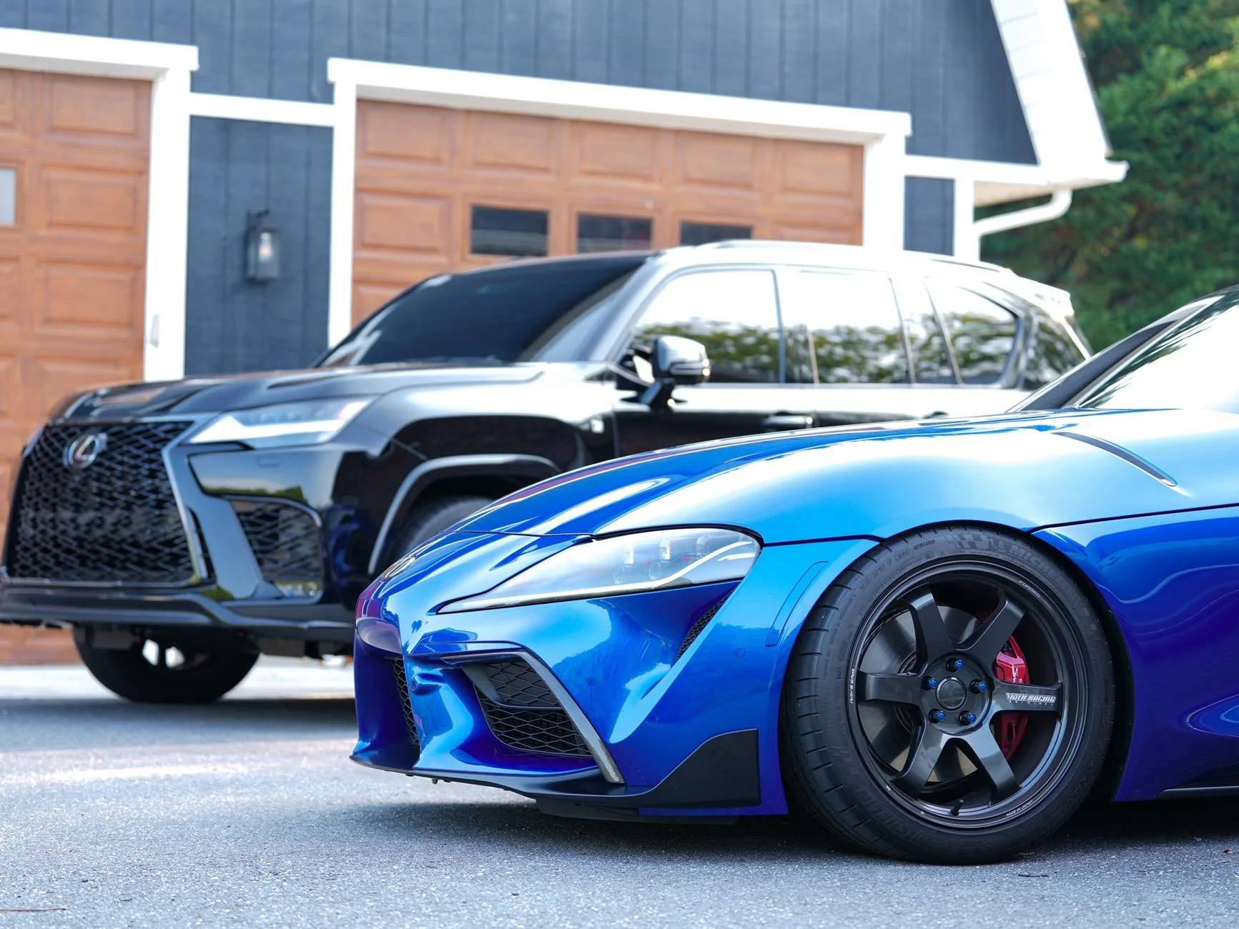

265/35&295/35. I’m lowered on Whiteline and it’s a perfect size. Maybe you could squeeze a 305/35? Maybe not. 295/30 looks too small in my opinion.

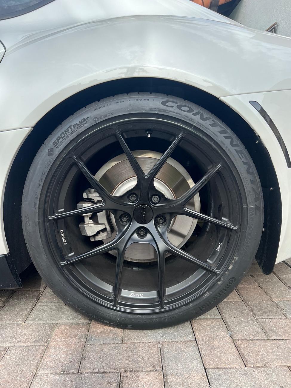

The 19 inch wheel is an odd size and there is not a lot of variety when it comes to tires.
Both sizes you suggested are good options.
Just be sure that understand that in the rear, the 295/35 will have more side wall than the 305/30.

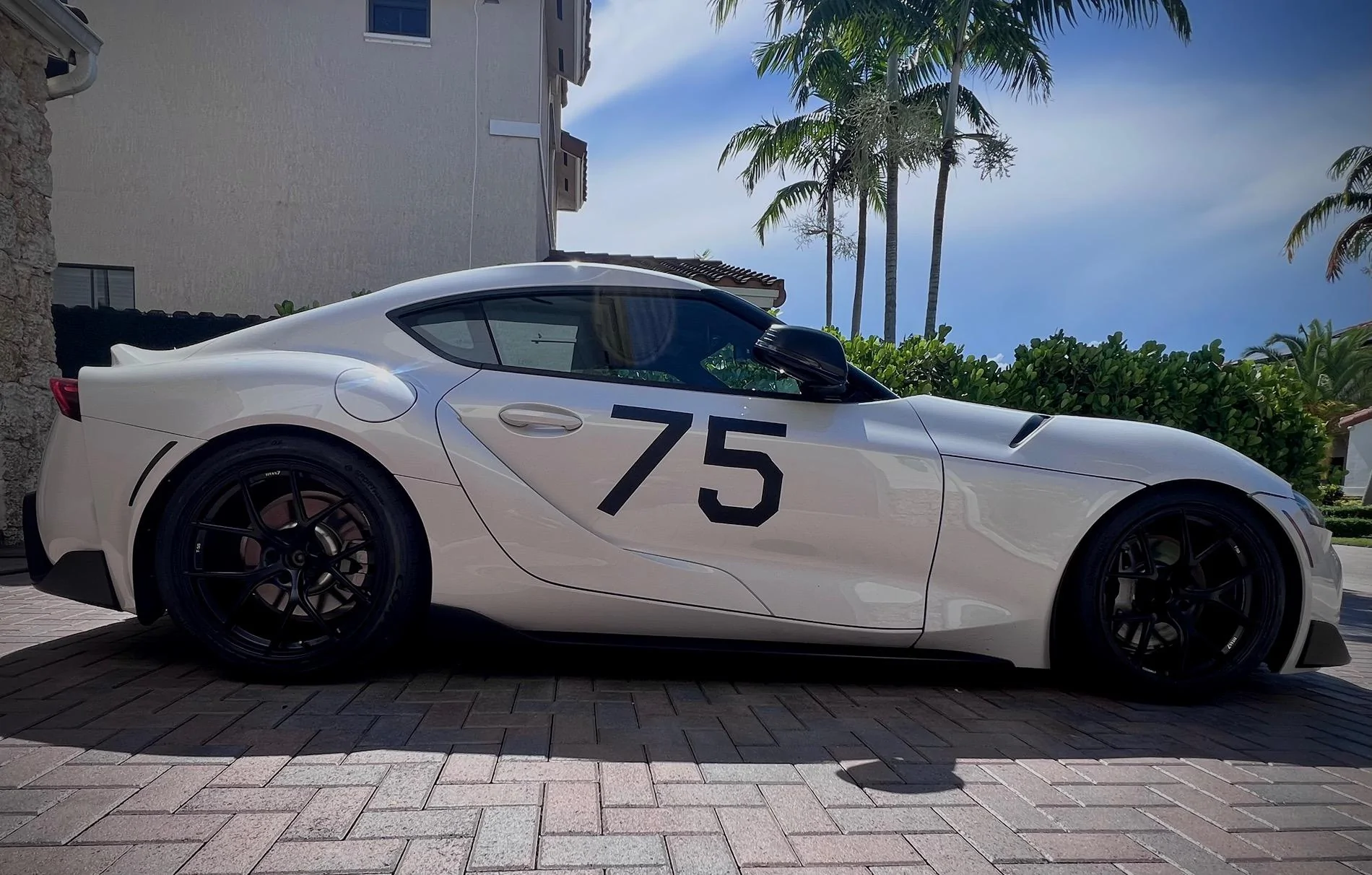

I went with Continentals 275/35 and 305/30 on MSS adjustable lowering springs at the lowest height and I truly love it.

Forgot to mention that I get flush tires to the car without spacers. That was my main motivation. Avoid spacers.

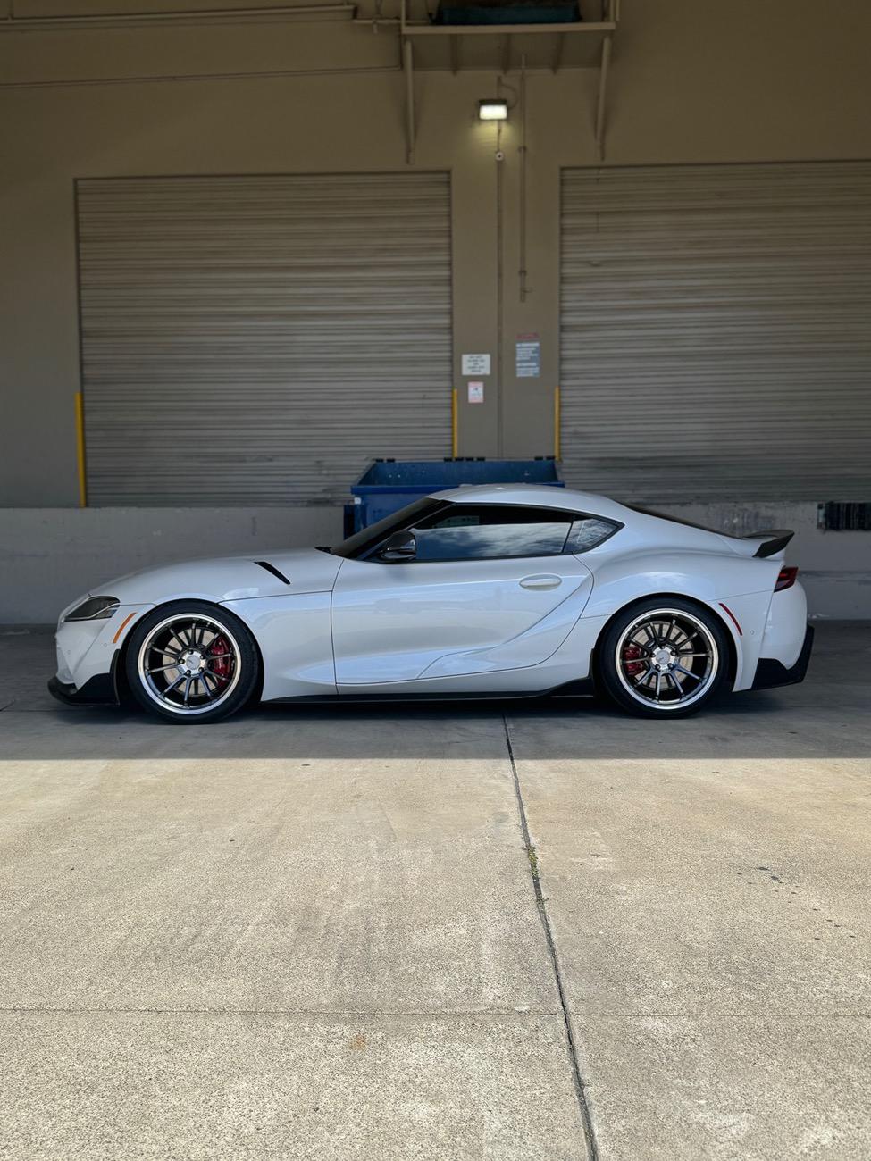

sup.dc2
JJ
Aug 7, 2023
195
293
Fontana, CA
Mk5mt. DC2. T4R.

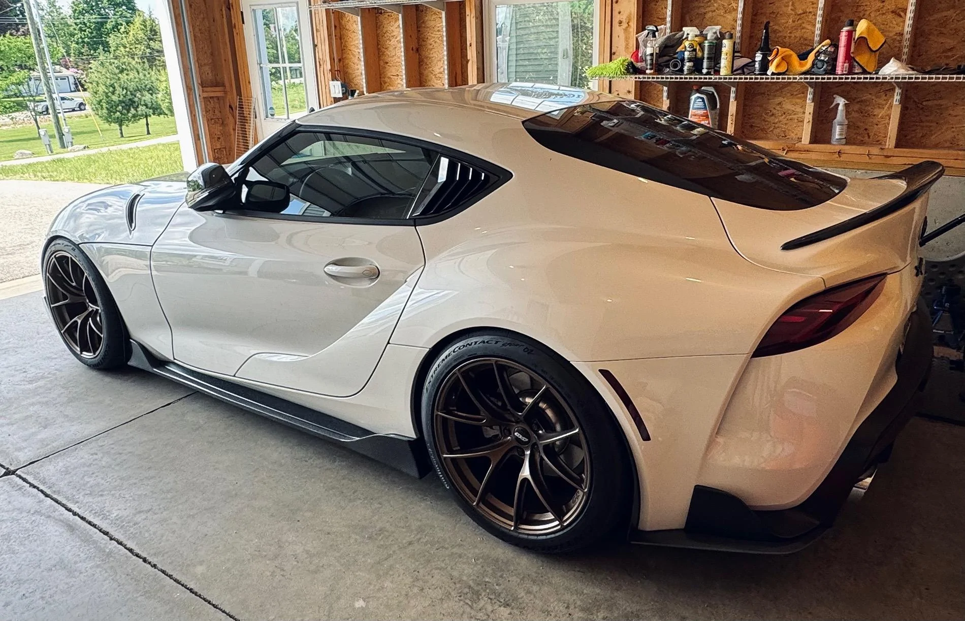

275/35/19
295/30/19
I dont have any better pictures lol

275/35/19
295/30/19
Looks good but rear tires do look on the small side. If I go 295 I’ll definitely do a 35 sidewall. Thanks!
