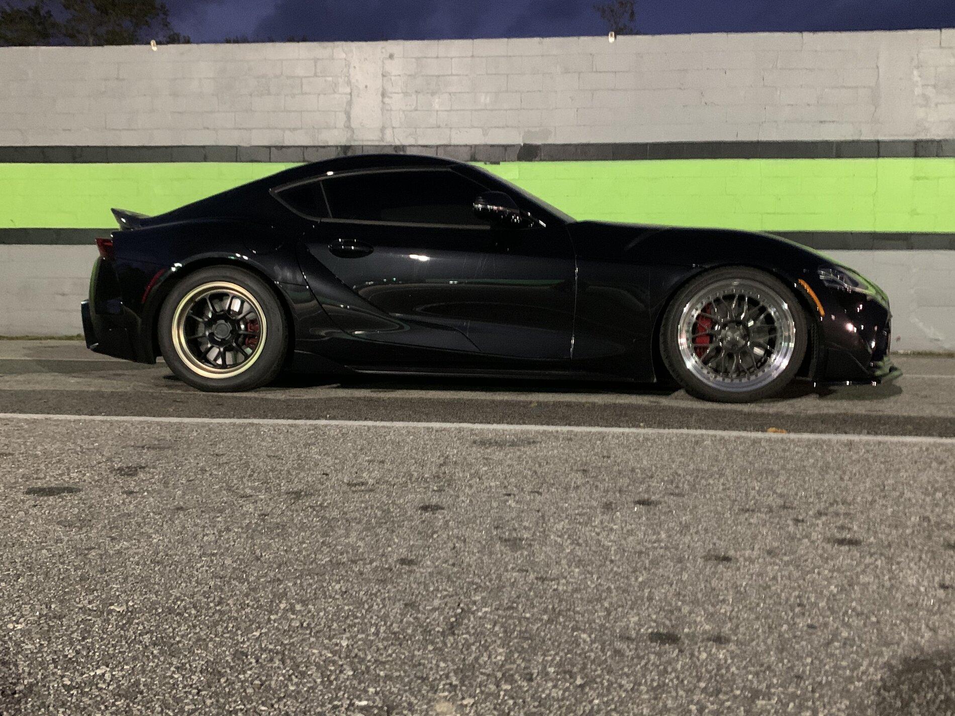

Thats correct. If i was gonna do drag radials im gonna just get 2 for the rear and do the standard 2 different wheel set up ;)
quite a few of the local mkv guys run the Mickey Thompson street S/S or Nitto 555R2 drag radials in 19”. Their 60ft times wasn’t that much slower than mine on a Hoosier DR and their tires are streetable.
Well unless it rains ?
