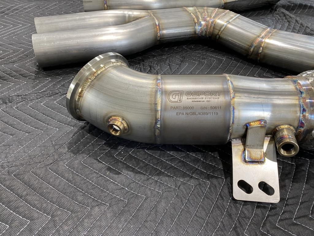

I ordered the full ETS 4" turbo back last week for my 21'. Catted Downpipe, Resonators and Mufflers (goal is increased performance with good sound, but not obnoxious loud, and no CEL). I reached out to ETS regarding the Cat they are using and they replied back saying they have switched to the Gen2 G-Sport like I have seen other manufactures doing (they're intended for 2017+, although it actually just came out last year from what I've read) . So hopefully better chance of it behaving and no CEL...

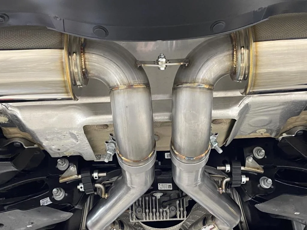

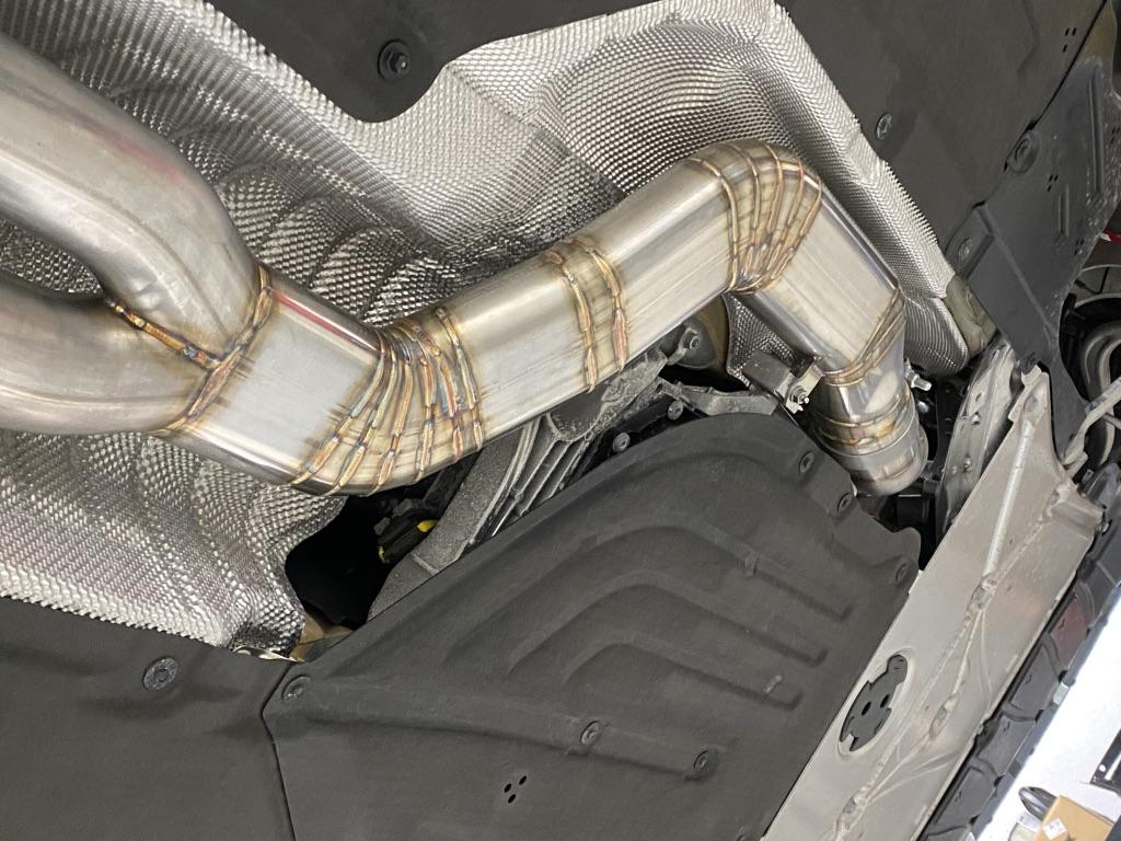

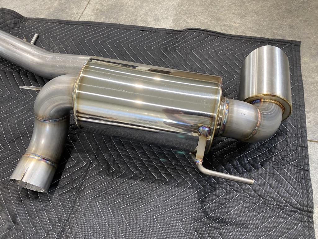

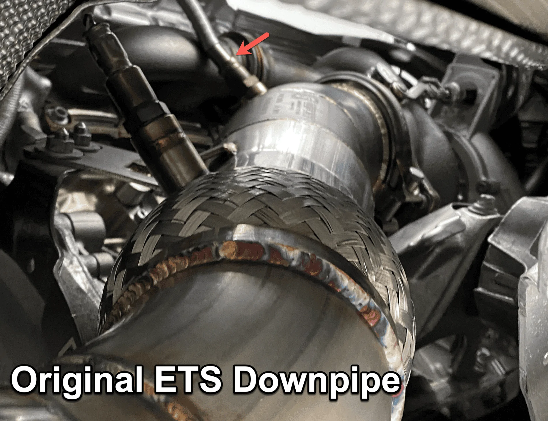

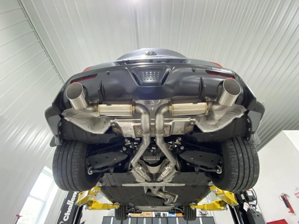

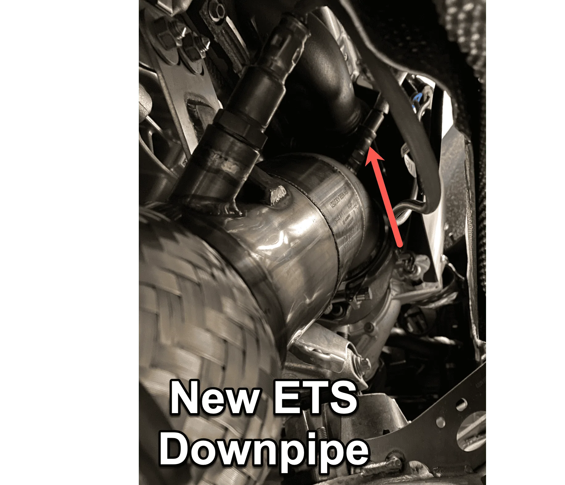

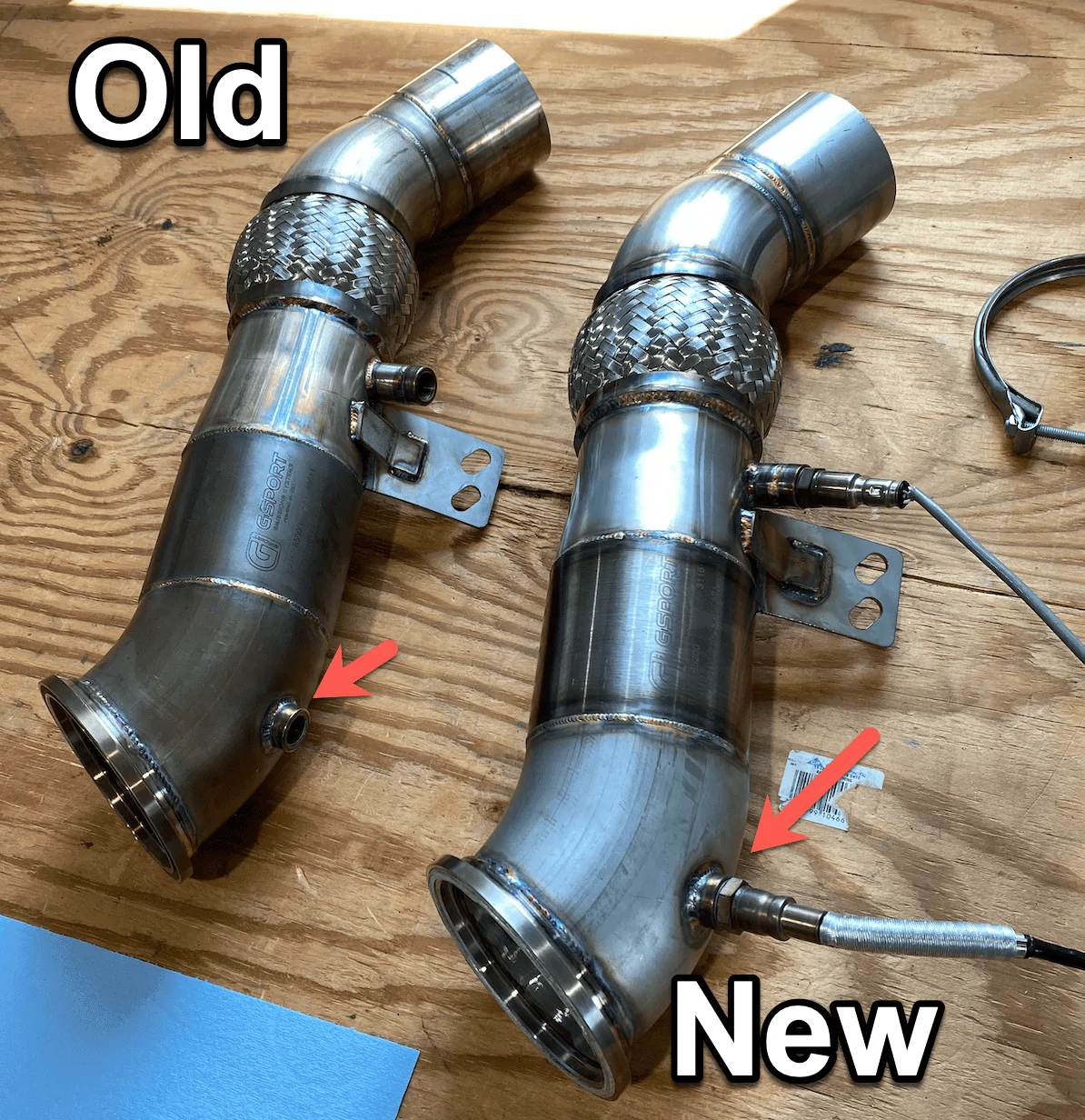

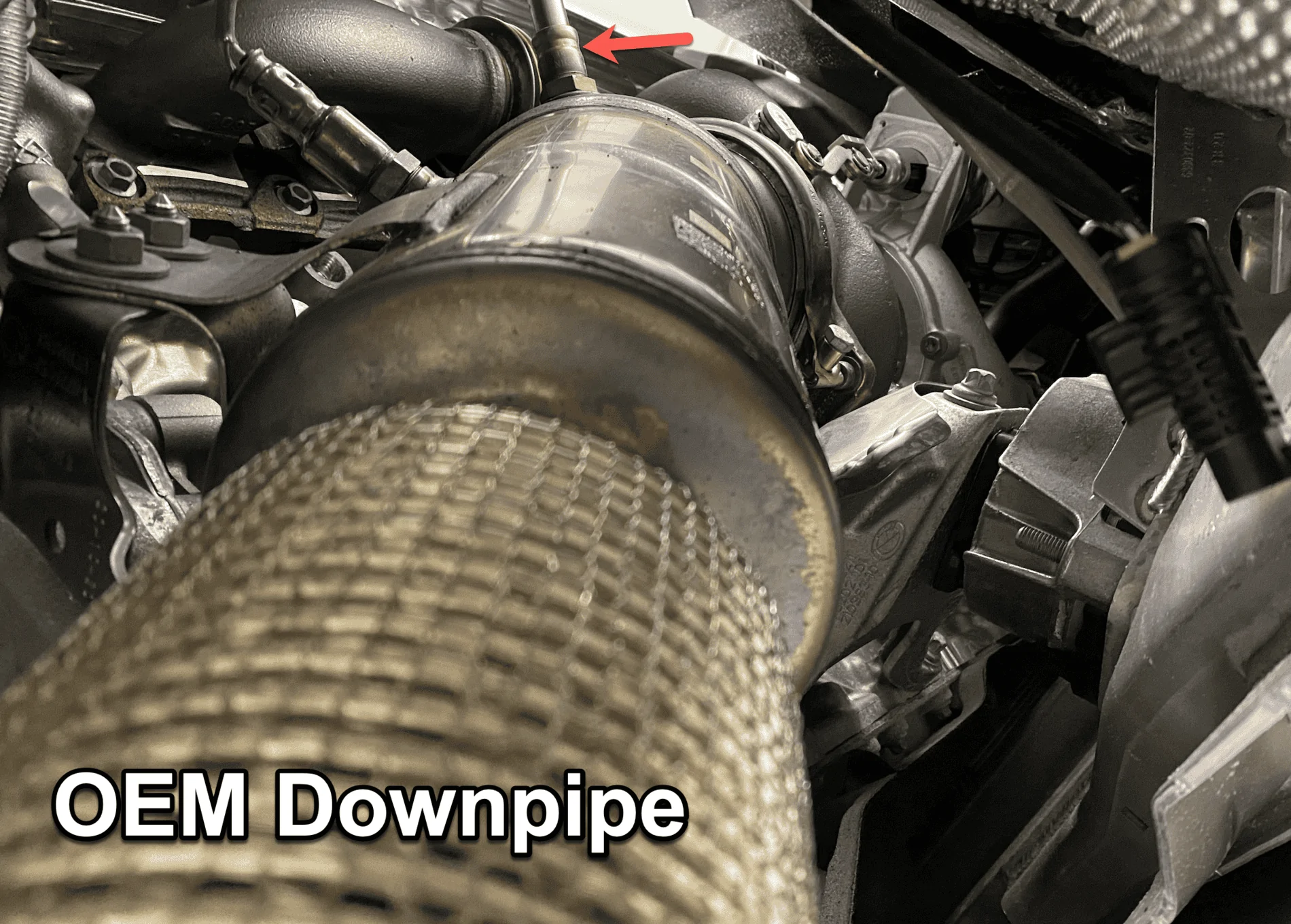

UPDATE-1: I emailed ETS to provide feedback (I had no expectation of them doing anything for me since I made the decision to install the downpipe as is / I already drove around a little bit, and I did make them aware of this). Chris at ETS reach back out to me right away with an apology for the mishap, a return shipping label, and a commitment to start immediately making a new downpipe with the Gen2 Cat I asked for and they are adjusting their jig to further offset the O2 sensor to fit correctly with the 21' 6 port manifold. They are also working with me to get the new one out before I send the old one back due to limited access to the lift I used / save me the pain of having to swap back to the stock exhaust to get the car home (I can't use the stock downpipe because of the 4" exhaust, although I was curious what it would have sounded like with just the stock downpipe and no exhaust:headbang:) . I'll keep you guys posted on how this unfolds, but so far pretty happy they are definitely going above and beyond.
UPDATE-2: I received the new downpipe from ETS (corrected to the Gen2 GESI cat, and adjusted O2 bung). I got this swapped out this past weekend. Install/re-install was a little bit of a pain but I got through it. The new downpipe fits as expected this time. There is plenty of clearance on the upper O2 sensor now. I will make another post with comparison pictures of this.

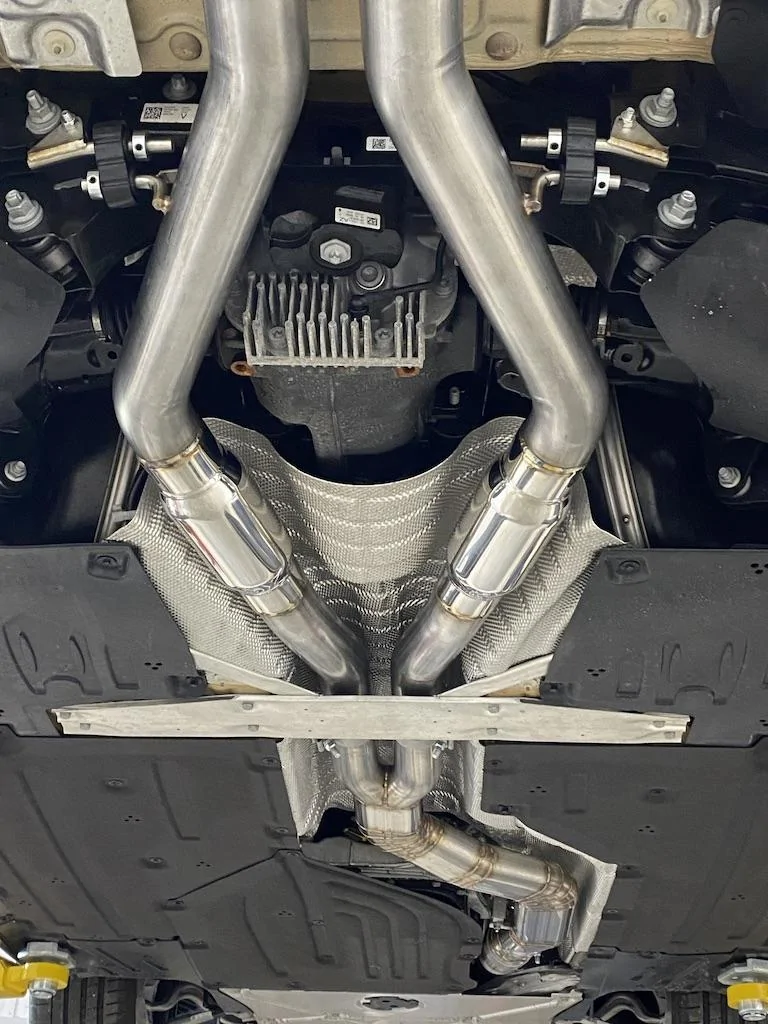

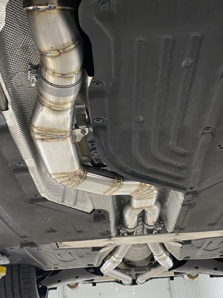

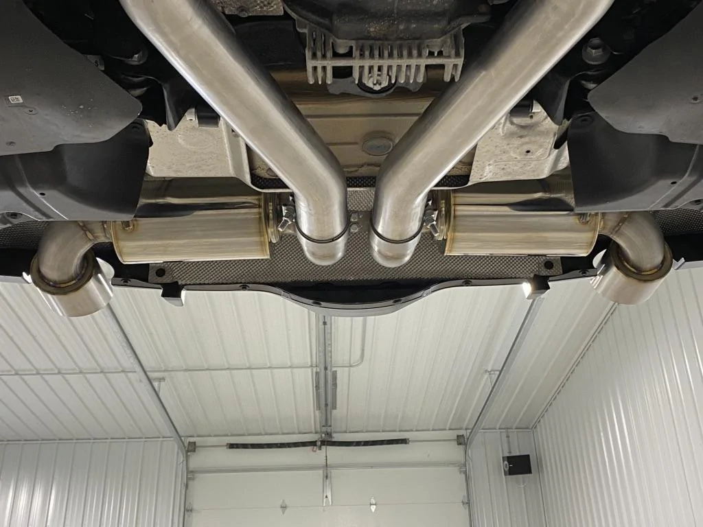

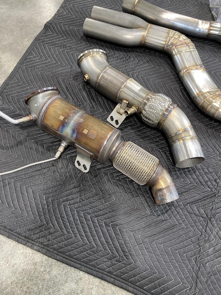

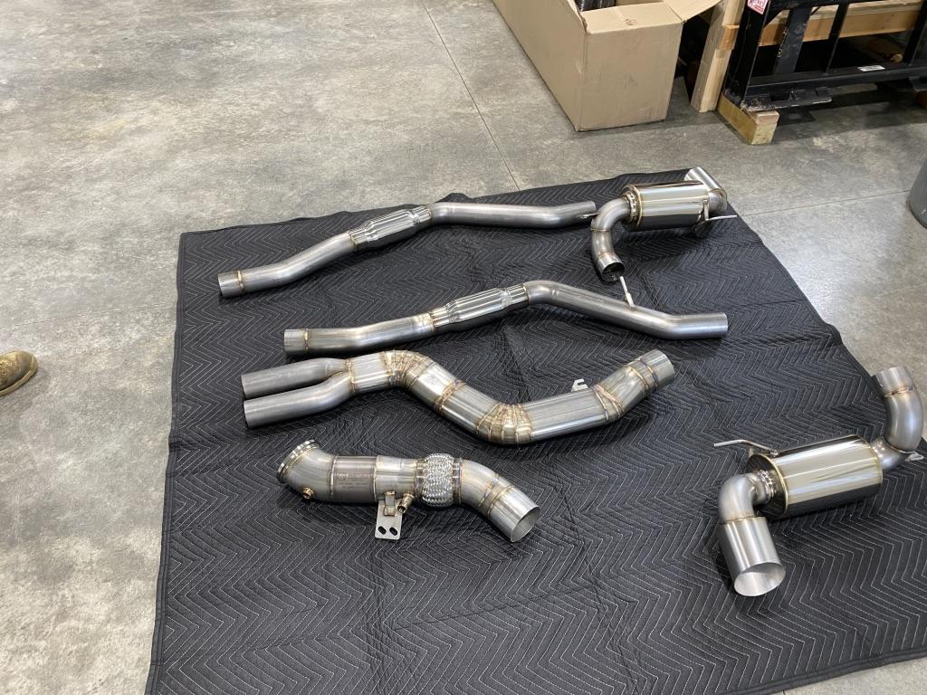

Got this all installed yesterday. I took lots of pics and a couple videos (quality may be questionable, sorry I'm not a audio/video pro ;)).
Product Impressions:
Packaging was great, shipped all the way from Washington state to Ohio no issues. Their metal and welding skills look top notch, no complaints there. I ended up with the Gen1 Cat on the downpipe (was expecting the Gen 2). I shared my disappointment on this with ETS via email, but I'm inpatient so Gen1 got installed. From what I have read I don't think I'll have issues. I put a little over 50 miles on it so far, no CEL. Fingers crossed...
Install Impressions:

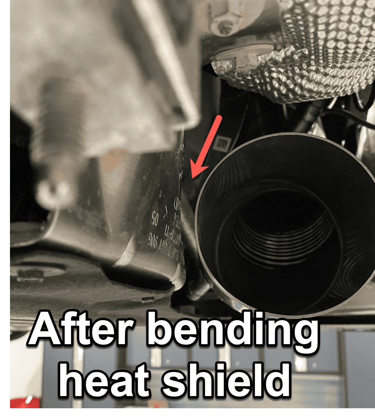

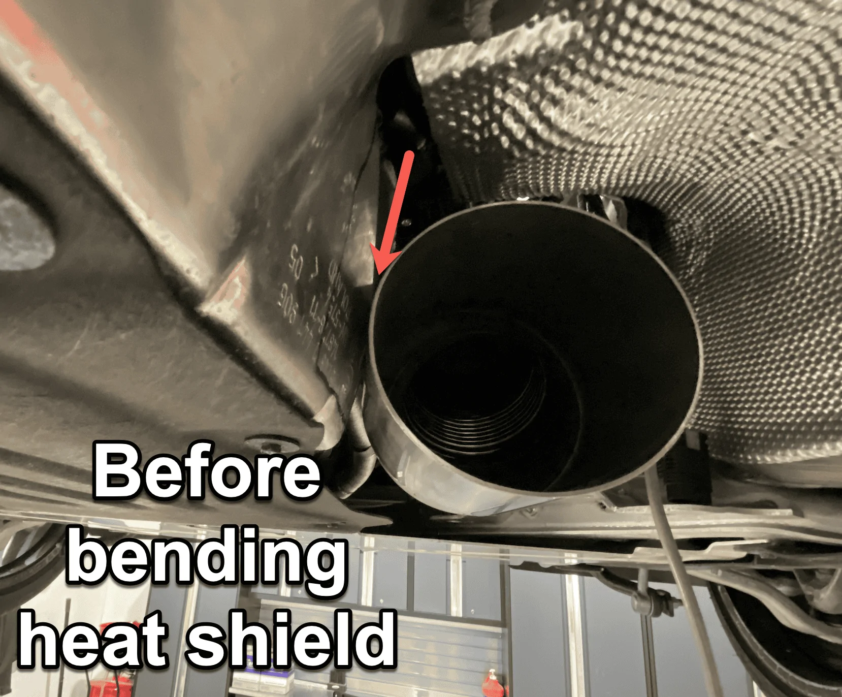

Install went OK with a small tweak needed. The upper O2 sensor on the downpipe just barely touched the exhaust manifold... I decided to put a "custom" bend into my transmission heat shield so I could slightly rotate the downpipe and got the O2 sensor off the manifold with a small air gap. I believe this was probably a design difference between the 2-port and 6-port manifold change between the 20/21s. I gave this feedback to ETS, If they reply with anything interesting I'll let you guys know. The downpipe still does touch a heatshield at the bottom, I believe this is specific to the 4" outlet version. I took the heat shield off (real easy just a couple fasteners), and reshaped it in a vice. I think this sort of thing just comes with the territory, and it's out of site... so no issues with this.
Driving/sound Impressions:
Whoo it's definitely a new beast! Overall tone is much deeper than stock. Cold start is deep and loud, then tappers to a little louder/deeper than stock idle after the engine decides its warm enough. I don't hear any rasp, thinking the resonators helped out with that... There is some tolerable drone around the 2000RPM range under load, nothing abnormal. I notice it more in comfort mode when the car is trying to run in high gear/low speed... If you're in sport mode I don't think it shows up as much since its in the higher RPMs / lower gears. Performance gains... it does feel snappier, but hard to say what's in my head and what's real.
Videos:
Pics:

Here are some comparison pictures of the fitment issues I had with the downpipe, and what it looks like with their latest version. From what I understand they changed their jig for all new downpipes to match this so it will fit properly on both the 2 and 6 port manifolds. If you are buying for a 2021 from them or resellers you may want to confirm its this latest version....
