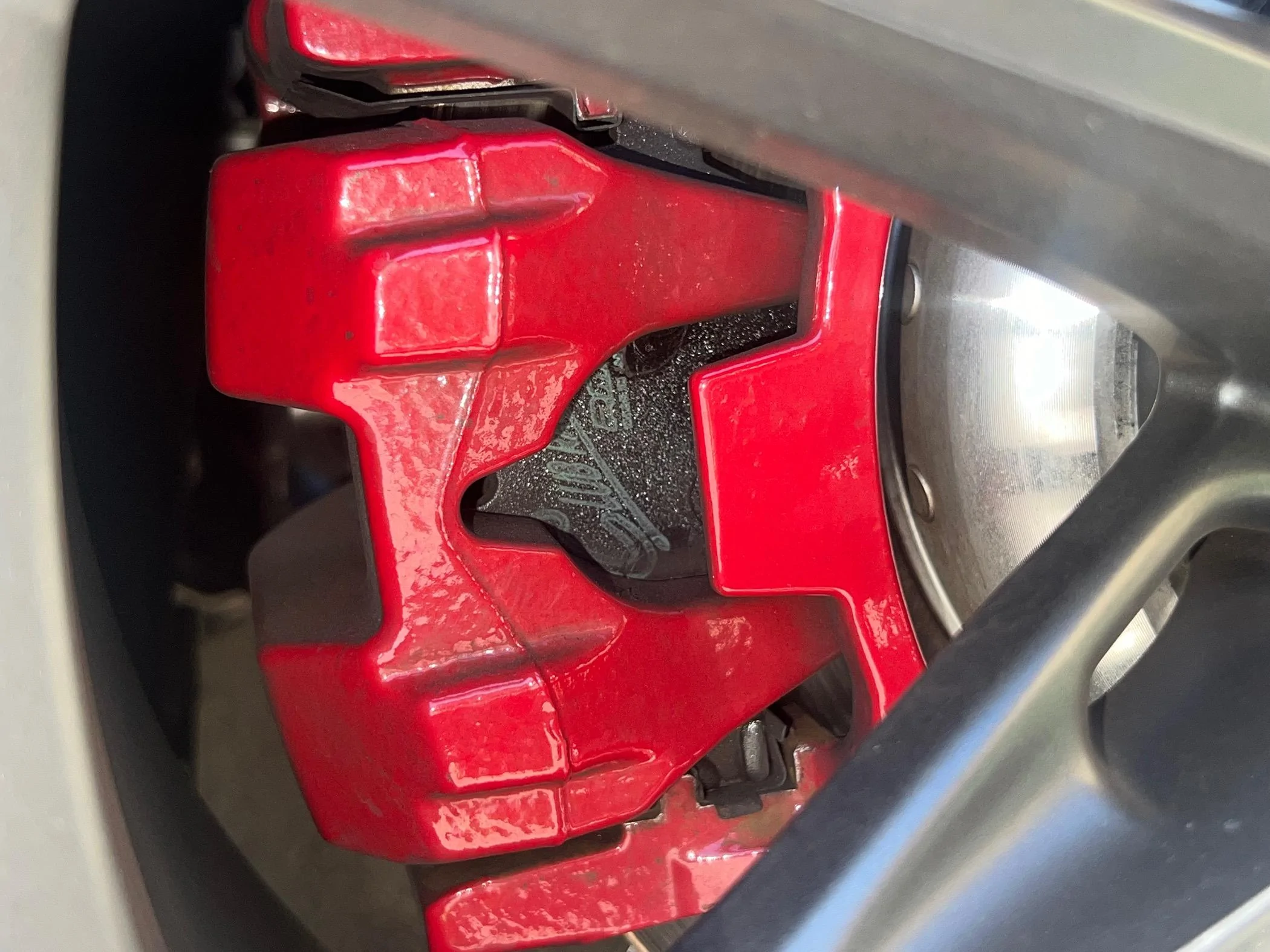

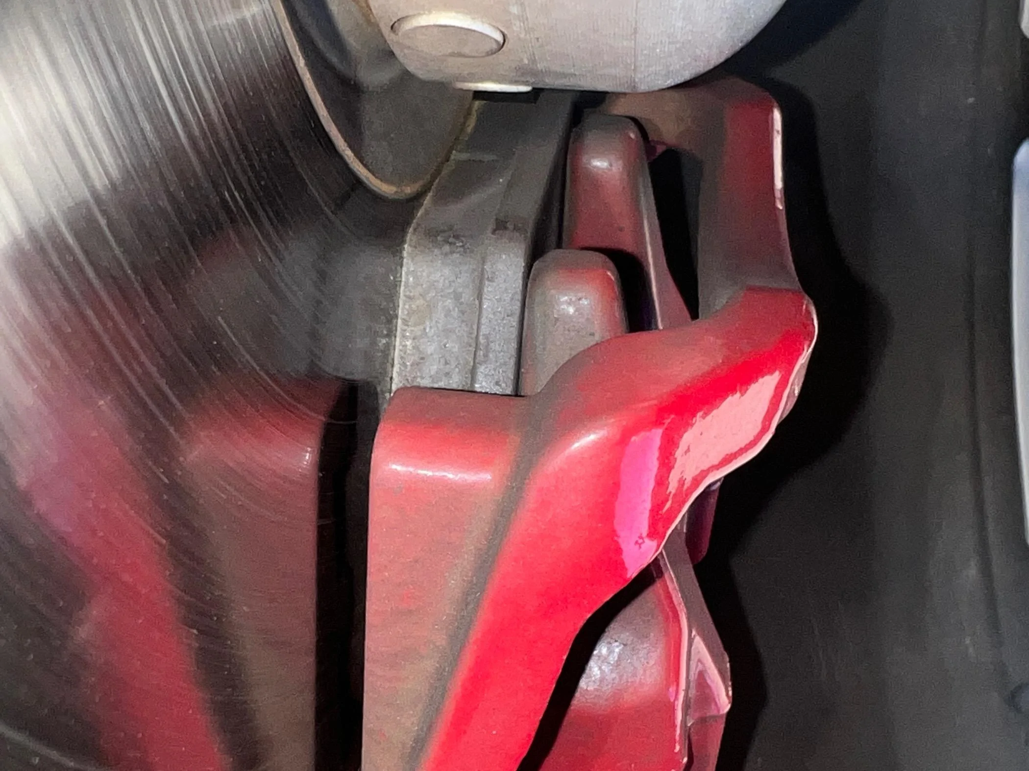

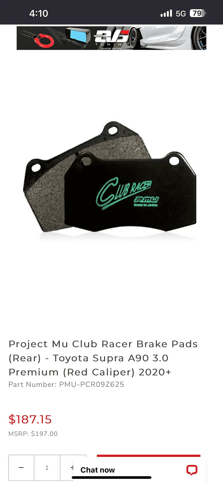

Sorry for the late response haven’t been on much. My base came with the red painted calipers so I ordered the PMU club racer pads for the premiums and have had no issues so far. Didn’t have any install issues either. 1 year, ~9k miles and 14 HPDE days. I’ll try to measure the rotor when I can and hopefully take better pictures.
