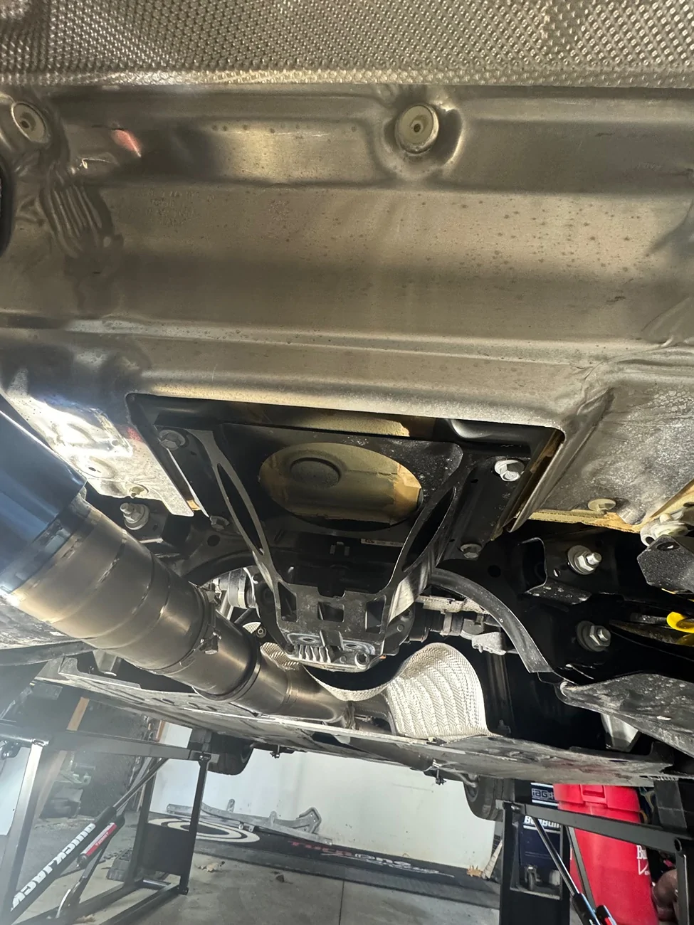

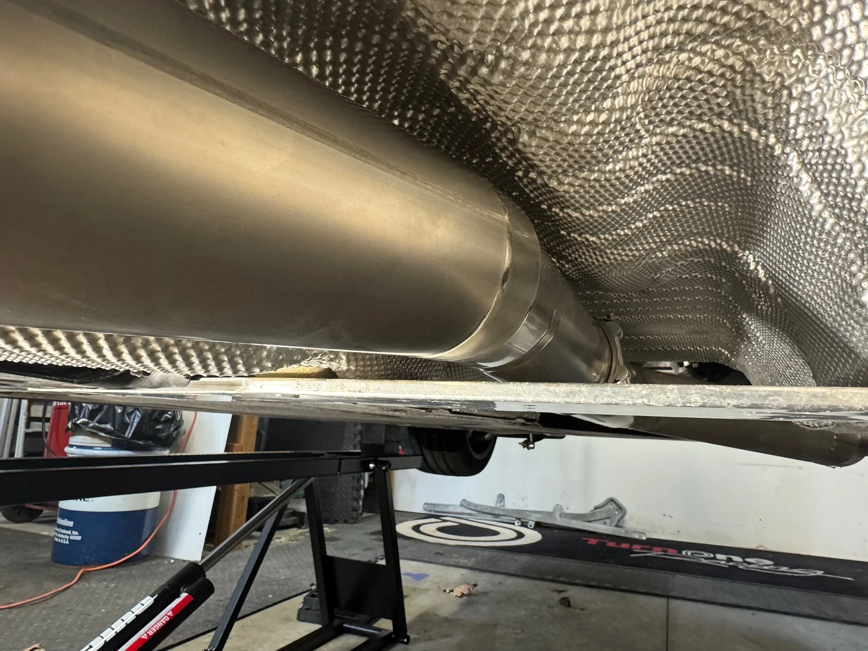

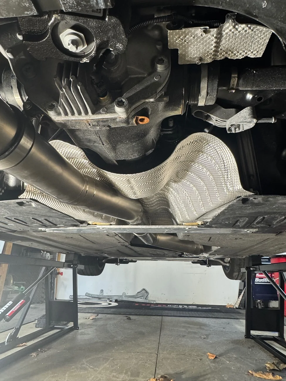

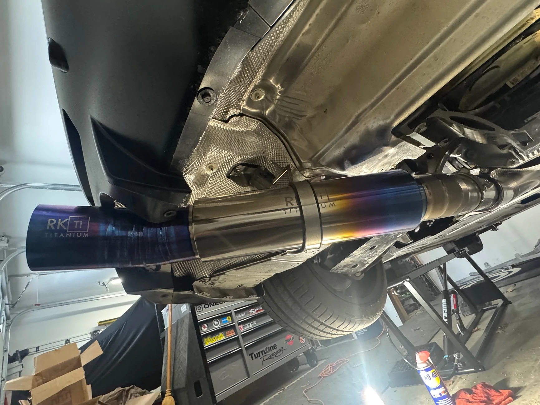

I ordered RK signature single - arrives in a few weeks. I’ll try and document.
Just following up! I confirmed that the center brace works as is with the RK Signature Single. No spacers necessary but I installed one section at a time to ensure the midpipe was rotated up close to the body, but not touching.
As for the FE braces at the rear, it isn’t going to work. Not even close due to the size of the pipe. The stock pipes are flattened in this section. The black part clears but the long flat aluminum braces that come off it interfere with the rear section of the pipe. I considered spacers but it’s over an inch off, not gonna work.
I left the FE bracing off, like many others have done without issue.
