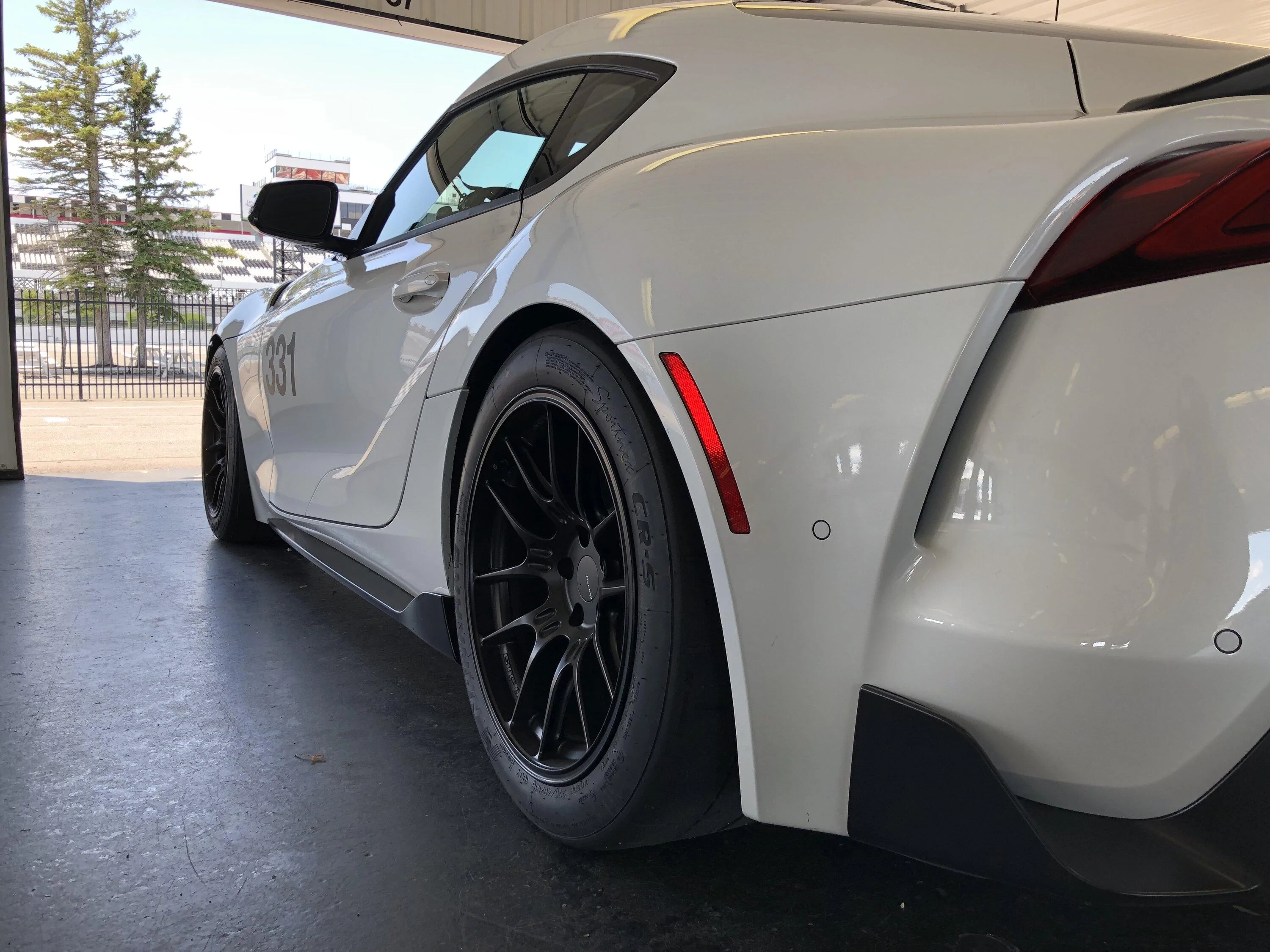

Exactly what I'm currently looking at doing, thanks for the thread. What kinda camber are you running with?
I can't speak for him, but I also have 265/35 and 295/35 RT660s on the stock wheels, lowered on HKS Hipermax adjustable springs. I have FC 5mm spacers and -2.3 deg camber up front, no spacers and -2.0 deg camber in the rear. Fitment is perfect, and while I haven't pushed it hard on a track, there's no rubbing with aggressive driving on the street.

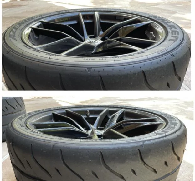

Great, I appreciate the info! I'm stock with no spacers, except Verus Camber Plates with -2.5 up front and -2.0 in the rear. Having a hard time finding tires. I pre-ordered RE-71RS from TireRack but the delivery date continues to slide to the right. I already corded my OEM tires (track set of OEM wheels and tires) at last months track event and have another on 6 July. The new estimated date is 9 July...so looking to order something else...

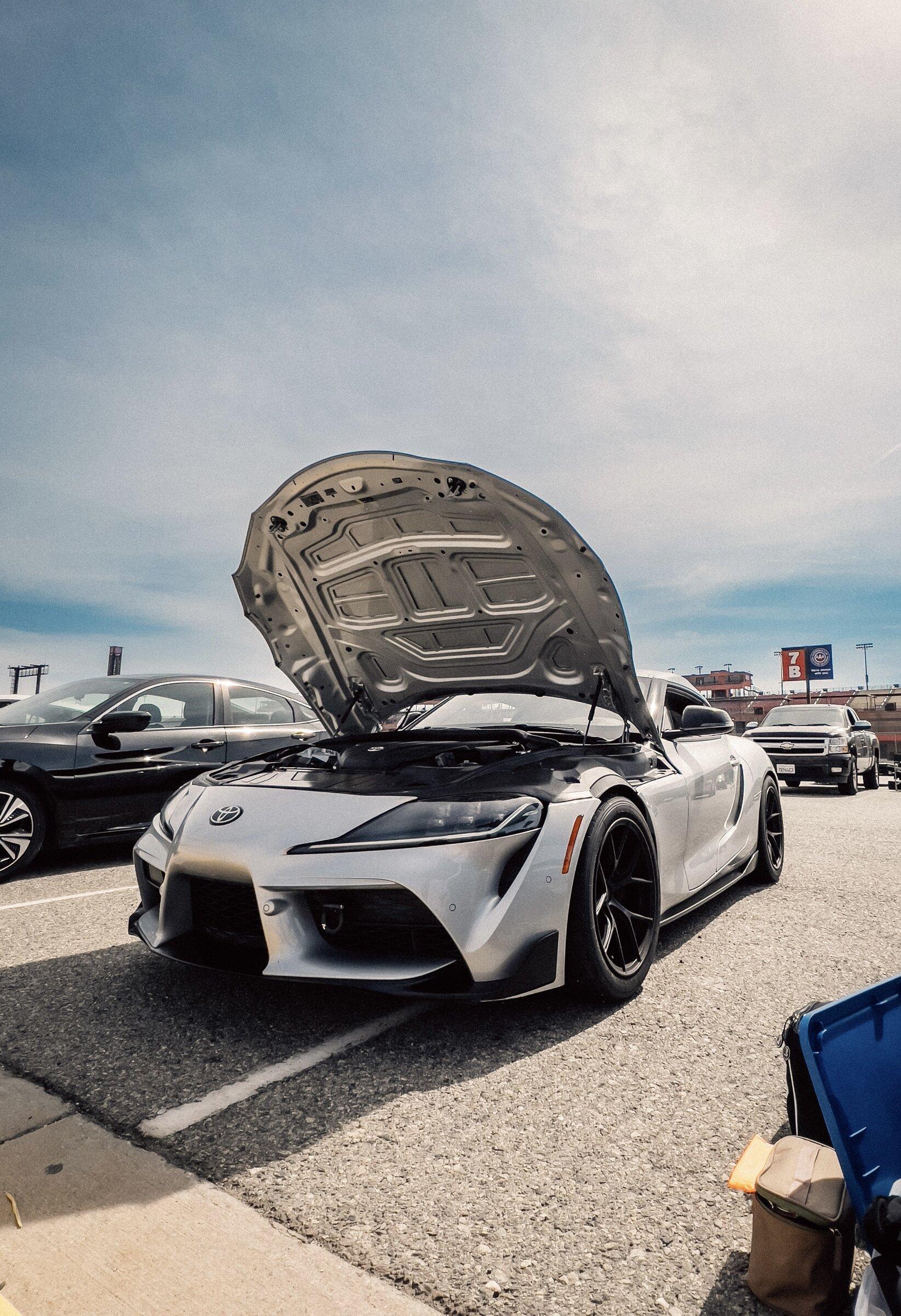

still stock except for Cusco front bar and CSG CP brake pads. Don’t have any other mods planned at this point. I stick to scca street class. Camber stock is just under 2 degrees and right now I’m running 0 toe f/r. I’ll probably put a little toe in in the rear but the car doesn’t really need it.

Gotcha. Yes, I forgot to mention I'm using CSG pads, C21/C11 that are great and also Front/Rear Toe- 0 deg. Thanks again, your info and pics really help ?

Just canceled mine as well. Highly recommend Nankang CR-S. Bought a set and used them at the track this weekend and they are killer. Other reason why I canceled my RE71RS order. I'm just going to keep buying these Nankangs.
