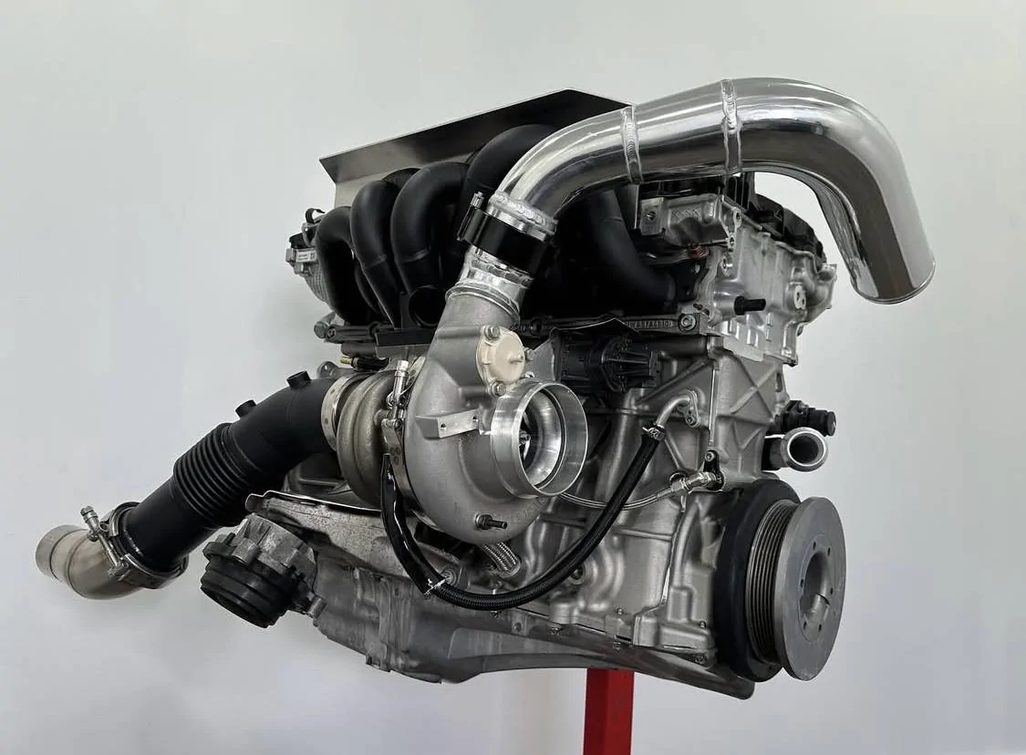

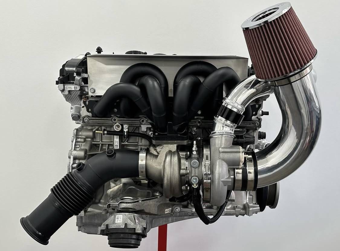

All good, thanks for asking. Sound is subjective, but I’ll try and lay out what you’re after. If what you mean by sound impact is by improving the sound. Well, there are some options and one of them has came up recently that you may be interested in. For me, I like the log manifold from BigBoost. Center fed bottom mount kit, not high pitch or raspy. Smooth inline 6 sound while still sounding rowdy, but less like a diesel when compared to the exhaust manifold the B58 comes from factory. For a bigger sound impact, I like the 4n kit with equal length runners. It has a higher pitch, but still smooth and no weird frequencies. For top mount, I like the Doc Race kit with the 1.9" runners. It sounds pretty good on the Gen 1 B58 and S58. Good pitch and tone, but not too raspy when compared to other top mount kits. I haven't heard many gen 2's with the 1.9" runner design, but the manifold looks pretty similar to the S58. The manifold design has changed over time with a new cast collector and possible runner changes so the sound may be different now compared to when the kits were out a year or two ago.
Now there is another kit that has came out recently I am not sure if you've seen it. I've seen this manifold some time ago when they were developing an equal length manifold for the S58. They have made a kit for the A90 B58 a bit ago. It sounds pretty nutty on an S58 (different motor, but manifold looks very similar to the B58).
https://www.instagram.com/g80_isleofman/reel/DQmH7ZBEdhJ/
link to kit https://straightline-motorsports.co...1-b58-6-port-single-turbo-equal-length-kit-v3
My opinion on these kits is strictly on sound, not on fit and fitment.
p.s. - I got the link for the Alunox manifold, it's available as a diy kit but I'm sure you could contact them and have it welded together. https://www.alunox.co.uk/product/bmw-b58-turbo-manifold-self-build-kit-321/
