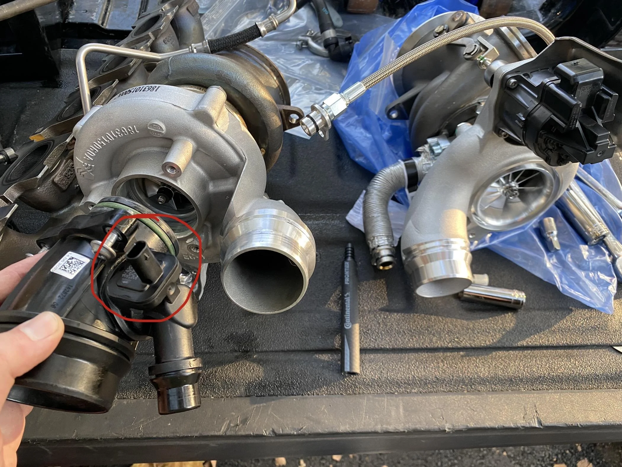

Hi all,
Currently installing the CTS 6 port turbo kit.
On the OEM turbo inlet there is a sensor.
There is no place for that sensor on the CTS inlet.
Is it necessary?
What do I do with it?
Thank you!

Code it out if you have bm3, or have your tuner code it out. It’s the heater for the evap.

Secure the heater wiring out of the way, it is unused now. You may get a PCV leak code until your tuner codes it out. Congrats on the CTS, I am enjoying the 2 port version.

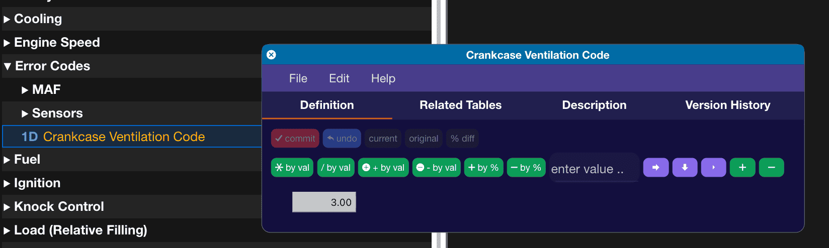

You ever figure out how to code it out? I’m looking for the same solution on my end. I also run BM3
It’s super easy.
When you’re configuring your map, at the bottom of the list is “DTC codes deactivation”
Enter the code you don’t want to see anymore = no more CEL.
If there’s a real problem causing the code the problem will still exist but the CEL won’t be showing.
