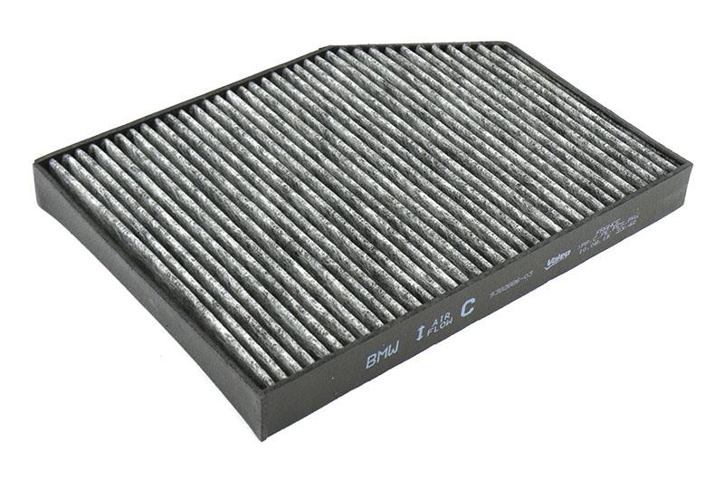

Darn Valeo.. Couldn't put a stopper ?
Would love to see the picture of failure mode. Couldn't immediately picture how it goes beyond..

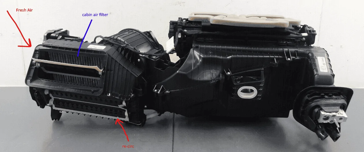

Unfortunately I didn't get any photos, but in your photo above, imagine someone pushed the back (nearest filter) of the fresh air flap up by about 2-3 inches. At a glance it doesn't look wrong, but it's basically inverted 90°. Your photo shows the flap in its 'fully open' position, so anything beyond that and the stepper motor is outside of it's range of motion.
