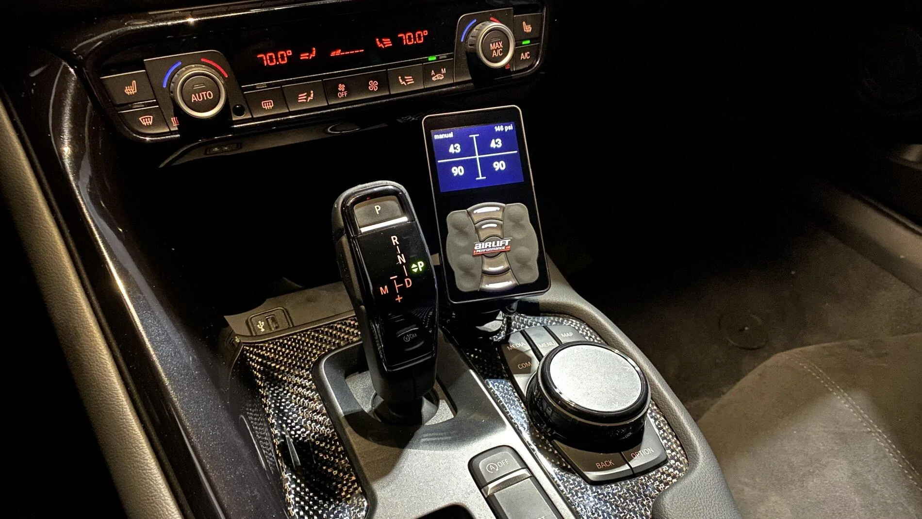

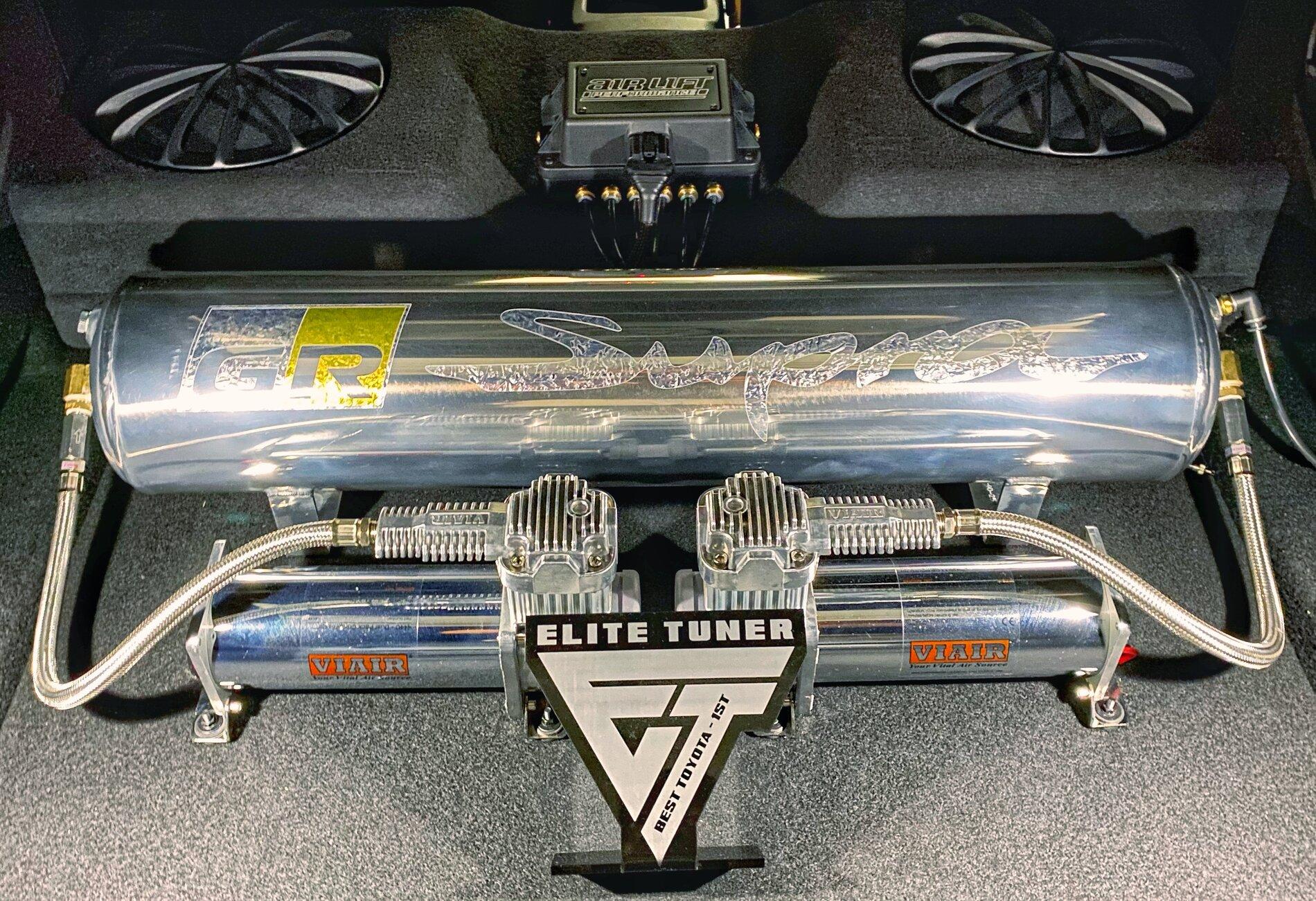

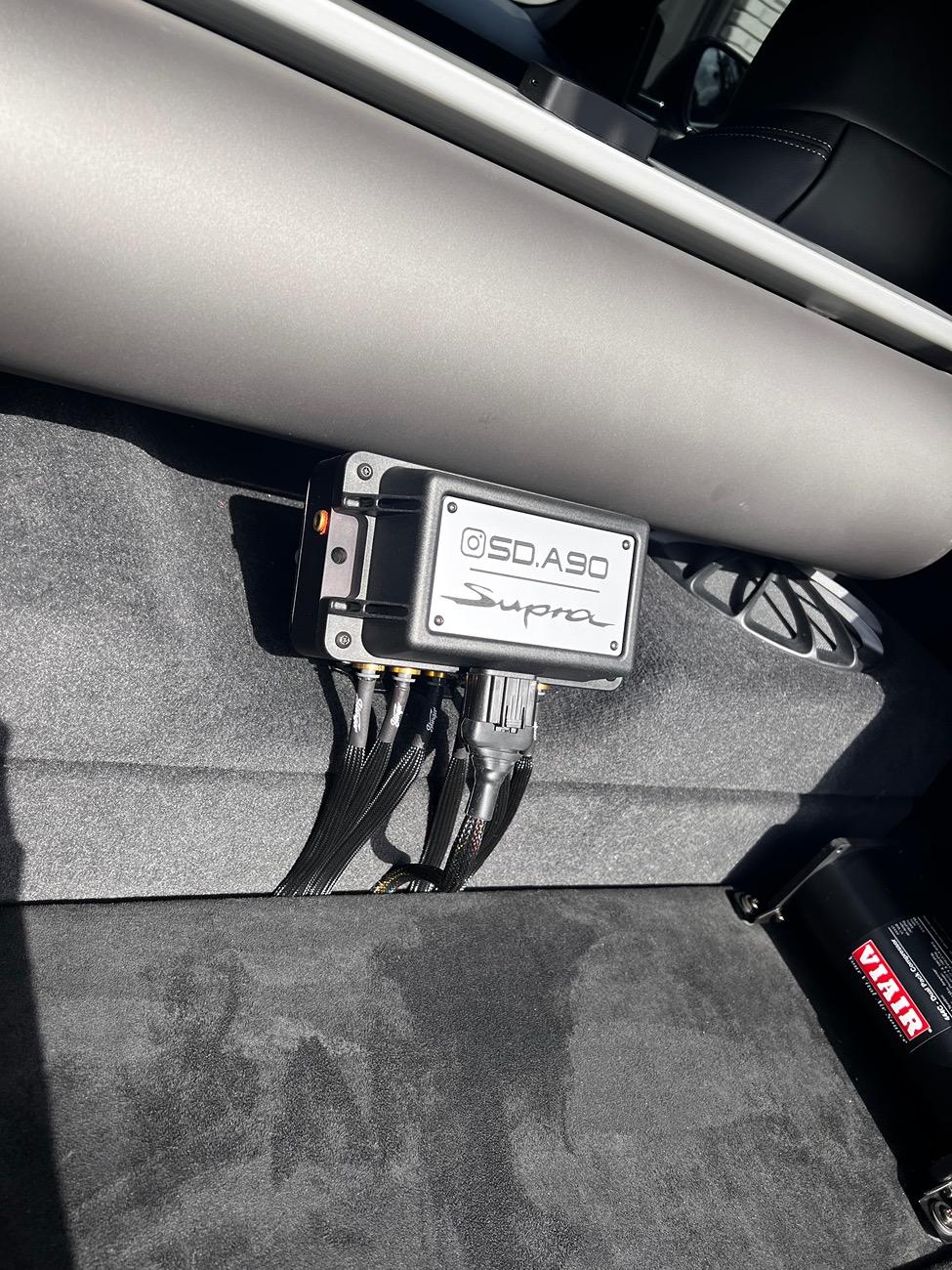

Such a clean install... now I'm inspired to reinstall my setup. BTW I've adjusted my struts and am running varying pressures to get kinda the height I want some of which is outside the recommended driving range. How'd you tweak yours to ride evenly?
dhobb52
Dan
Oct 18, 2020
SLC, UT
2021 A91 Supra, 2021 TRD Venture 4Runner
kinda a mix of pressure setting and where the height of the shock is at. I threaded the front shock up all the way (lowest) and installed that, and started the rear bottomed out and threaded it down little by little until the bolt lined up when the suspension was free with no weight on it. then set pressure based on where I was sitting at on springs but levelling the side skirts with the ground more, got me to 42 front and 90-100 rear. which is were i've seen quite a few others sitting at.
