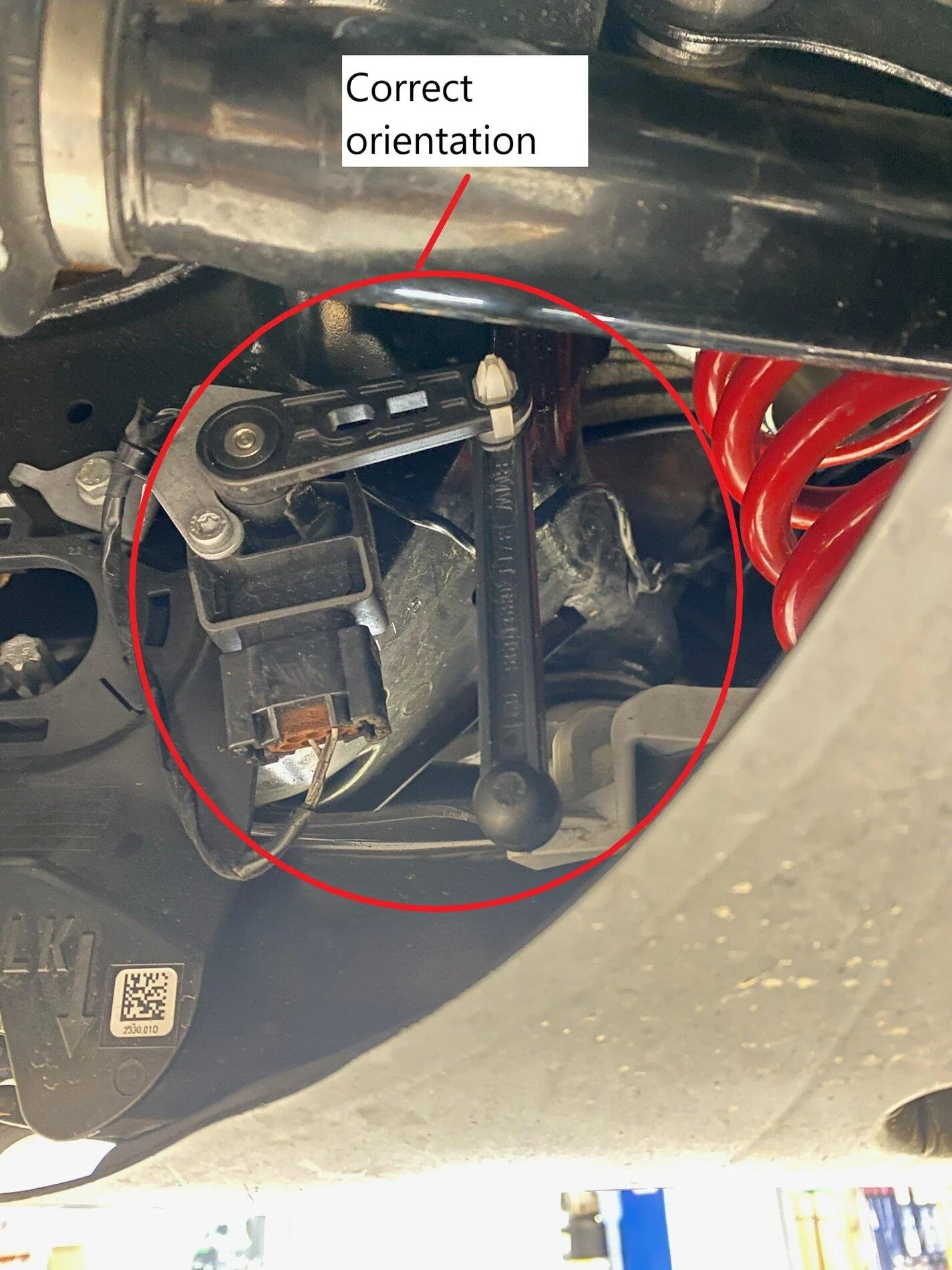

Take your time. Nut and bolt check everything after installing. It's a fairly straight forward install and takes maybe a couple hours. Make sure not to damage the ride height leveling sensors during the install.
Picture I used for reference of correct alignment of the rear ride height level bracket.
