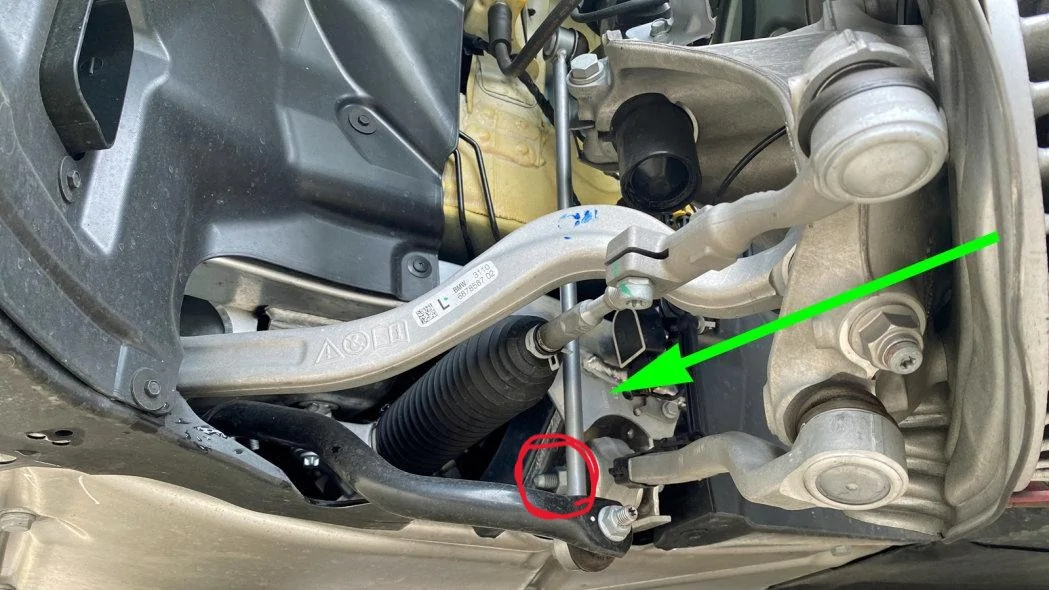

Just installed the KW V3 coilover, but I am getting weird clank? (a pop) sound from the front struts, most likely the springs.
It just happened when I put my car is on the ground, and when I lift up the car it makes that noise. Only once up and down.
My springs should be pre-loaded properly as well, just tighten the collar by hands until spring does not move.
I did torque everything in a spec, except the front lower control arm bolts near frame side. It has enough torque but I could not have a good access to that bolt. (I have attached the image of which bolt)
After searching a bit, it says I am suppose to tighten front lower control arm while on the ride height etc. I tried this, but even after trying to tighten it up, my lower control arm sags down like 3 inches or so.
Any help is appreciated.
SOLVED: It was the top hat screw that was not bolted all the way.
