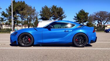

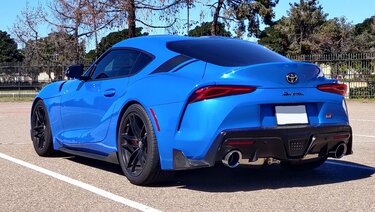

Just got the KW coilovers installed at Studio RSR.
Max ride height in the front is much higher than stock.
The setup I went with is:
Front: Went about 1-1.25 inches down from max ride height.
Rear: Spring perch flush with threaded area, this way all of the threads are biting.
Final height measurements after 1st adjustment:
Front: 360mm from center of wheel to fender. An overall 15mm lower.
Rear: 365mm from center of wheel to fender. An overall 20mm lower.
I will probably lower the fronts another 5mm to match before I call it good.
I did not bother to measure what the maximum ride height is in the rear. You could probably go the width of the spring perch higher in the rear (about 10-15mm if I had to guess). You wouldn't have all of the threads biting though.

BadOne
Are you able to upload some pics?
