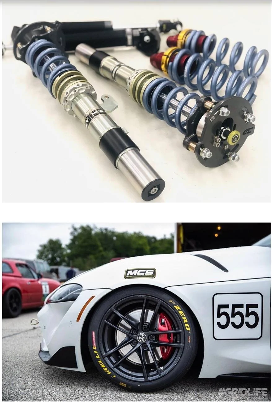

Here’s a picture of the MCS and the front of their car…. If yours look different, your mechanic doesn’t know what they are doing…

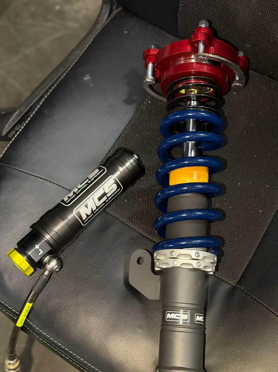

I got the height issue in the front. Spring is 7” and here is how it looks like. It did look different from the picture above.
Is your height too low or too high? If the locking collars are all the way down at the bottom of the threads, and your ride height is too tall, then remove the helper spring.
I had 6" front springs + helpers on my front so a 7" could possibly be too high if you're using helpers.

It is too high. I just got response from the shop, they sent me the wrong spring and replace with a 5” one. 🥲
