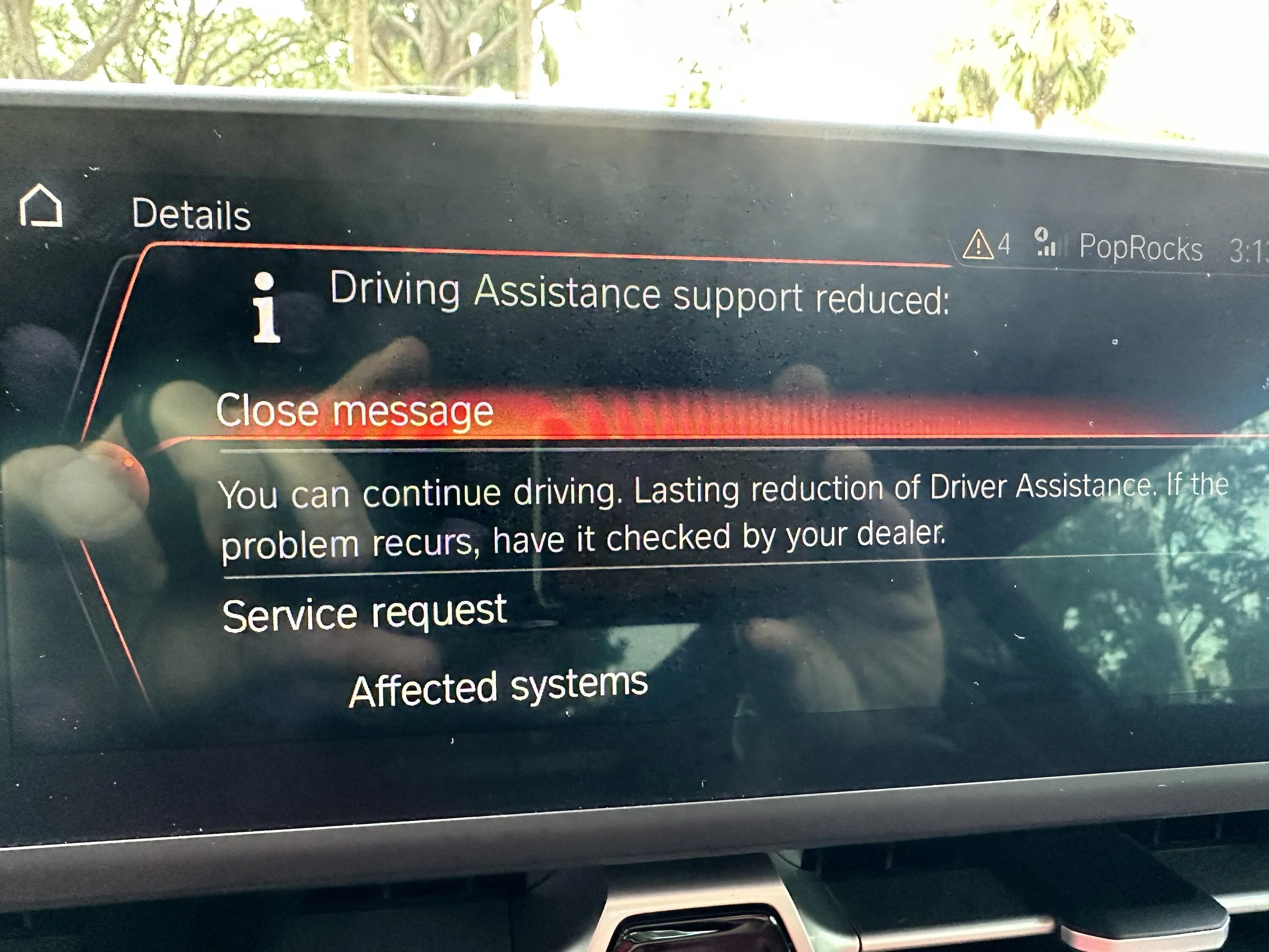

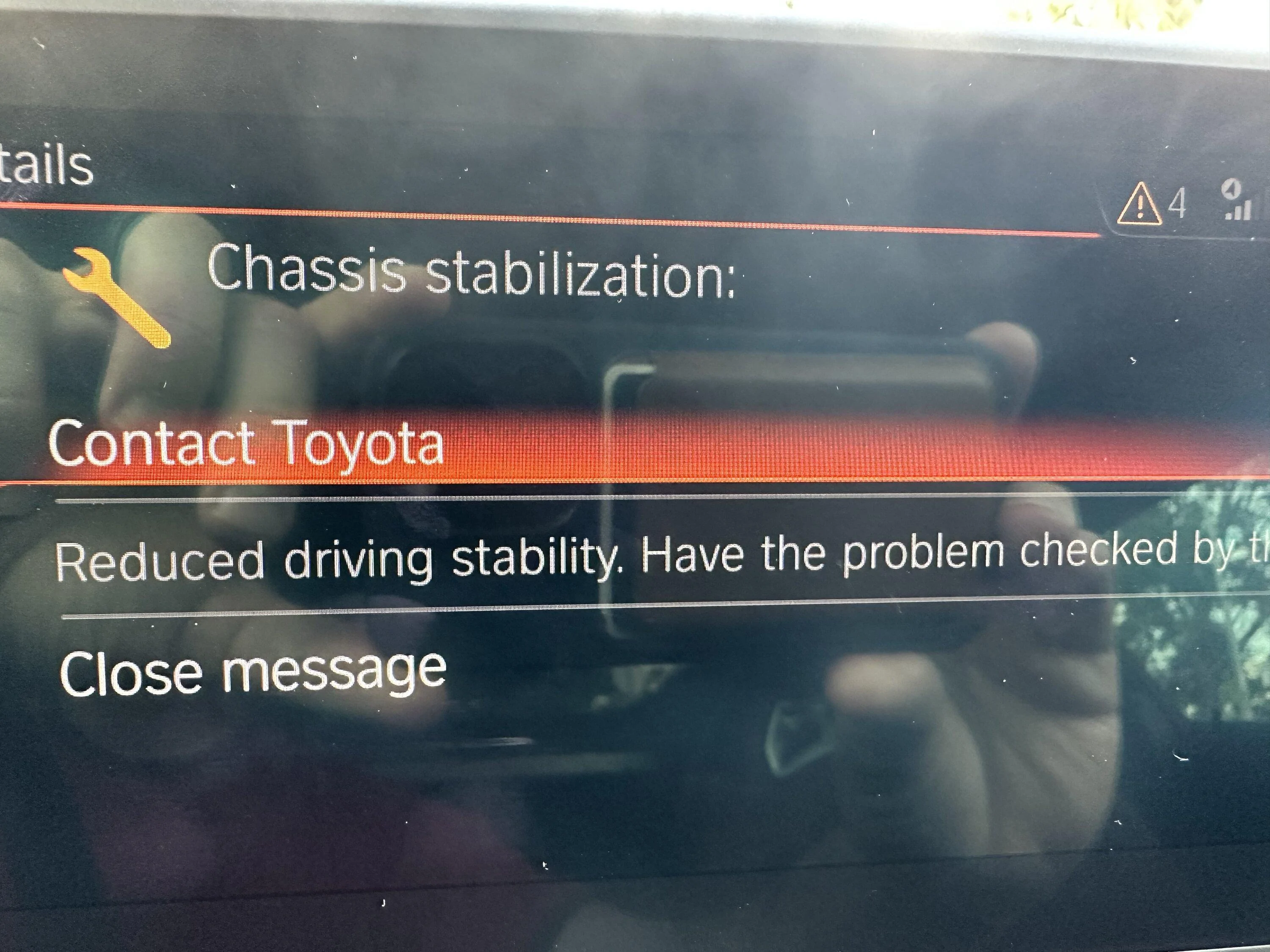

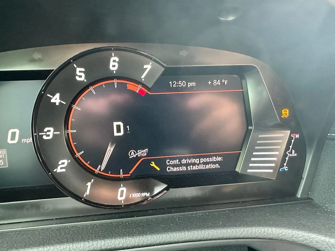

Chassis Stabilization Error / Rear Differential lock reduced.
I just finished up install on my Driveshaft Shop axles, Pure850, and JRZ coilovers + RSR Cancellers. The battery was connected for all these installs. Long story short, upon completion, I was hit with a number of error codes.

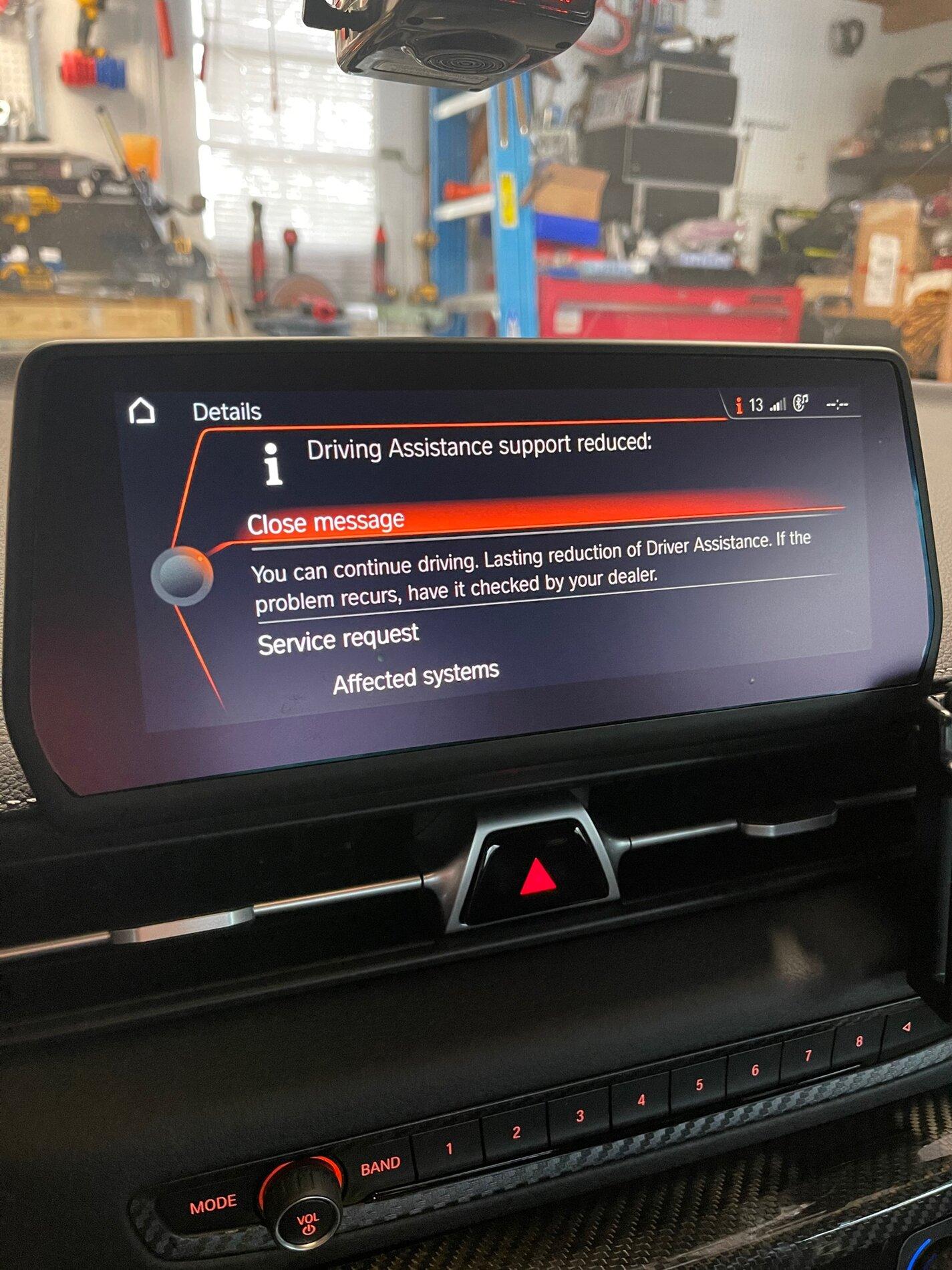

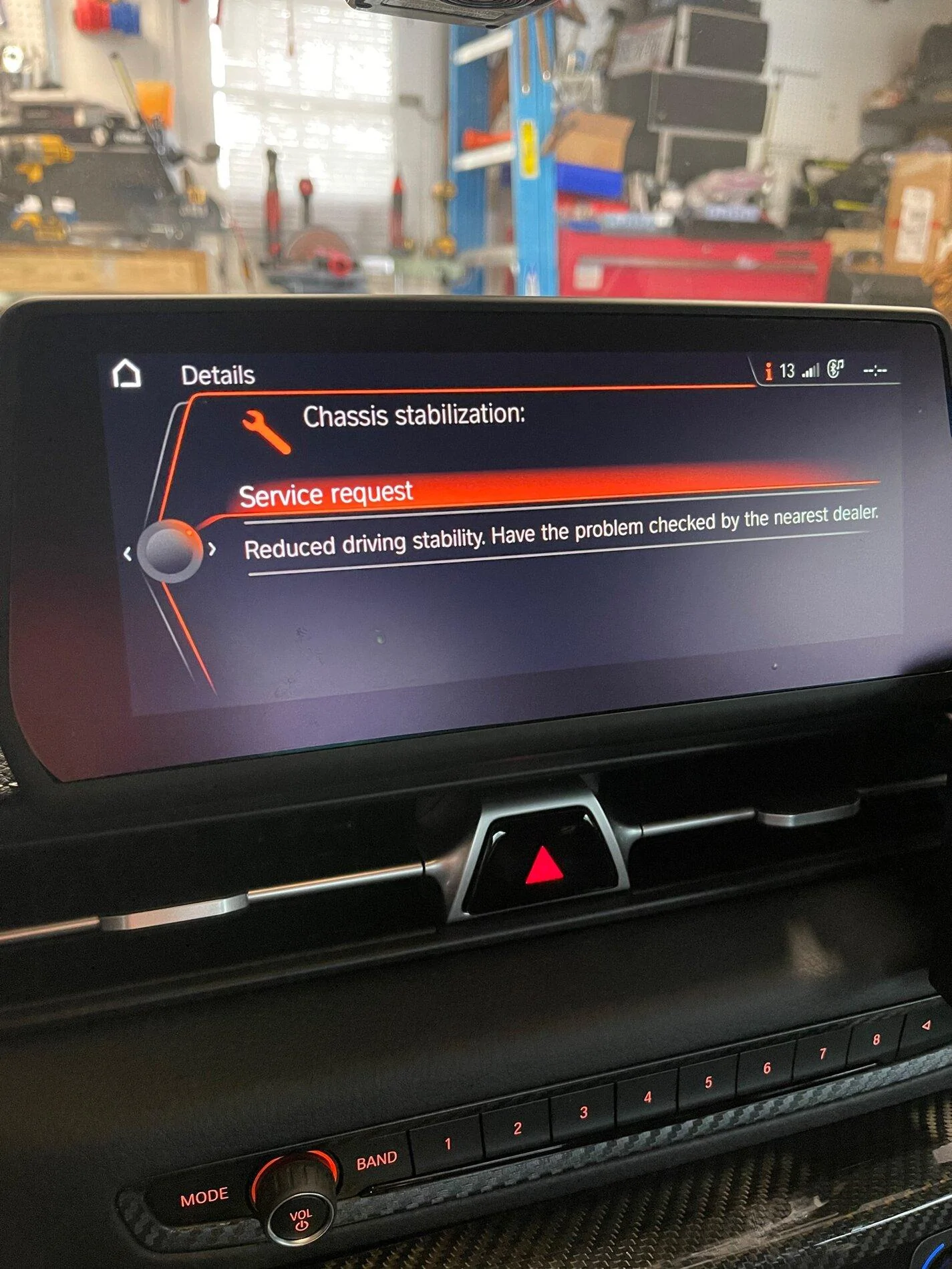

1.) Chassis Stabilization (reduced driving stability)

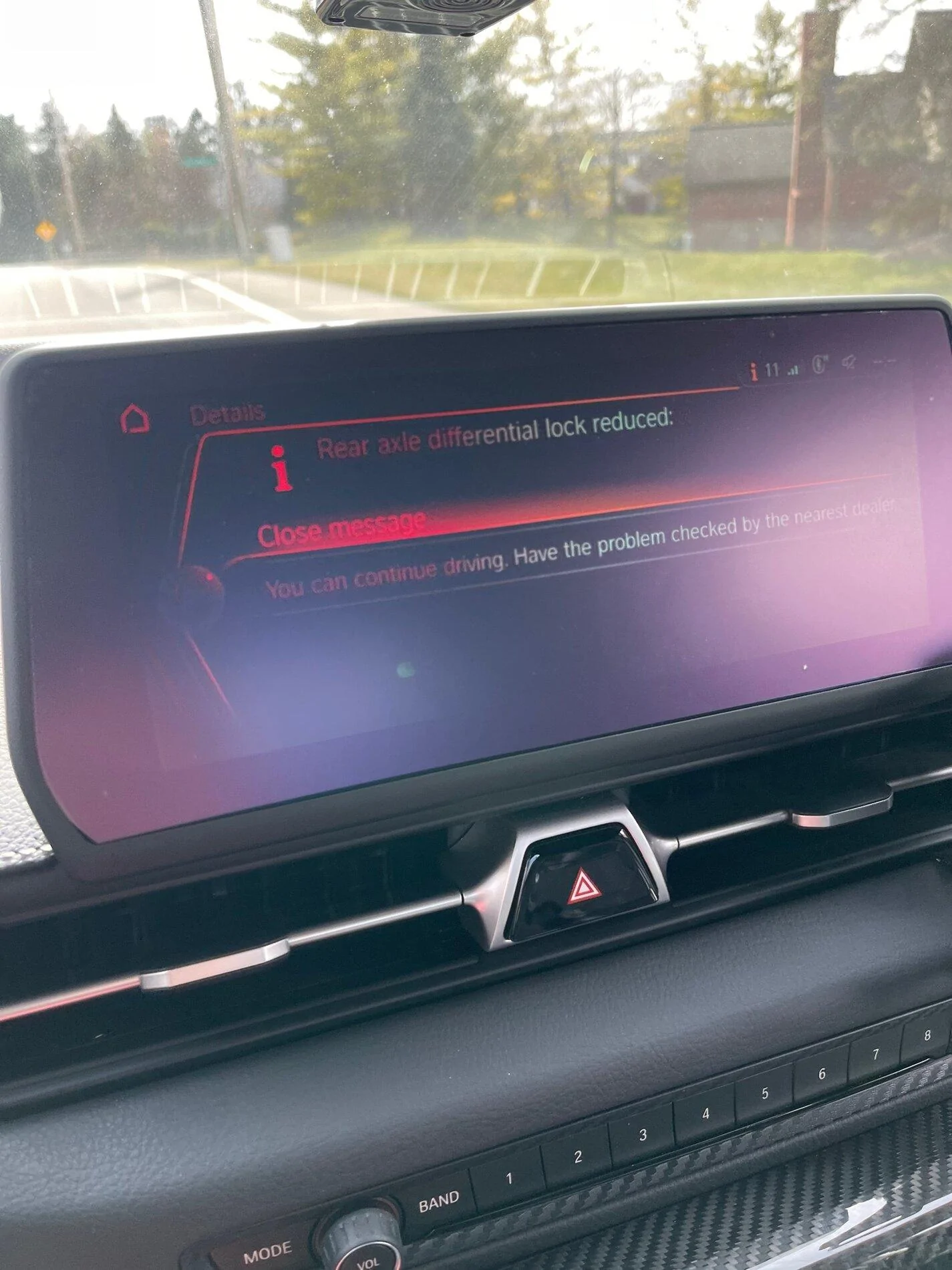

2.) Rear differential lock reduced
3.) Driver Assistance support reduced

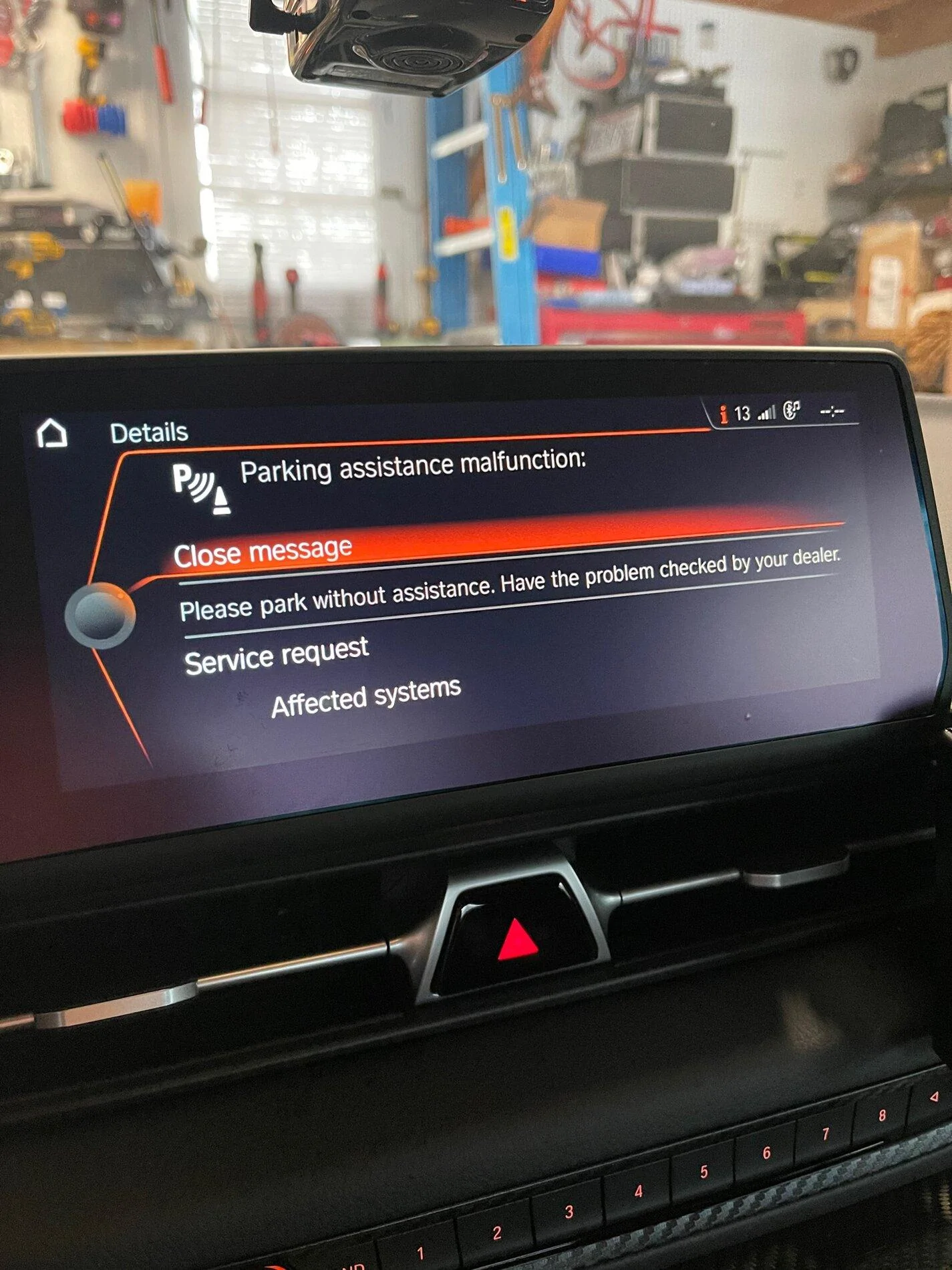

4.) Parking Assistance malfunction
I have done my research and it seems that a lot of people have had issues after a coilover install either relating to the ride height leveling sensors OR the dynamic suspension system.

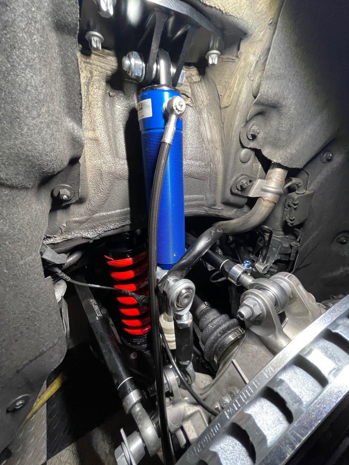

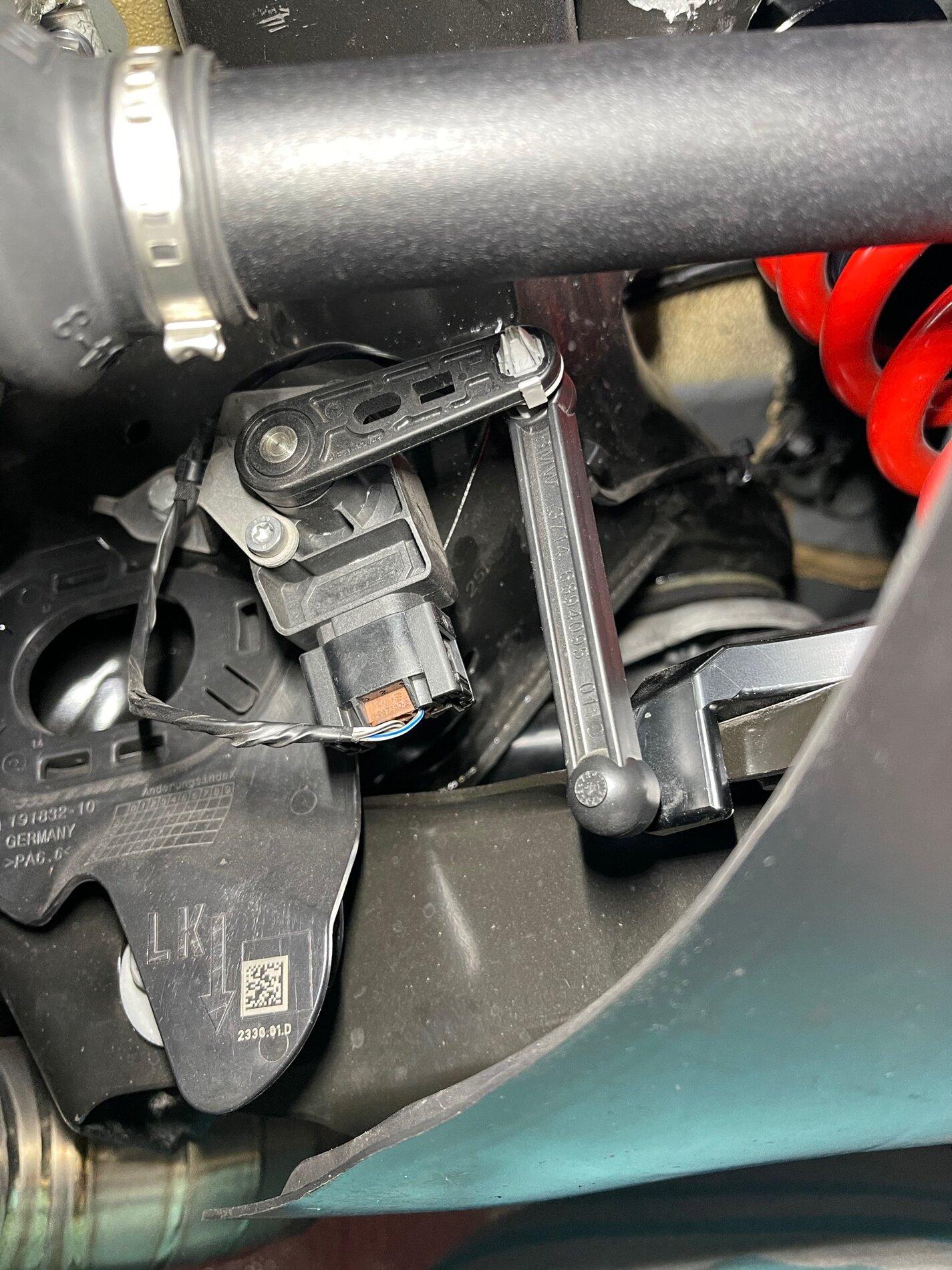

I have checked every connection to the rsr cancellers to ensure no pins are bent and the clips are securely fastened. I have also made sure that the ride height leveling sensors are parallel with the ground at ride height. I have also reflashed the dme with ecutek 3 times with no avail. I also have had the car on battery charger for 3 days straight. I have also tried unplugging battery for 30 mins and then reconnecting. I am stumped.
I have heard others say to drive and it will sort itself out. I drove about 75 miles yesterday and all the errors remain still.
I have been trying to diagnose this issue along side Jordan Best because he recently had the chassis stability error pop up after his JRZ install as well.
If anyone can point us in the right direction we would greatly appreciate any help!

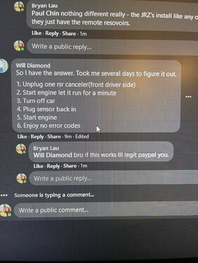

sounds good. Also, someone posted this in the Facebook thread. Want to include it in case it might work for others:

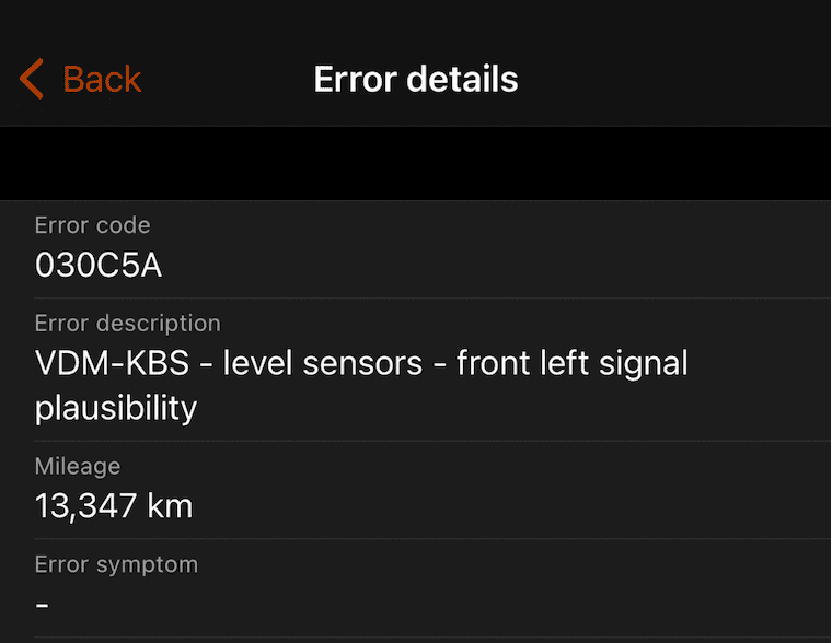

If you read the code(s) you will know exactly what is causing it.

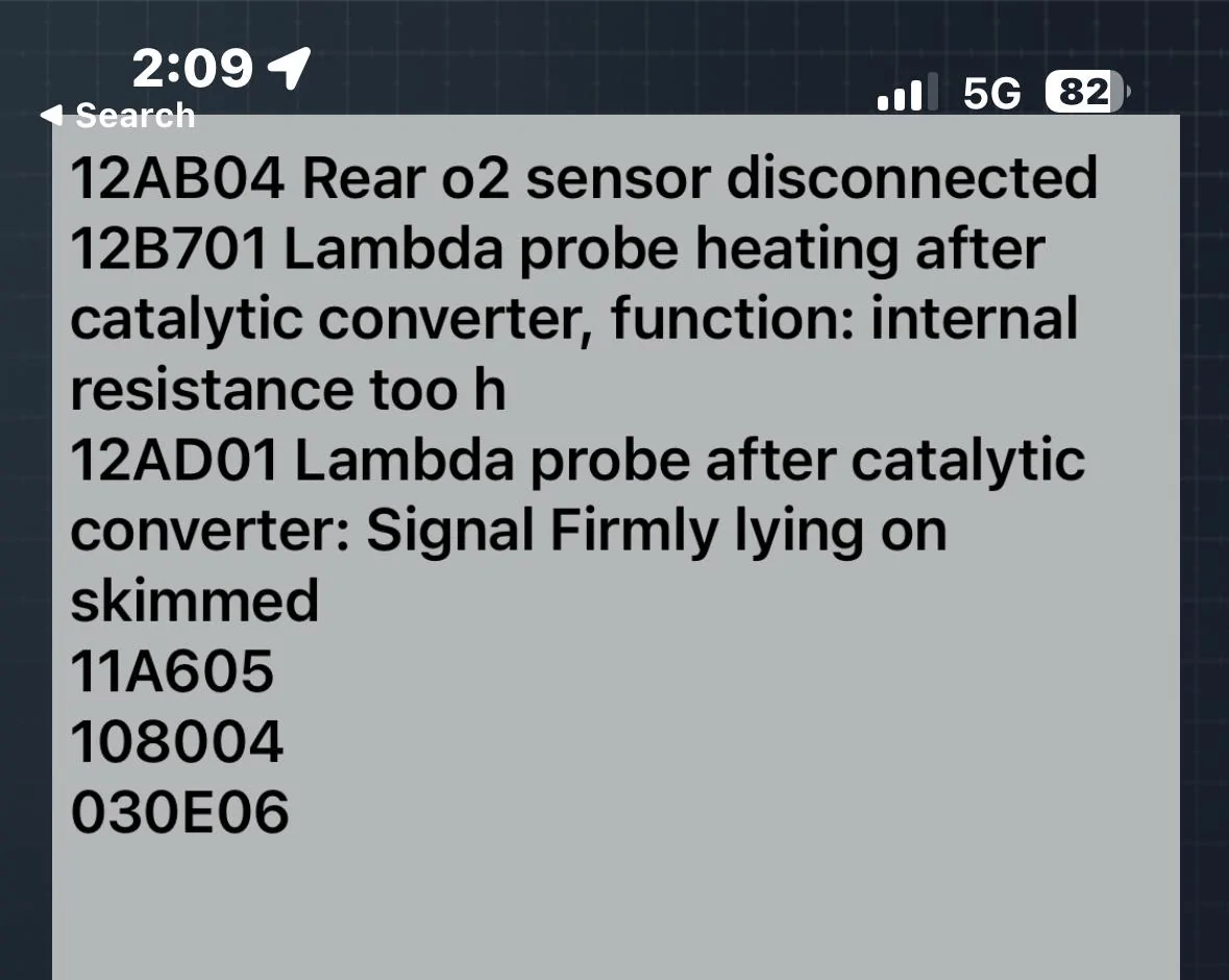

All I get is this:
The 1st one is always on there with my catless dp. Oddly enough no CEL, lol. I’m taking it to my mechanic Friday AM. Luckily it‘s saying I may not have all the “safety“ demons turned on or that it can’t turn on Toyota’s version of traction control. If that’s all, I’m cool with it for now…. I just don’t want that stuff turning on, on track. I’ve tried hitting the safety button to turn everything off and it all appears to stay off. I’ll find out this weekend on track. And I’ll bring my MX5 as a backup car.
I definitely want to clear it though. It’s not like a CEL. It keeps coming on every couple of minutes, interrupting apple car play or music or whatever. I’ll try taking some really hard corners in town (with no cars around) and see how the backend handles it.

All I get is this:

Yessir! My windshield installer had the Toyota brand Techstream software to code out the steering angle sensor from an aggressive track alignment. Any time things come up, finding & fixing the cause and then resetting the codes usually does it. Hope that helps!
