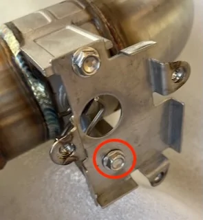

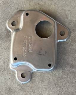

Hi everyone,
I purchased an ARK exhaust for my new Supra last week and am working through the install right now. My valve actuator bracket was also bent out of the box like another member mentioned. I just unwrapped it from an undamaged shipping box today, so the bent bracket was provided by ARK (or by poorly secured parts inside the box during shipping). It was easy enough to bend back straight, but still annoying for the amount of money I spent on this.
Quick question for those of you that installed this exhaust, did you leave off the metal shield on the valve actuator? (picture below, you can see light scratches on the shield where the bracket bolt hits it, directly below the big hole)
The actuator fits flush in the bracket without the shield, but with the shield it hits one of the bracket bolts and will not sit flat, so just want to check to make sure I'm doing things correctly.
Thanks in advance for sharing your experience. Looking forward to finishing up the install and starting the car for the first time.

Hi everyone,
Install the shield when you install the actuator. It’s there to isolate the actuator from the exhaust heat.
Okay, but how? The actuator+shield will not sit flush in the ARK bracket because of the lower bracket-mounting bolt being in the way (see photo). The actuator does sit flush without the shield as there is room for the bolt head. Did you cut a hole in your shield to accommodate that bolt?
I have also sent a note to ARK Support asking this same question and will call them when they open up next week.
I did not use the shield and haven't had any issues without it—I have about 30k miles on the exhaust

I called Ark on Tuesday and they confirmed installing the valve actuator without the shield is correct. That is how they do it on their own installs.
Overall I’m very happy with the sound. The fitment is just slightly off with one tip not-quite centered and sticking out a bit more than the other, we’ll see if it settles during a road trip I’m taking this weekend.
