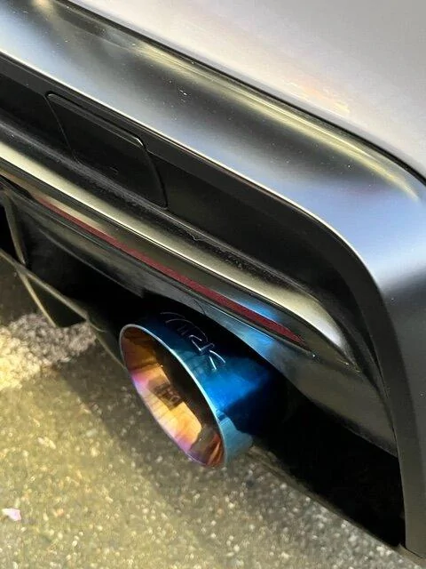

don’t buy this exhaust. It’s a power DOWNGRADE. The exhaust piping is smaller than stock, and you 100% don’t want that ever
Is this something you suspect? Or do you have numbers/evidence to back this up? Not doubting you btw as it makes sense

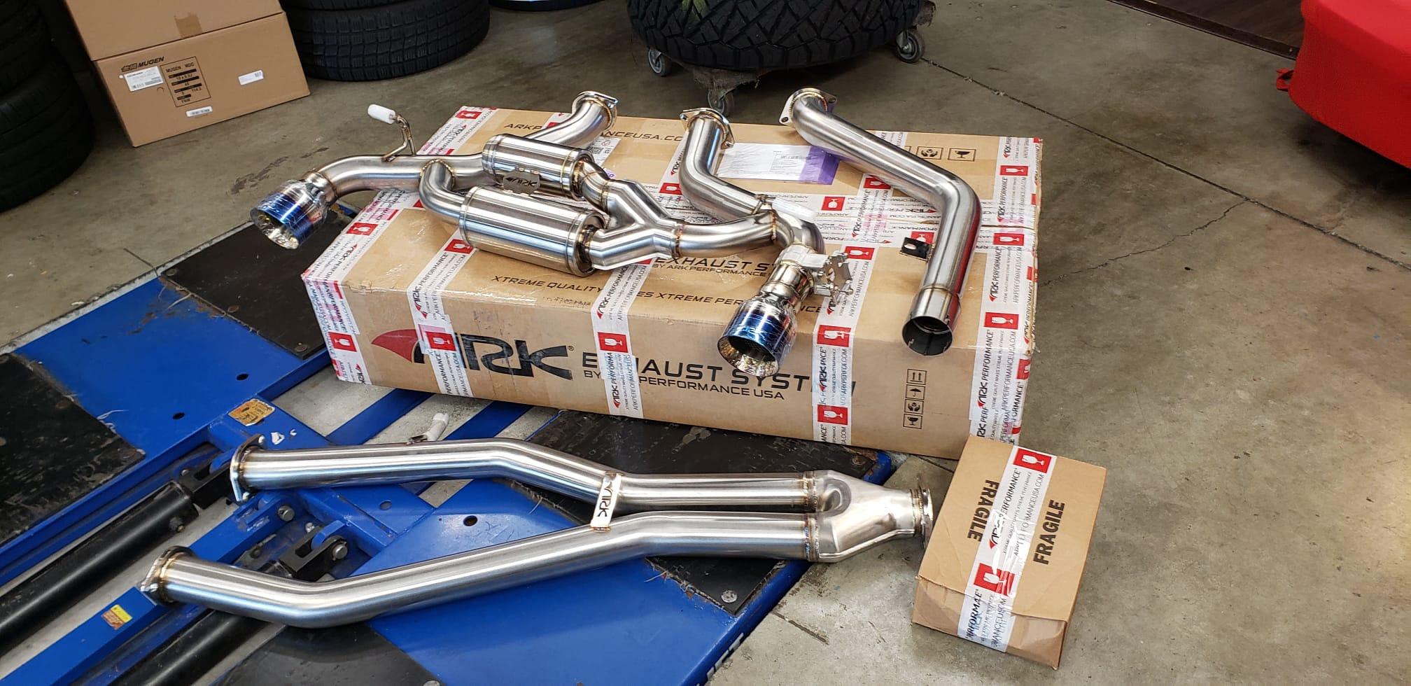

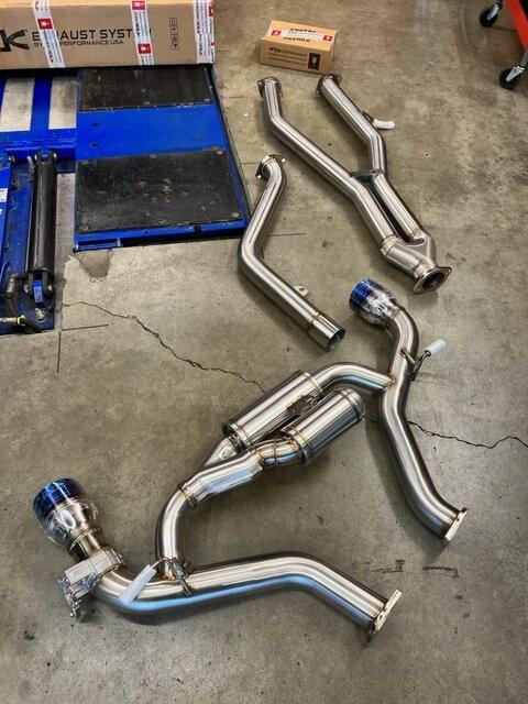

OEM exhaust is 80.5mm after the downpipe before the resonator, and 69-79mm after the resonator to the muffler. Ark is 76mm throughout.
She might be correct to say that the Ark is less airflow than OEM.
The difference after the downpipe is regressive on the Ark (76mm vs 80.5), which could retard turbo spool time and flow rate (power loss). However, the Ark midpipes are quite a bit larger than the 69mm "crush" sections of the OEM exhaust. As airflow on an exhaust system is restricted by the narrowest section, the narrowest section rises from 69mm on OEM to 76mm on Ark.
The post-downpipe and midpipes changes probably net out to be flat to slightly negative performance versus OEM. I wager it would be in the noise. More conservatively, I will say that the Ark is a solution primarily for its sound and does not convey additional performance.
There's nothing wrong with that. That's what some people want. But it's not a choice I'd recommend to someone looking for a power bump: that requires the diameter to be larger than OEM throughout the entire system.
