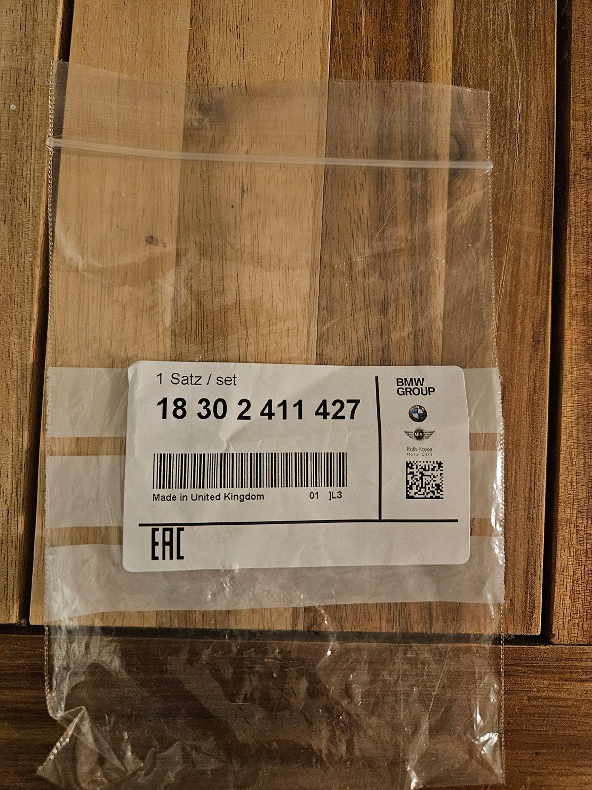

That one doesn't fit its 3pin the valve actuator is 4 pin. I bought that one in the Pic and don't fit.

You will need this part if delete the exhaust flap actuator. The actuator has 4 pin connector. Grimmspeed only sell a 3 pin connector. The 4 pin I got from ecs tuning. Part number 18 30 2 411 427.

U won't get a cel but it may have an issue with going in an out of sport mode. I bought the valve delete simulator from ecs tuning for bmw as the plug for our supra is a 4 pin plug. Don't order the one from grimmspeed as it's only 3 pin plug.
Just bought, hoping it works 😂
