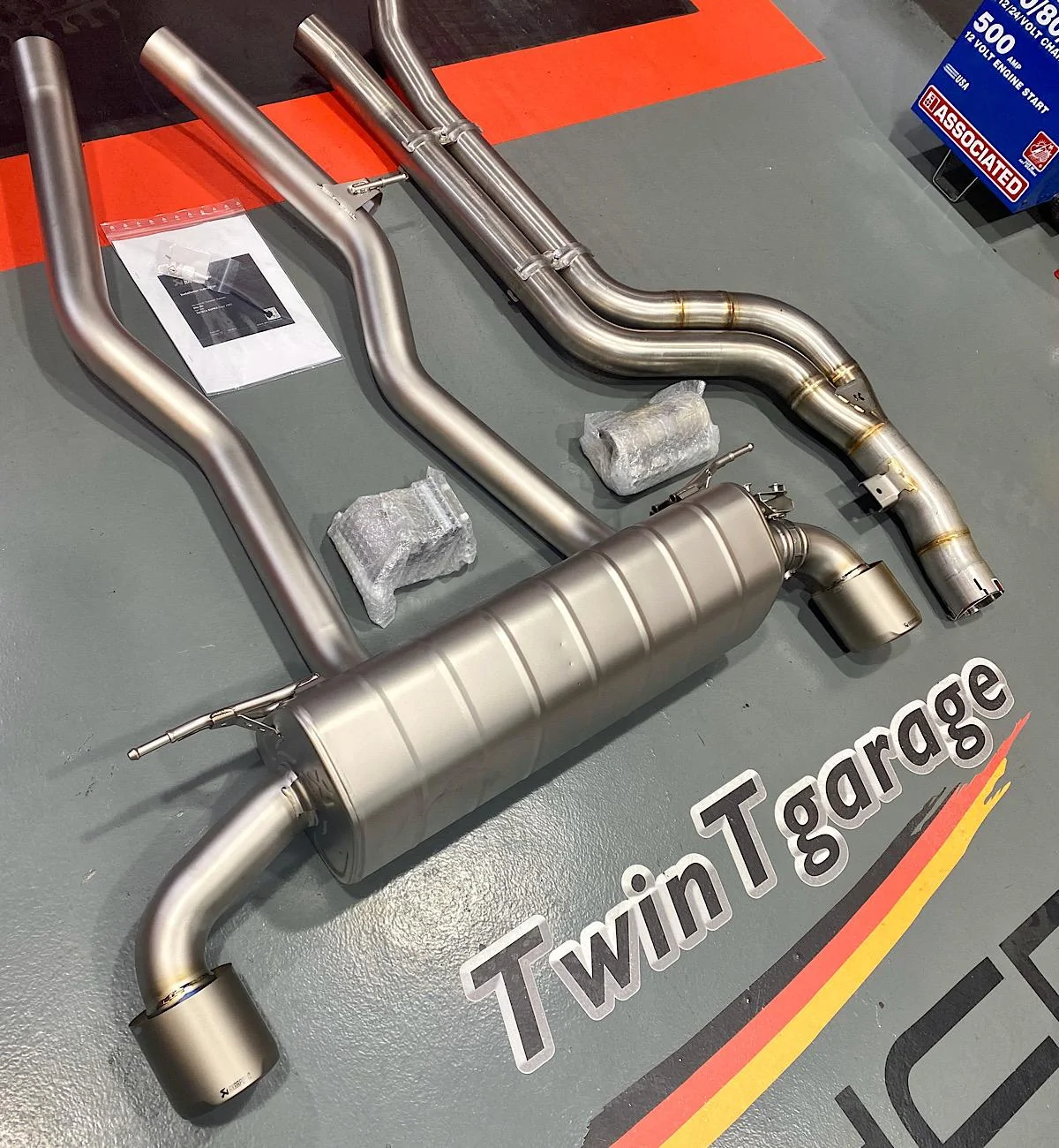

We just finished up a prototype exhaust, I’ll see if I can’t get you guys a video tomorrow!

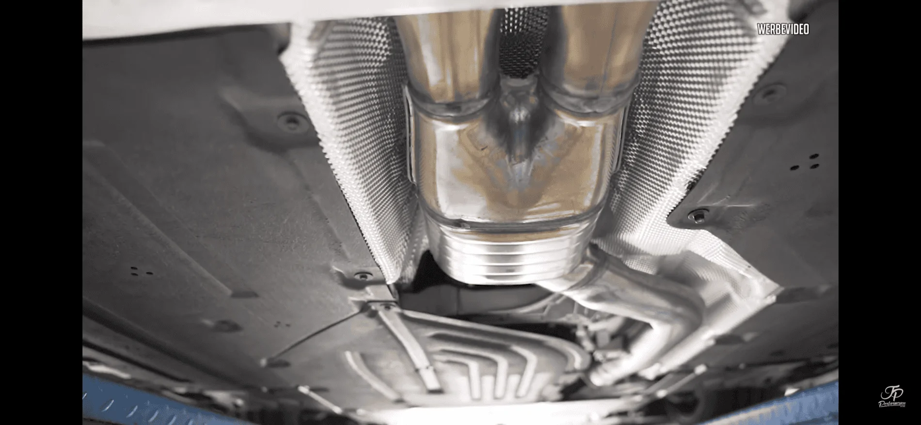

Here’s a picture from JP’s video

Doubt it will be w/o any sensor, because something needs to tell the ECU what to do and what’s going on. Exhaust temperature has to be maintained at a certain level or the thing won’t work (it’s not an air filter) Example:
I did some further reading on how someone in Slowenia put in a different downpipe in G29 Z4. Apparently this almost melted the filter and they claim the only way it would work is by removing the filter AND coding the ECU.

Thank you for the reply.
I guess just swapping the midpipe with the US version will not be attainable.

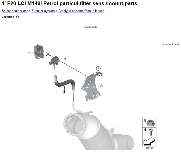

Neither could I, but it's questionable if all parts were listed.
I had a look at the diagram of an F20 with a B58 and particulate filter. According to which the F20 has a pressure sensor:
I searched the part number and found a page where you can buy it
https://www.baum-bmwshop24.de/bmw-sensor-differenzdruck-13628570686/?form_key=56232914cf7725f9
Scroll to the bottom of that page to see which cars it fits and you'll see:

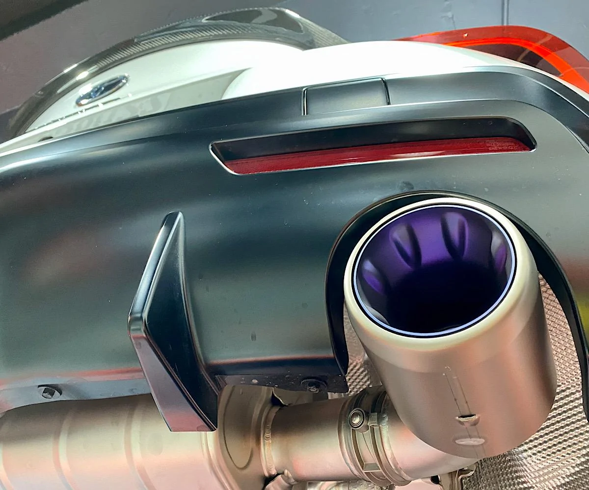

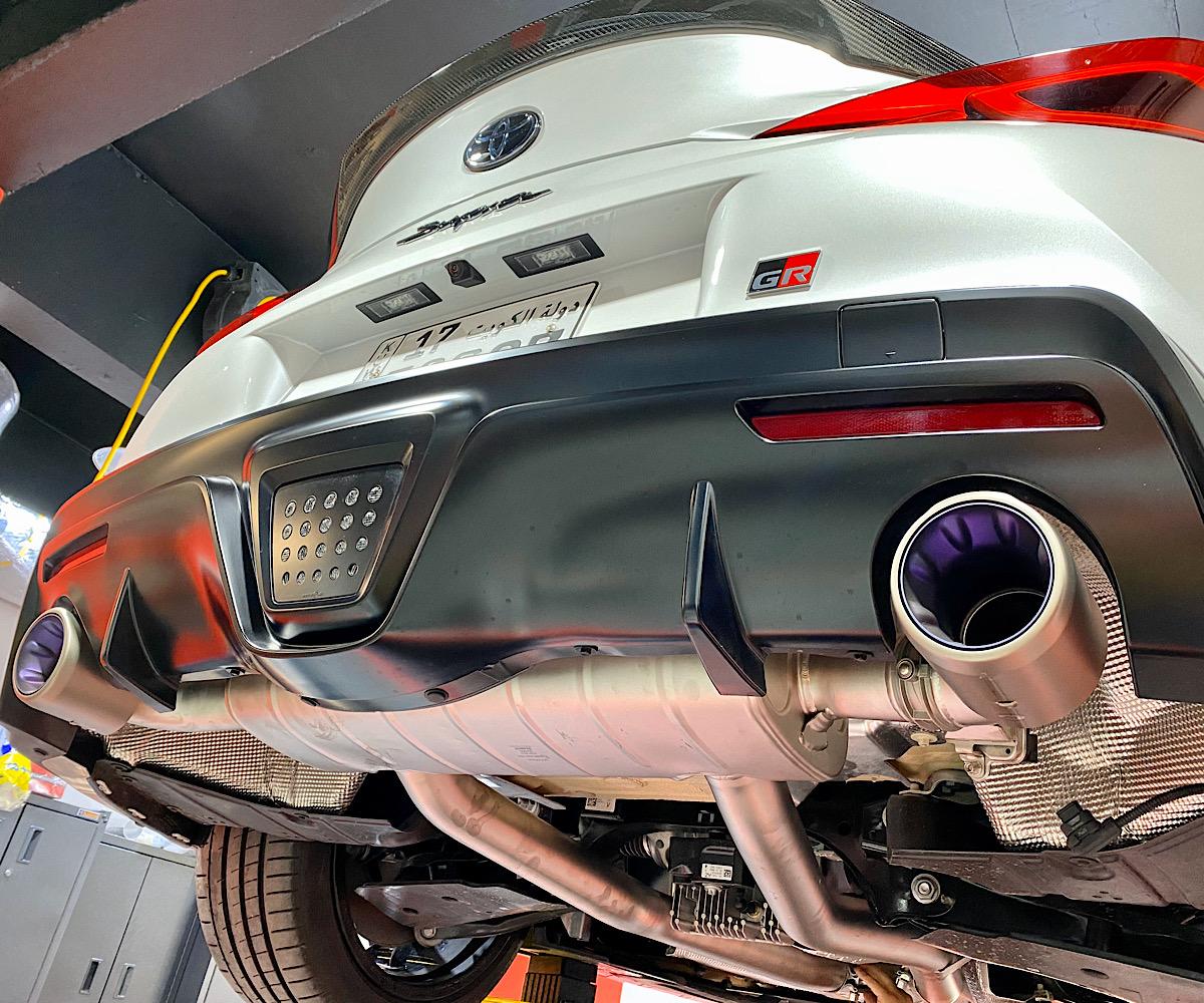

Akrapovic EVOLUTION installed
Ordered from IND - The best always
Quick video I did
Sounds amazing, not too loud and not quite. Perfect balance and suites the car perfectly. Fitment as you expect from Akrapovic is spot on, packaging out of this world. Expensive? Yes, to me it's worth it for such a unique titanium exhaust system
