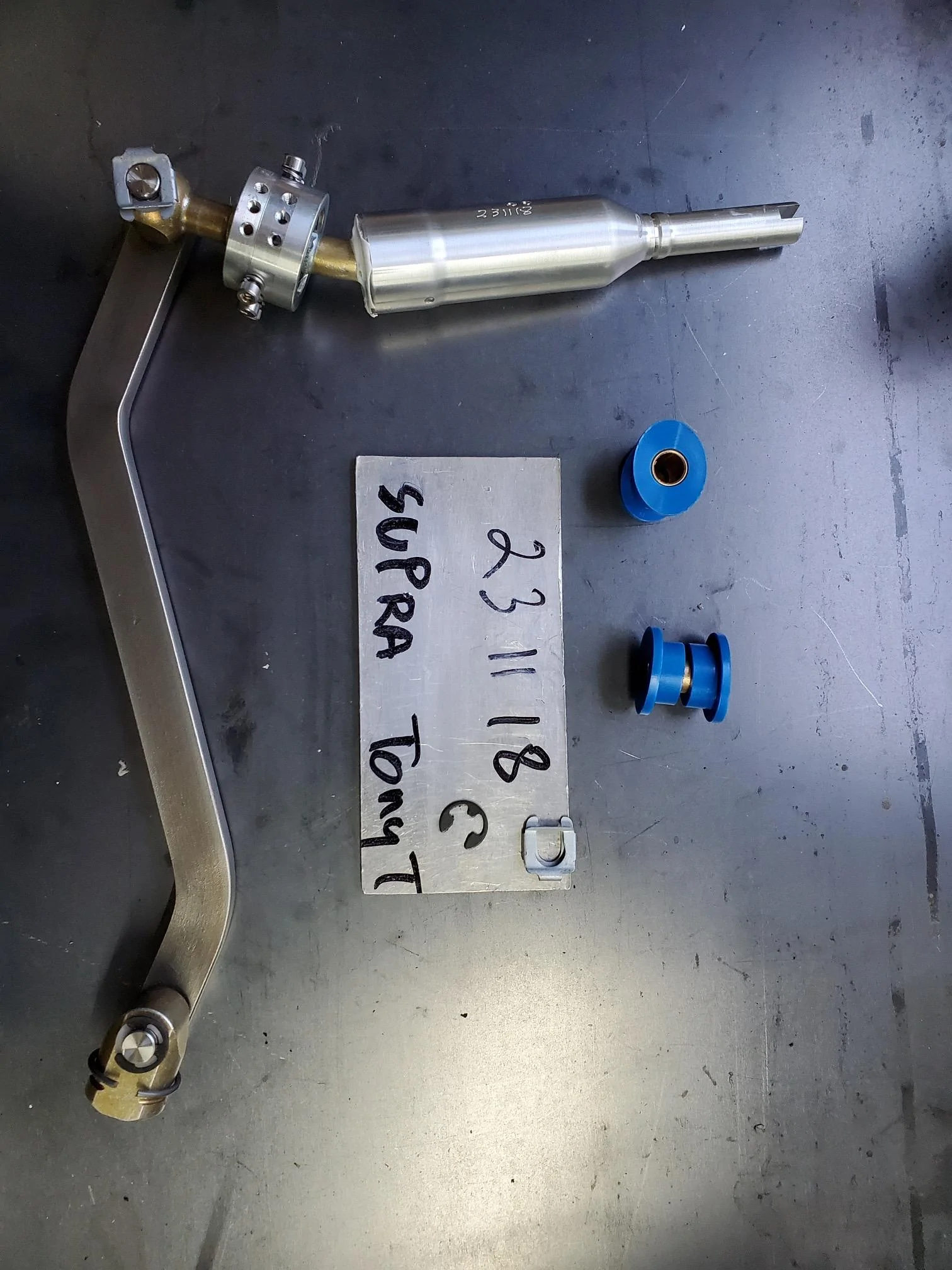

My car is the development car for this kit.
I sent Ron the stock lever and DSSR to make the kit.
It's being installed this week.
Ron and I have been working together on a few different BMW kits for a while as well, every car in my sig has an Autosolutions SSK.

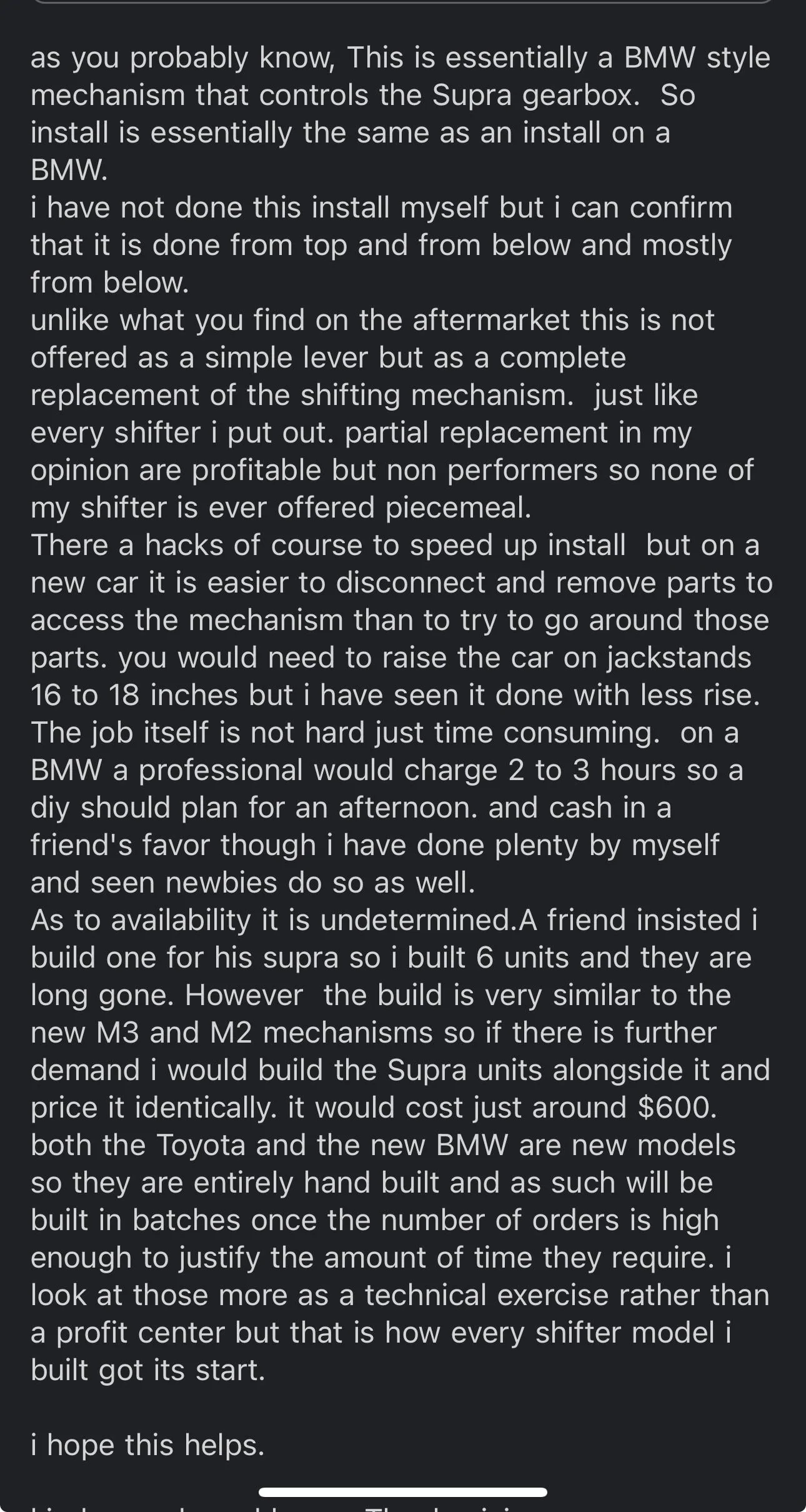

IDK what the video was talking about but this kit doesn't reduce throws.
All 6 kits made are exactly the same with mine having the autocross cartridge as a test.
We specifically designed the kit to retain stock throw length.
The main point of installing this, is to completely eliminate shifter slop which this car will eventually have inherently because it's a BMW product.

There is slop. My car has 2500 miles on it and it's got slop.
If you haven't driven a car with an AS SSK or a 997 GT3 or 05 Ford GT, it's got slop.
It's not bad for a factory effort but there's a ton of rubber in the linkage and with time it will fail.
It's $600 bucks but it's a $60k car. For comparison, a Numeric SSK for a 911 is like $1000 bucks.
