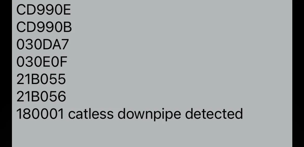

Anyone know what this code is? Haven’t found anything online on it. 030DA7
I also had a 118602 mixture control exhaust gas after catalytic converter too lean code.
Should I be worried?

Are all always on for me as a 2.0 with a catless downpipe... And i check the codes once a week since the CEL is always on with the catless downpipe. I've yet to see a 030DA7 or 030E0F.

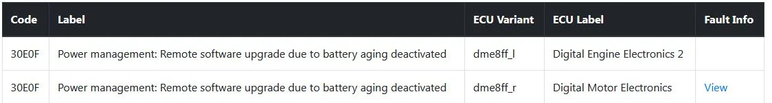

From what i can see online both are battery related. Might want to try a trickle charger if you arnt driving the car a lot? Or you might want to have the secondary battery checked out.
Im thinking the same, i don’t drive the car often and I just checked the battery is a bad brand 👍

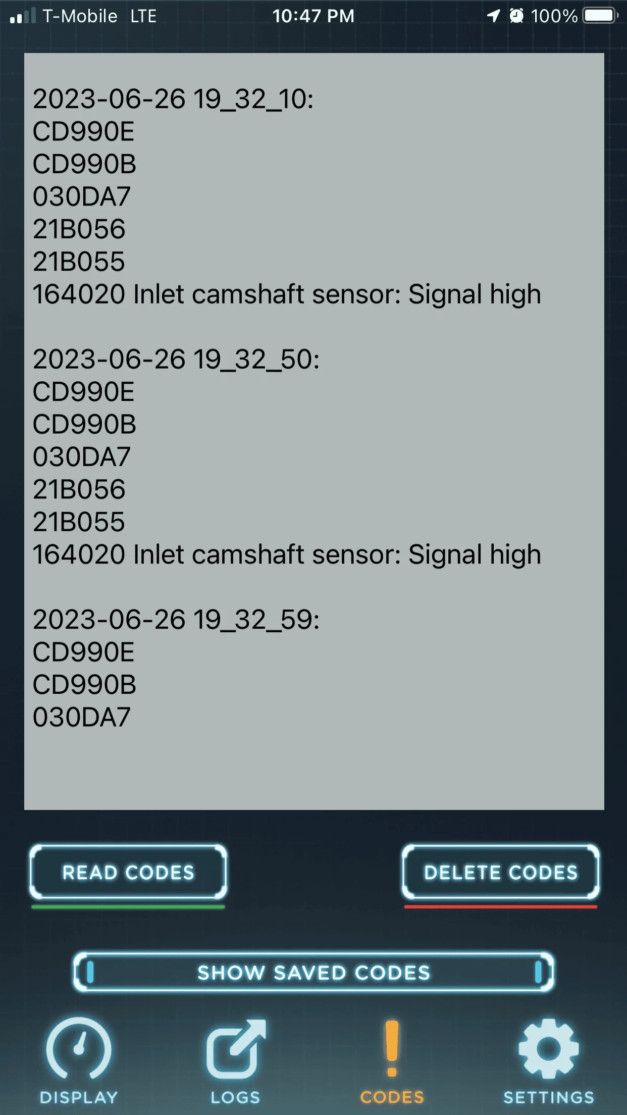

Somewhat of a similar issue. Just installed jb4 with takeda intake and chargepipe. Getting these codes. Anyone know what’s up? Could be a bad battery or sensor.
