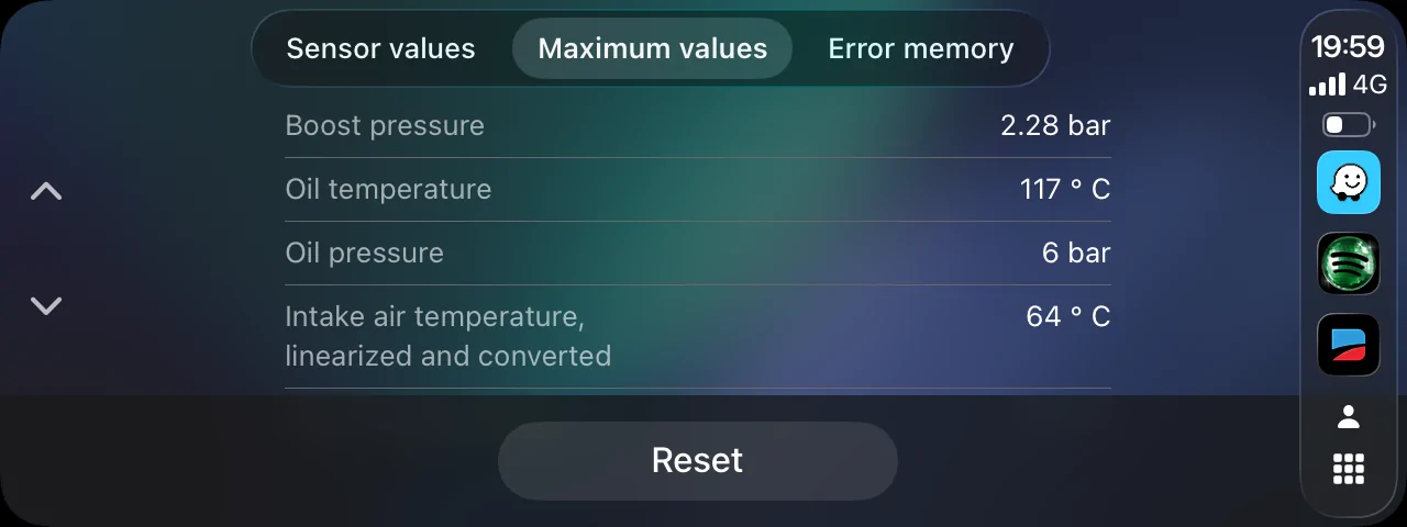

I have a 2.0 Supra (2023). Car is at around 30k miles now. Installed a JB+ last year (and >10/12k miles ago) and kept it at the "conservative" 3PM pot setting.
I use the car for long distance traveling (vacation, etc.) across Europe, and it has been running absolutely perfect.
You can feel a tiny bit more push with the JB+. I do not want to mess too much with the car, JB+ scratched a small itch, everything is peachy.
Now, I was recently bored and purchased a new OBD module that is compatible with BimmerCode/Link (the older one I used on my bikes wasn't) so I purchased BimmerLink as well.
I do the odd trackday here and there and I wanted to be able to see oil temperature, so I set-up a little dash with the oil temperature and, since there was space for more, I included boost pressure. Because why not.
After a trackday I was watching the max values logged, and the boost pressure seems a tad high: 2.28bar (33psi)
Initial assumption was that it is an absolute value (1bar + boost), but the display reads 0 or 0.01 when the car is idling.
Considering 33psi seems unrealistic on this engine... or at least unrealistic without blowing up the engine :D
Is the that data point from BimmerLink unrealiable? Or maybe that max figure is just a misreading (I have videos from inside the car, I'll check if I can read the figures during the sessions)?
Curiosity more than anything else... and a chance to learn a thing or two.
