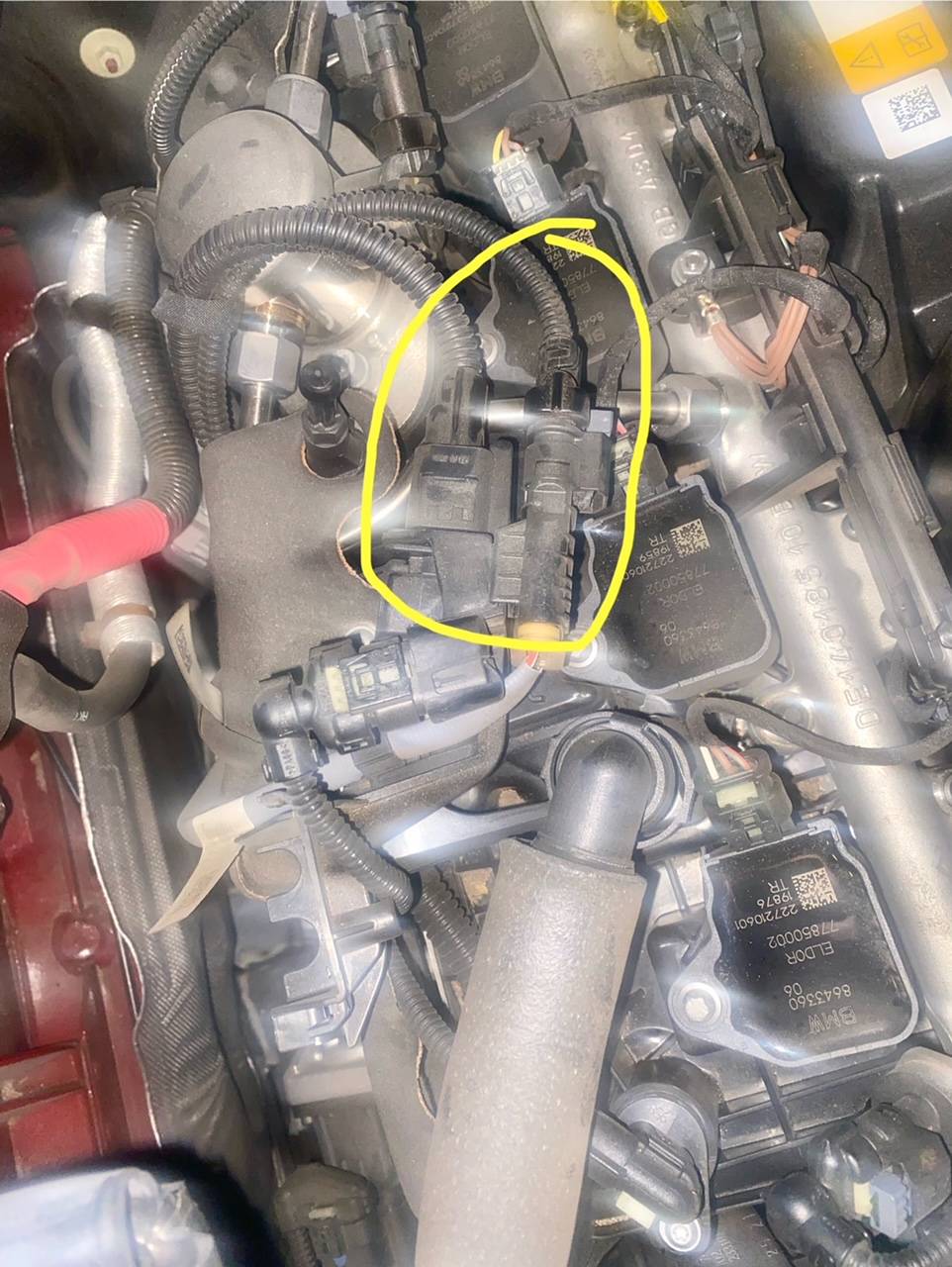

Hi Everyone,
I have everything ready to go to change the spark plugs on my B48 engine. I have researched my question on this site as well as several You Tube videos on B48 spark plug changes. My question is how do I remove the wiring harnesses highlighted in the attached photo? Thanks!

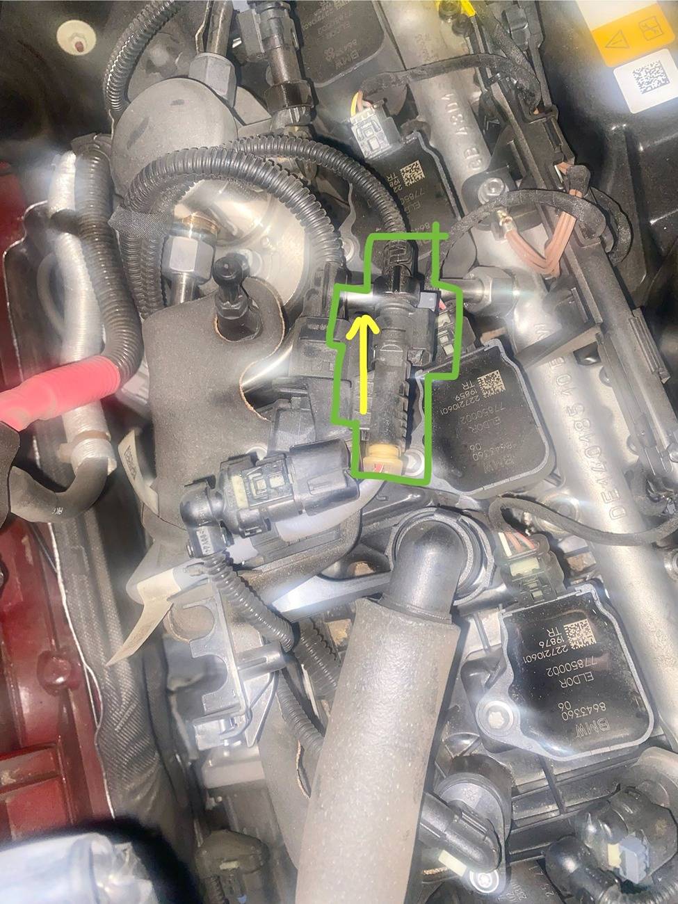

So I changed the spark plugs today. Easy job. Removing the wiring harness was easier than I thought. Just slide the connector closest to the spark plug (highlighted in green) towards the windshield as per the picture and it pops right out making access to the 3rd spark plug easier.

You can change the plugs without even disconnecting that part. Easy work around.
