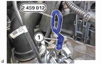

I need to replace a leaky engine mount and I'm looking for recommended attachment point(s) to connect to the support bar.
The workshop manual I have is showing to use this tool, but I cannot find where this would connect.
Thanks
Edit: Never mind. I'm vision impaired. It's on the front passenger side of the engine.

if you dont have the OEM engine hoist bracket pictured in the manual, you can use a longs grade 8 bolt screwed into thathat position to to support the engine. there 2 bolt holes on the front of the head
