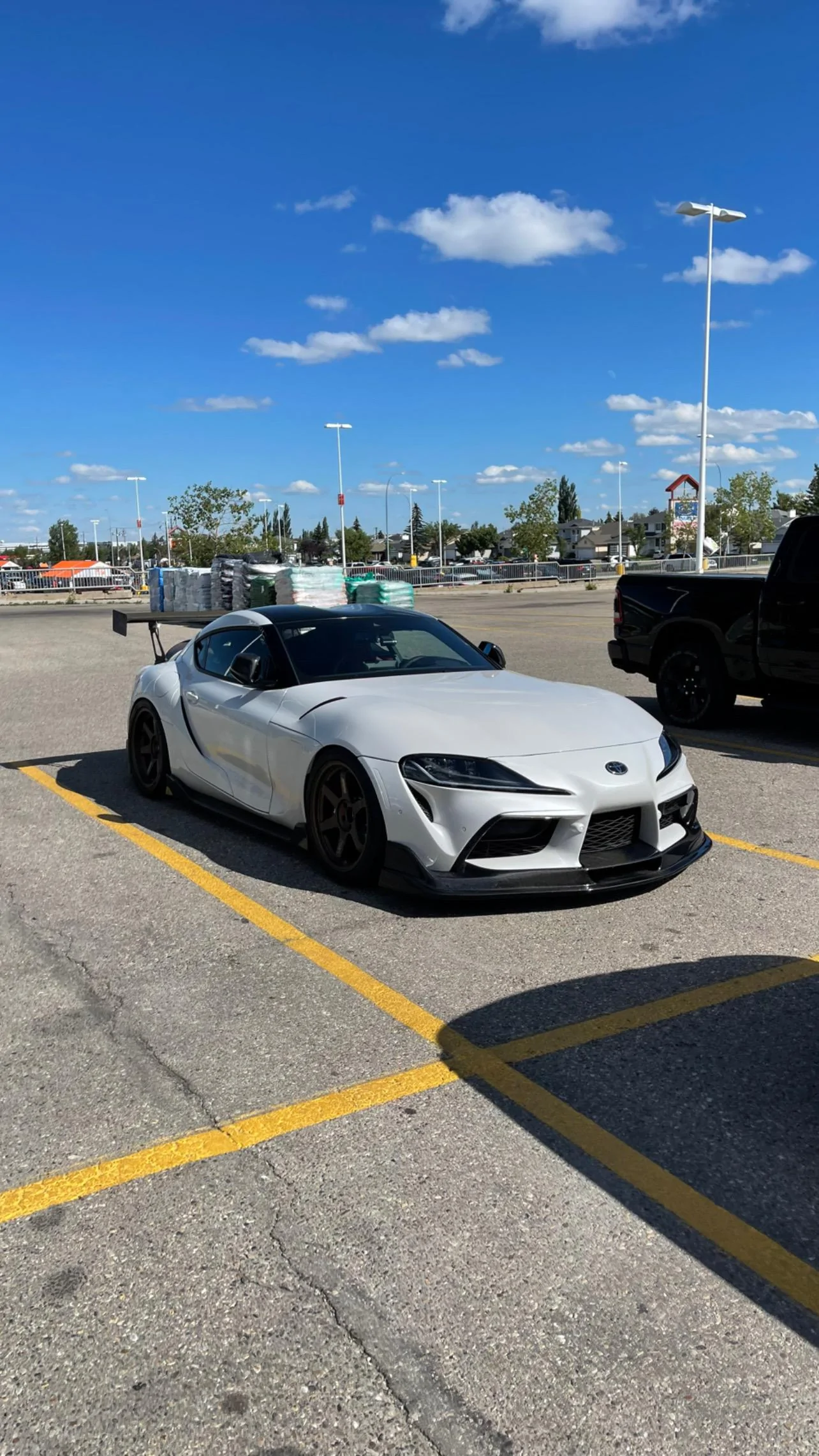

Bump! Its been a while guys! Not much has changed on the car the last few months but... Its about to go under V2.5 Spec.
I came across a used Verus Engineering UCW Wing and then hit up my friends at my local shop and they had the Voltex Type B End Plates in stock.. so I'll be installing the wing when it here this upcoming friday!
Also switching up my exhaust to the new SP1-R Titanium Single Exit which should be here soon as well.
I got some other minor stuff in works and planning from mirrors, big brake kit, canards, nothing to big. The plan is still to do a full frame big turbo in the next 2 years or so!

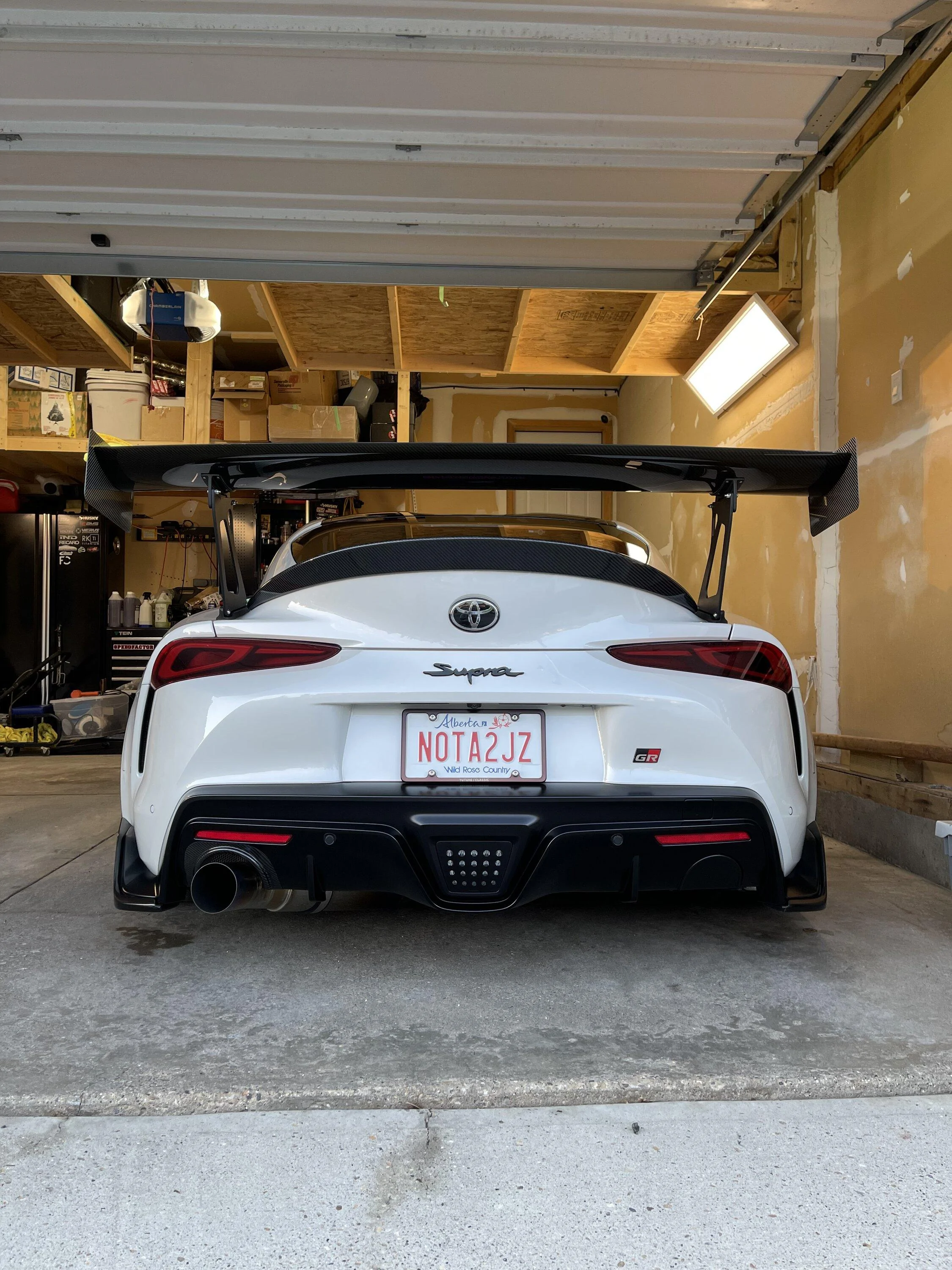

Big Wang Gang now. The rear end so stable with a GT wing, very functional mod. Although i know the looks aren‘t for everyone. Now for the SP1-R Titanium Single Exit, which will be much more aggressive to complete the rear end for now!

Is that the SP1-R Titanium Single Exit on the car now in the latest pic?
