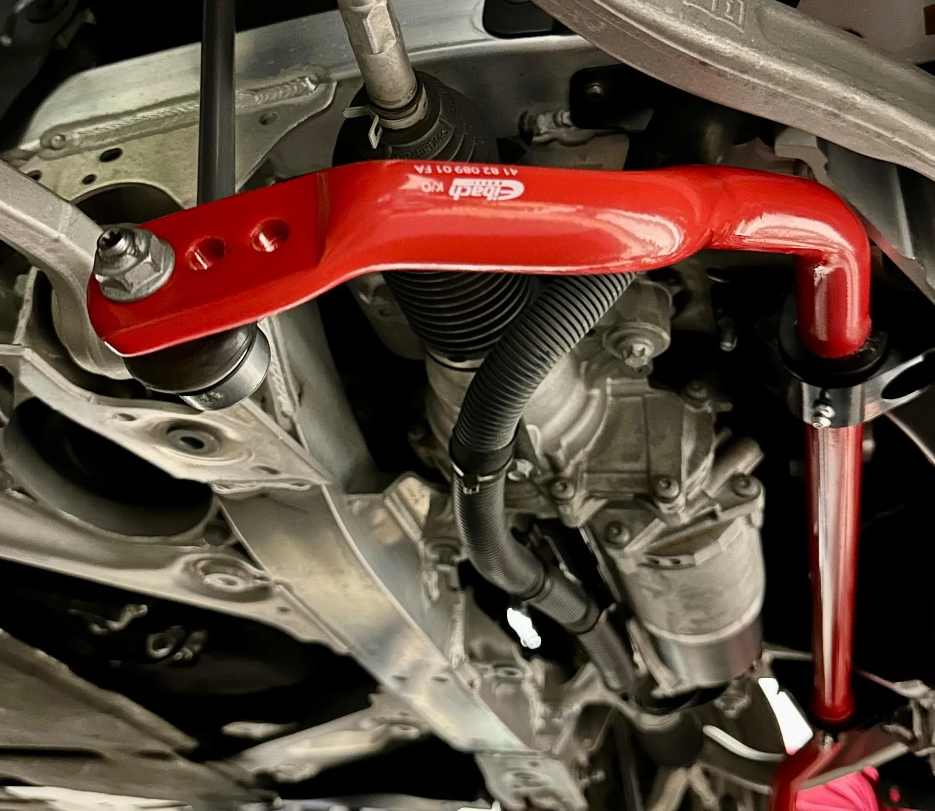

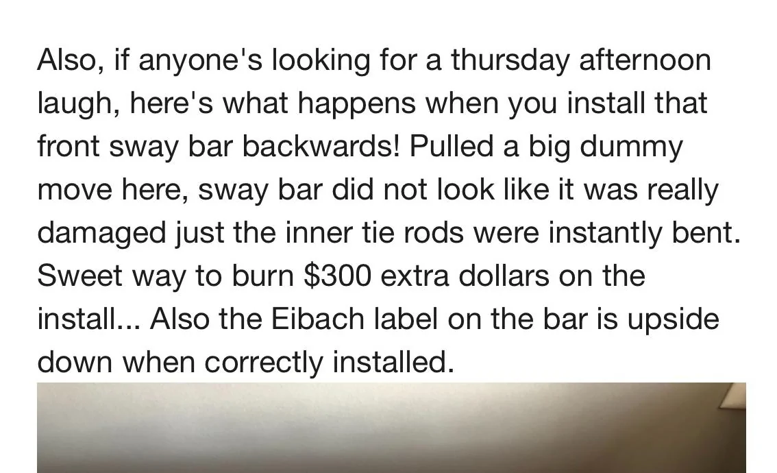

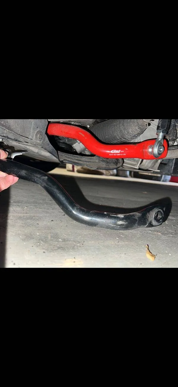

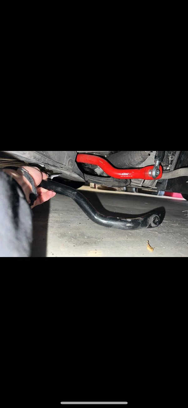

no it is definitely installed the correct way. Here is the stock one under the car in the same orientation. Let me know if you see something different?
I didn’t look back further but are you on 18 inch wheels, that inherently make you lower, in addition to your lowering springs? The Eibach lowering springs were too low for track use in my case & caused more tension than the rods could take. I’m now back up to an acceptable height on my Ohlins & have adjustable parts to give me more wiggle room, aggressive track alignment in my case. Also start on the “softest” sway bar settings. That’ll be way stiffer than the OEM sway bars.
Regardless, no more bent tie rods for me after we did all of the above. Hope that helps!
Yeah I swapped down to 18inch square set up! I think aftermarket tie rods will solve my issue! How much did you raise your ohlins up, what’s stock ride height?

Also have you looked thoroughly to see if there are any marks on any nearby parts that might say if things are contacting each other? Any rubbing marks for example, shiny spots?
Do people with this issue have something in common like sustained high G corners, or crappy bumpy roads, neighborhoods with speed bumps?
I think that idea of checking full steering wheel lock each direction is a good one. Suspension geometry is kind of cray, you could have things moving a whole lot closer together with the steering maxxed one direction or the other.
