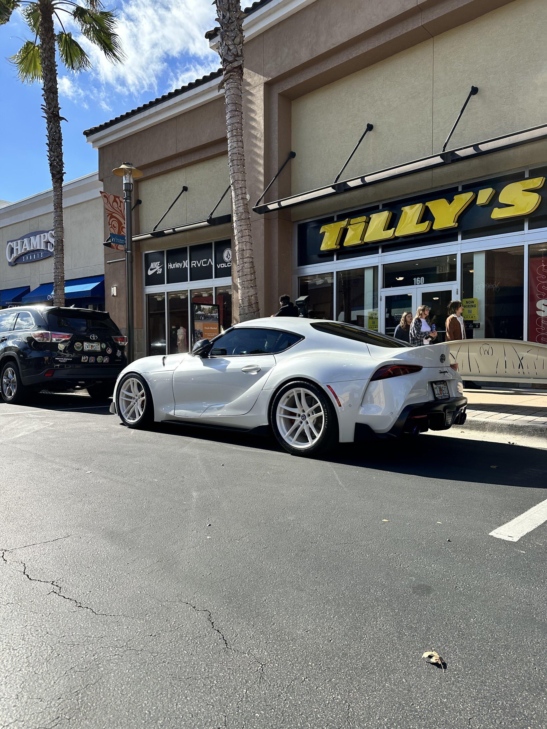

Hi guys so I have a 2022 Supra, I personally love the OEM wheels especially since having them powder coated satin black. But I want a flushed fitment. What size tires can I fit to get both flushed fitments in the back and the front without having to use spacers? Not lowered on anything yet. Potentially looking at eibach springs. Thanks in advance!

It also depends on the tire brand and model you are going with as they all have different sizing. But for most of them a 285/35/19 in the rear and 265/35/19 in the front fits pretty nice

Michelin PS4S 305/30/19 rear and 275/35/fronts. With that setup you can run some 13mm spacers in front and 10mm in the back. This is the exact setup in the pic below when I had the stock powder coated wheels on, no rub Perfect fitment.

which psi are you using on the ps4s?

Is that pic stock suspension, I like the looks of this setup, wheel gap, etc. I am wanting to shorten my wheel gap and be flush on my stock 23 premium. As long as there is no rubbing.

Are you lowered on anything by any chance?
