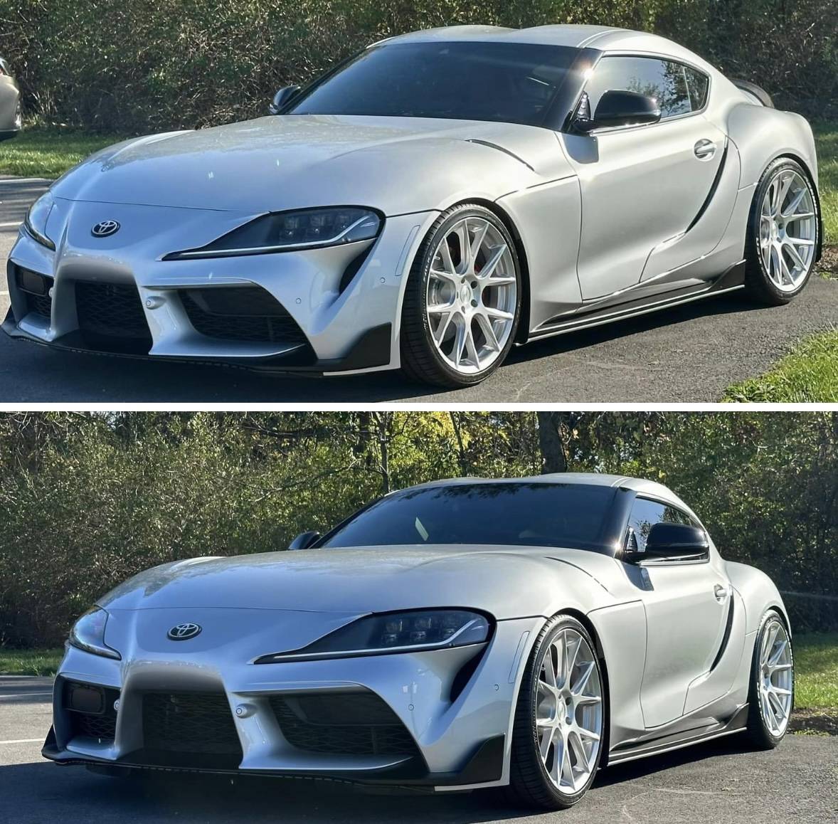

Here's my set up with Euro Z4 Eibach Spring. .8" drop on all 4 corners.
Vossen VFS6 flow-forged wheels
20" x 9" ET25, with 265/30R20
20" x 10.5" ET30, with 295/30R20
Falken FK510 tires
Only rubs on a very steep pitch on a rare occasion on the added rear splash guard inner area. It doesn't disturb the tire edge in anyway.

Your stance and fitment look amazing. But man I would wreck that setup the way I mob my car.

@Andrew4Supra setup is really nice as he’s taken it to what I would imagine are the limits of size vs lowering the car. If you are considering lowering at some point in the future then I would steal his setup. I was a bit different where I will not be lowering the car as it is a real pain in the arse where I live with speed bumps everywhere. And yes, wider 30’s does obviously increase wall height where my 305 30 is probably pretty close to the profile of the original tyre.
