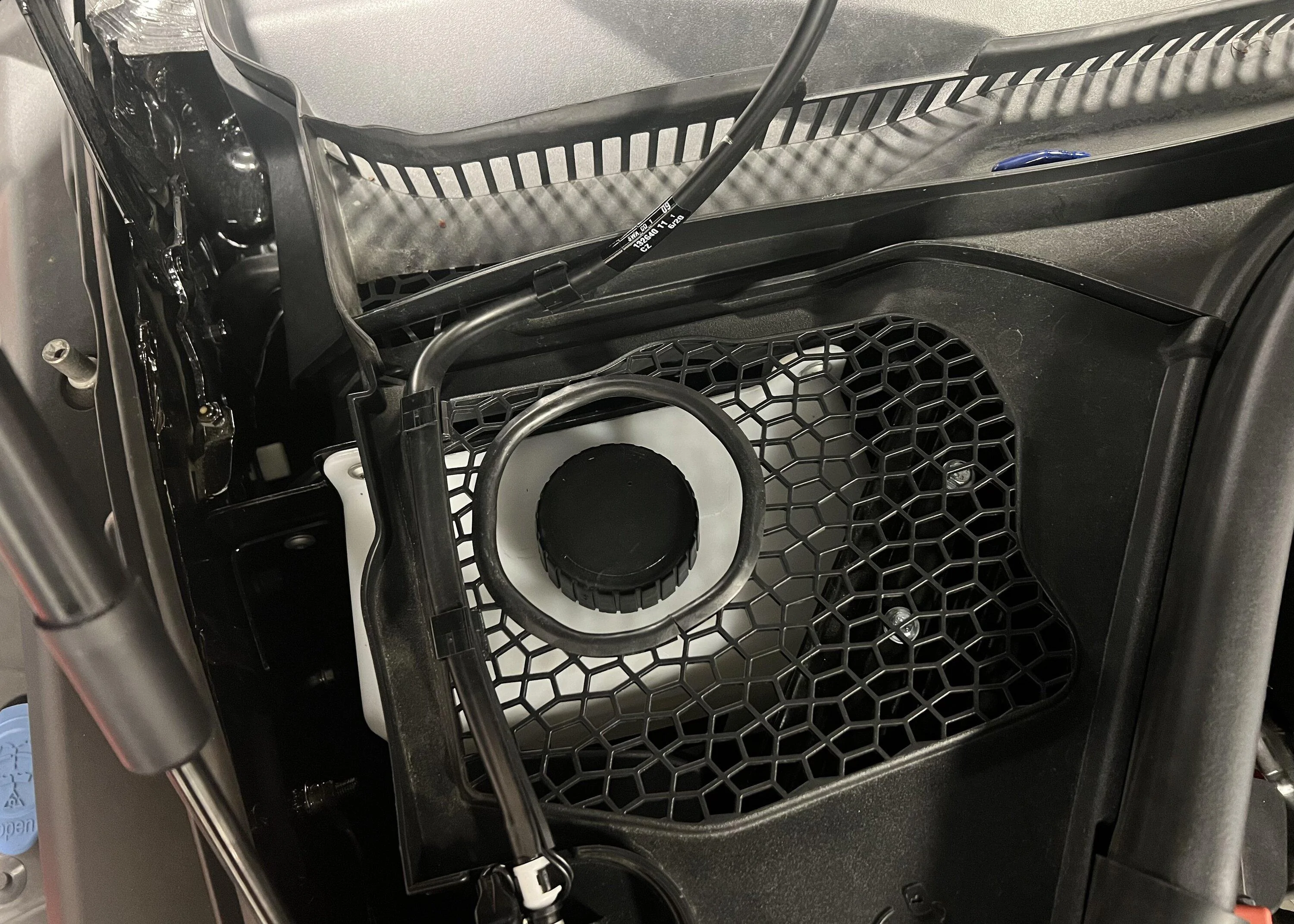

which Ethanol kit you’re running? Can you share a bit more details? I just installed an AEM methanol kit for cooling but interested to run E30ish for more power.
