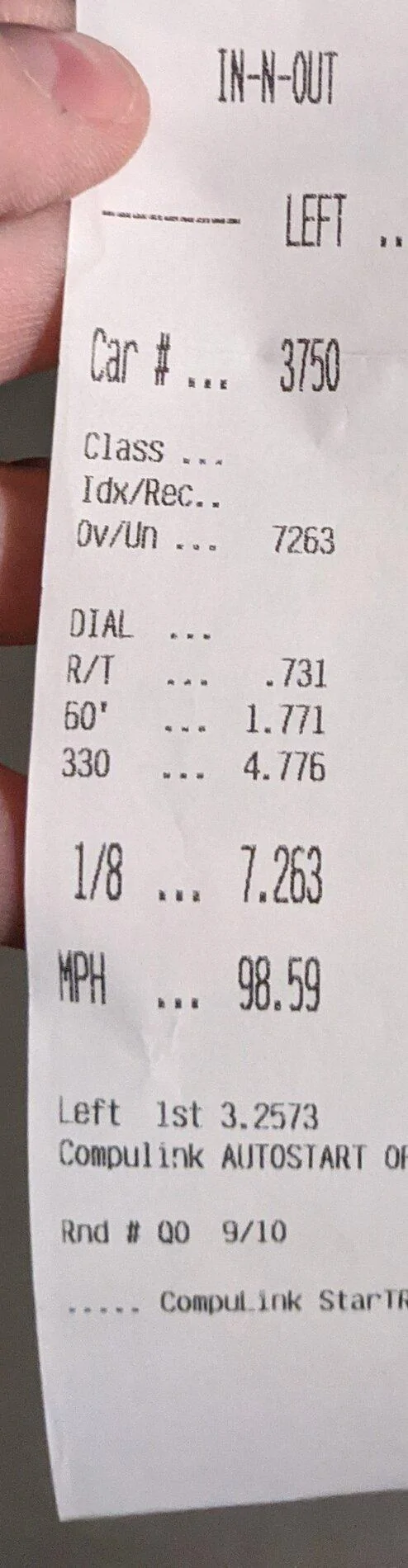

Post up your times. 60' and all.

Here is the slip for my best time when everything worked. The issue I am looking for help on is the limp mode, I should have run a log. It will even do it sometime when flooring it in auto mode.
