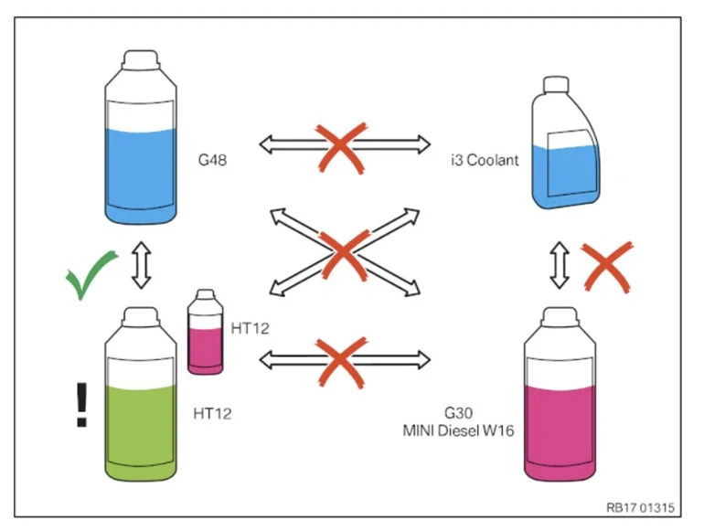

Actually HT-12, but you probably got the right stuff if it came from a BMW dealer.
It's a frustrating coolant to get locally. O'Reilly by me has it, but Walmart and Advanced don't.
You can officially substitute the G48 coolant that is blue, per BMW. But if you're just topping off a couple ounces you could use some distilled or RO water if you aren't worried about super negative temperatures. Going + or - 5 to 10% away from the 50:50 ratio won't change that by much. If you need a lot of coolant then of course it's best to get the factory fill stuff.
Lots of online suppliers as always. Get some if you order other parts and take advantage of free shipping. Comes in quarts, too.
Pay attention to being pre-mixed or not as well.
lube up the threads with a small amount of grease
Good idea, I may do that as well. Dry coolant likes to act like blue Loctite.
