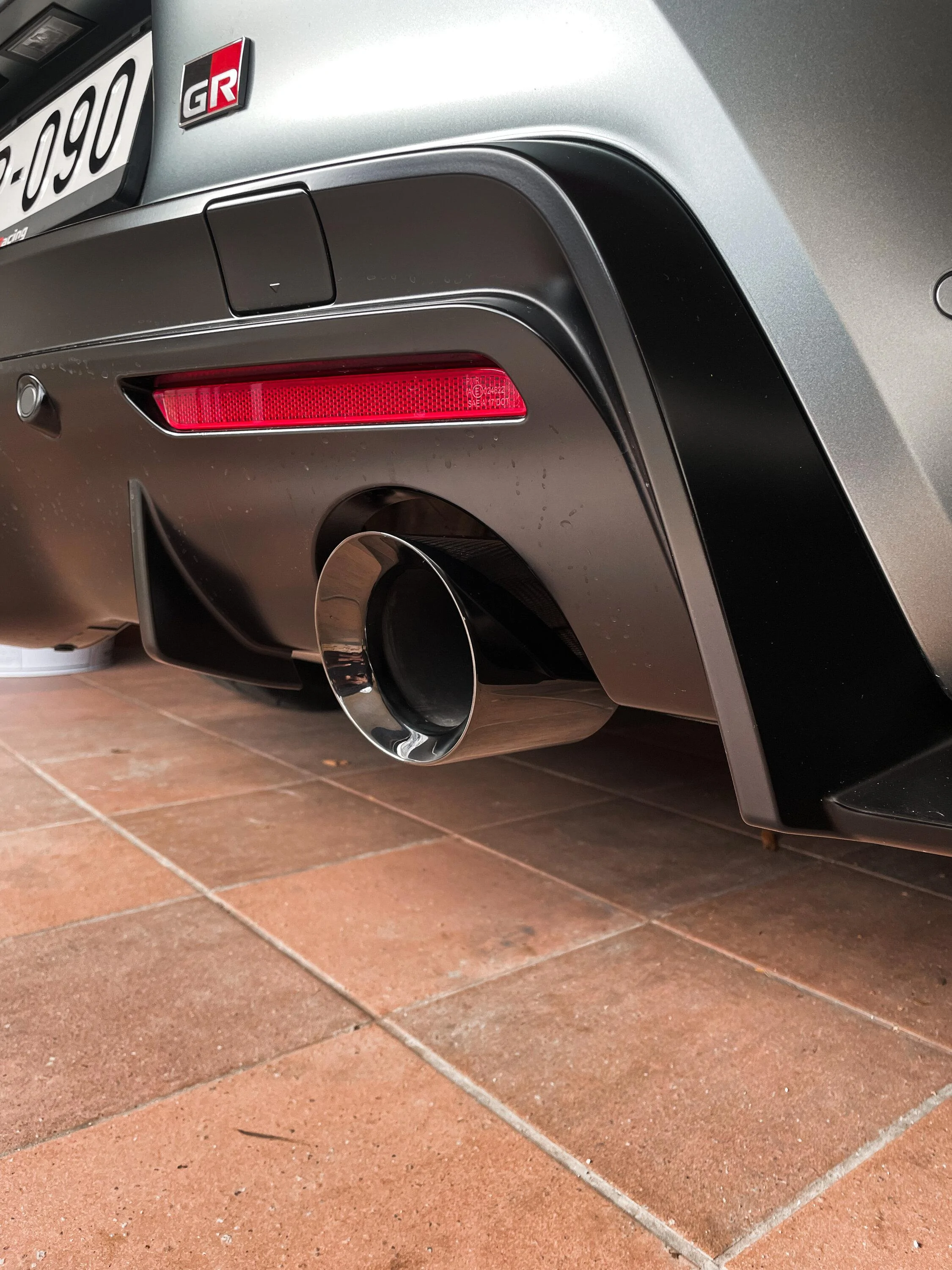

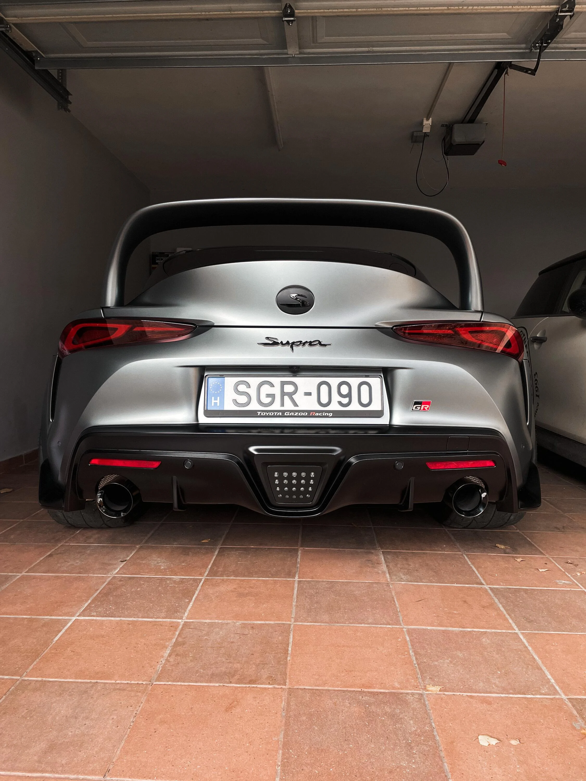

Keeping the factory exhaust and doing a back box mod makes a significant difference on European models while being budget friendly.
You can also add our slip-on replacement exhaust tips from www.supramod.com for a nicer look.
