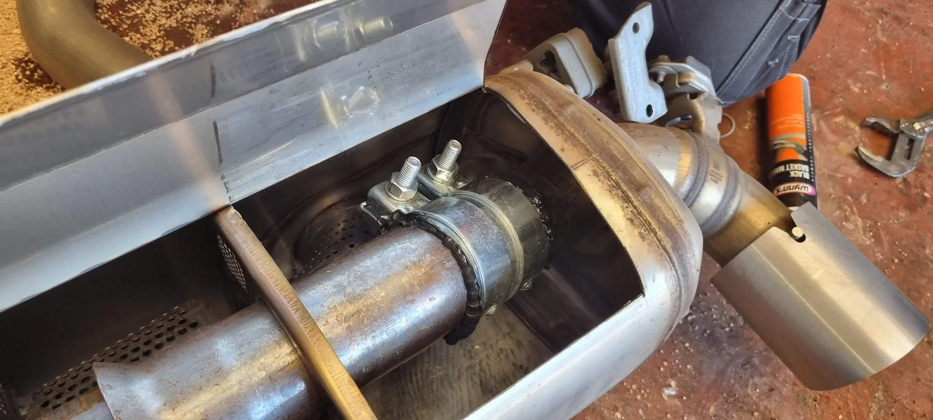

Ok all done!
Anyone in the midlands be sure to go here:
https://www.dktuningsouthmidlands.co.uk
DK Tuning South Midlands
Did a great job - took direction from the previous threads and video above.
All in all took over an hour - and cost shy of £99.
I've told them they may be a flurry of MKV owners popping over.
Opened up - removed wadding on right side - clamped over holed portion of exhaust. Then rewelded.
Sounds a lot better with more deeper tone and burbles etc are more pronounced.
Valves unaffected, and can be put to stock again if needed by removing clamped housing and rewadded then rewelded. Definitely worth the mod.
