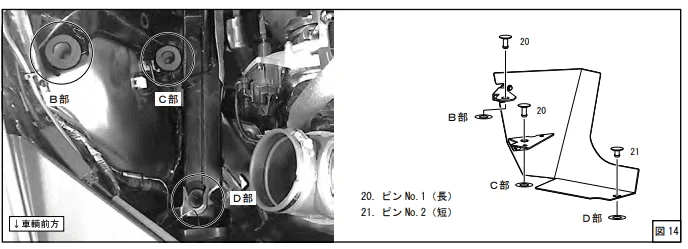

There are 2 different size pins for the grommets, 2 long and 1 short. At least for the non-box version. I would imagine the pin placement for both would be the same. The shorterpin is for the near (bottom "D")grommet. I'd imagine if the longer pin was in that place there would be some wiggle room.

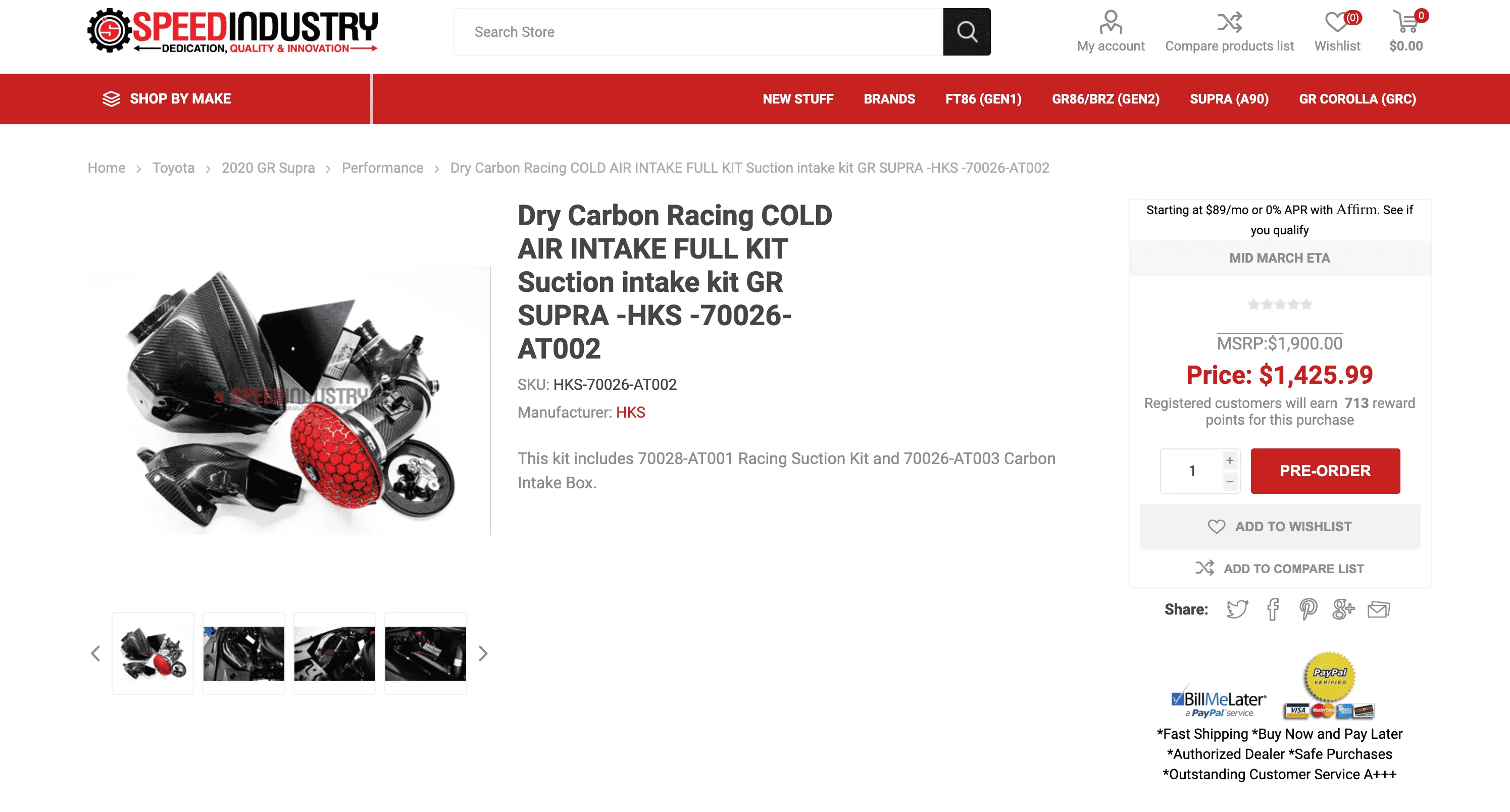

It's really $1500 for the intake? Eesh.
Yeah! Speed Industry has it on "sale" for that. Listed at $1,900. I know it is SUUUPPPPPEEEERRRR pricey compared to the popular MST, Armaspeed, etc options but I wanted HKS. Definitely not convinced the HKS tax is worth it. Sure does look pretty in the engine bay though. If I were to do it over, I would probably go Armaspeed or try matching up AWE's S-Flo intake with my AWE exhaust. Although that one ain't cheap either.

There are 2 different size grommets, 2 long and 1 short. At least for the non-box version. I would imagine the grommet place ment for both would be the same. The shorter gromment is for the near (bottom "D") hole. I'd imagine if the longer grommet was in that place there would be some wiggle room.
Those were all in the right spots. Just a crazy amount of wiggle room for some reason.

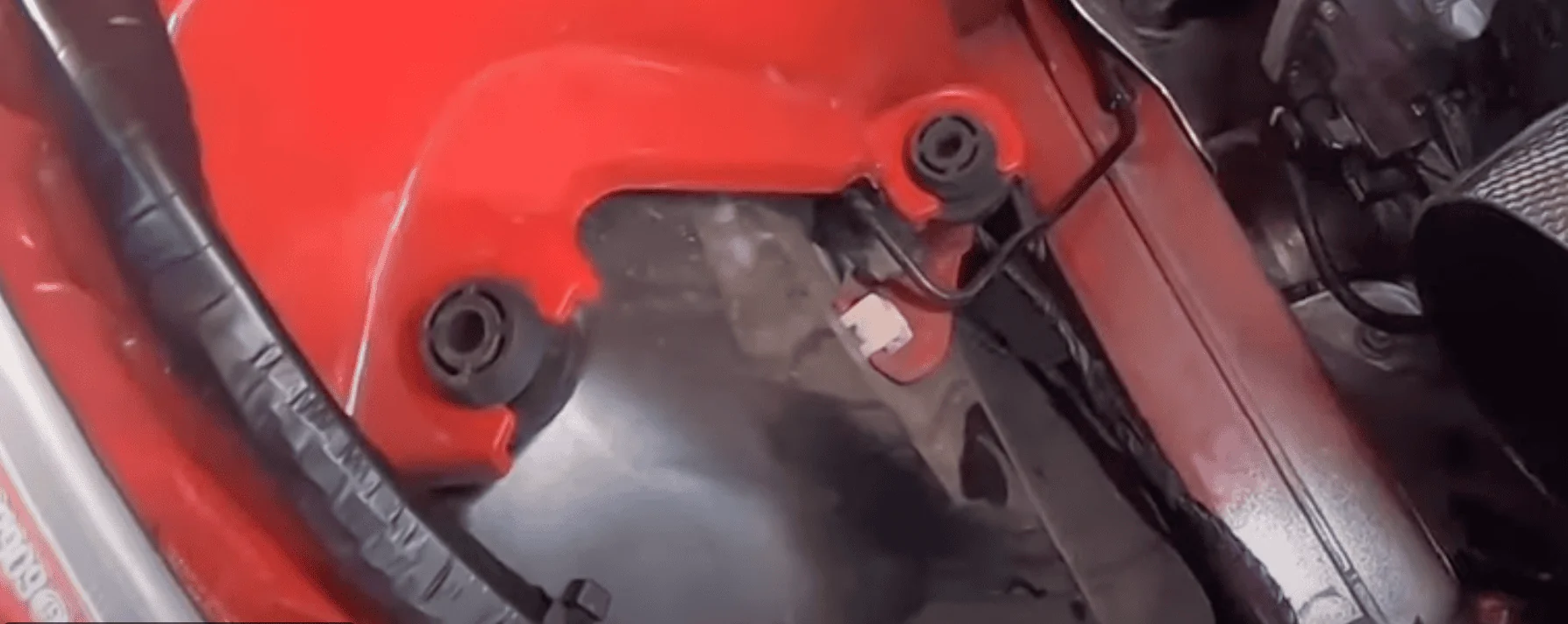

just to rule it out, you have the grommets with the "funnel" side on top, correct?
i recall seeing one youtube tutorial where the guy put it on upside down.
at 10:25 you should see one on the left side still upside down as he's complaining about the other grommets falling out
Mine are opposite of what is shown on his video/this screenshot below. So mine are in the proper orientation, correct?
