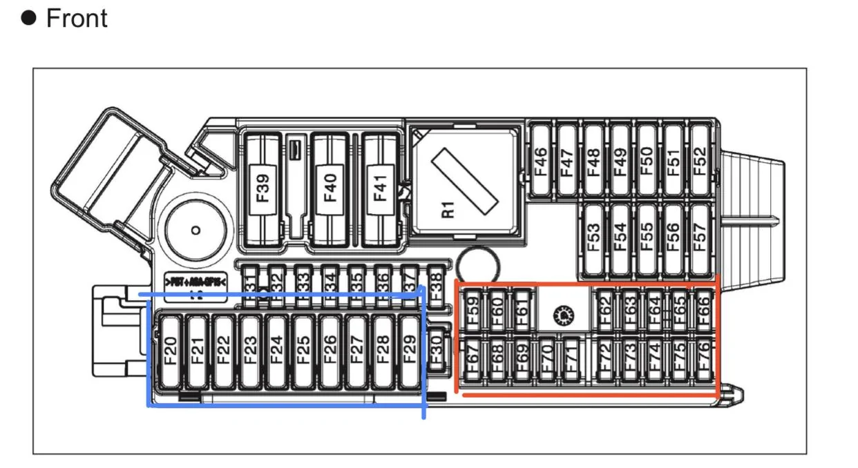

Trying to find a constant fuse to tap into for my A139 Viofo Dashcam.
I know I can plug the ACC fuse into F47, and the ground to the bolt next to the panel, but I don't know what to use for the Constant fuse.
I've searched these forums but can't find what people are using for the front panel.
I ran across the image below (Blue is all constant) but I want to utilize one that is low risk or isn't critical.

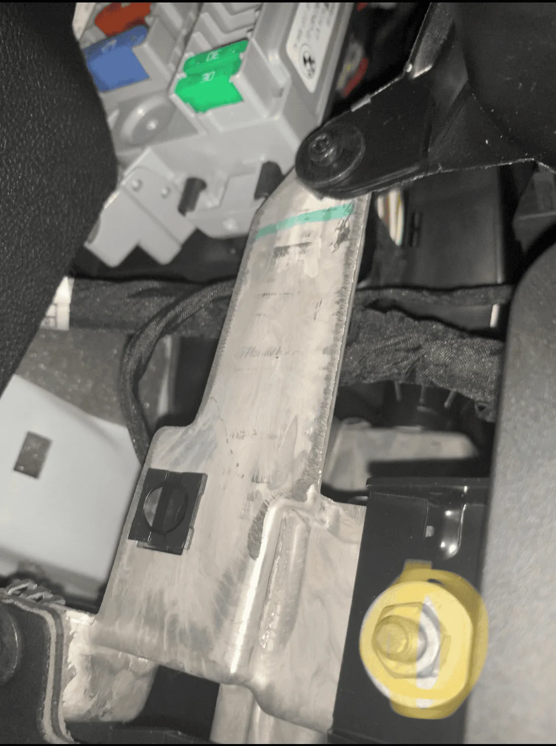

My ground point is between the black screw and the washer on the top portion of this photo (photo is from the 2nd link below). I don't think I would recommend the ground point I used to be honest but I couldn't really find another. In the thread below people use the washer highlighted. I couldn't use it cause the spade connector on my ground connection wasn't wide enough to fit the that screw the bolt was on, and that washer is attached to the bolt itself.
https://www.supramkv.com/threads/ground-connection.15113/
