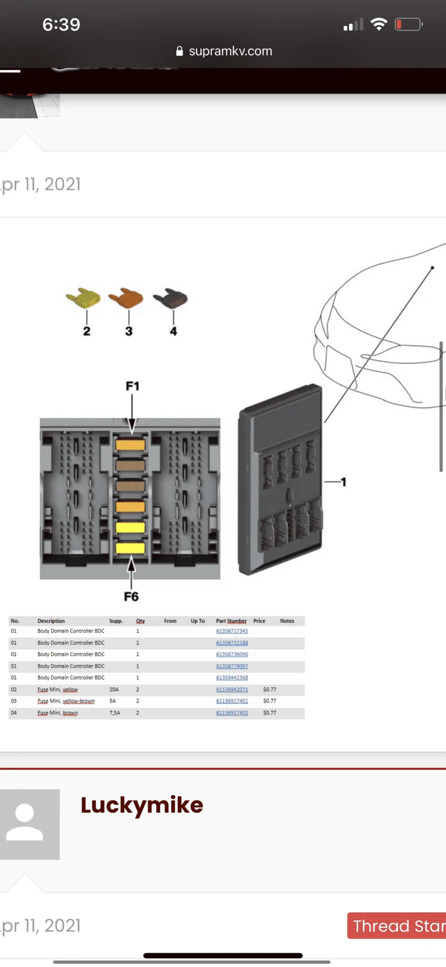

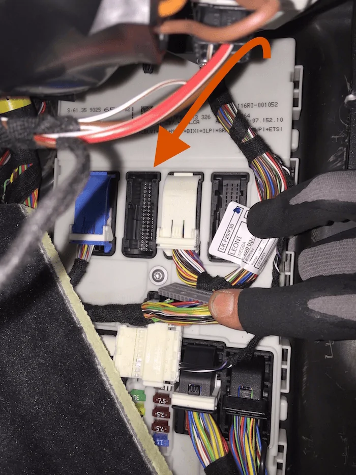

It should be located vertically on the right side of the passenger footwell, on the right wall. It's basically a giant ECU with 6-8 huge connectors on it. The fuses are just in a row in the middle.
Should look something like this (not exact same but close enough):

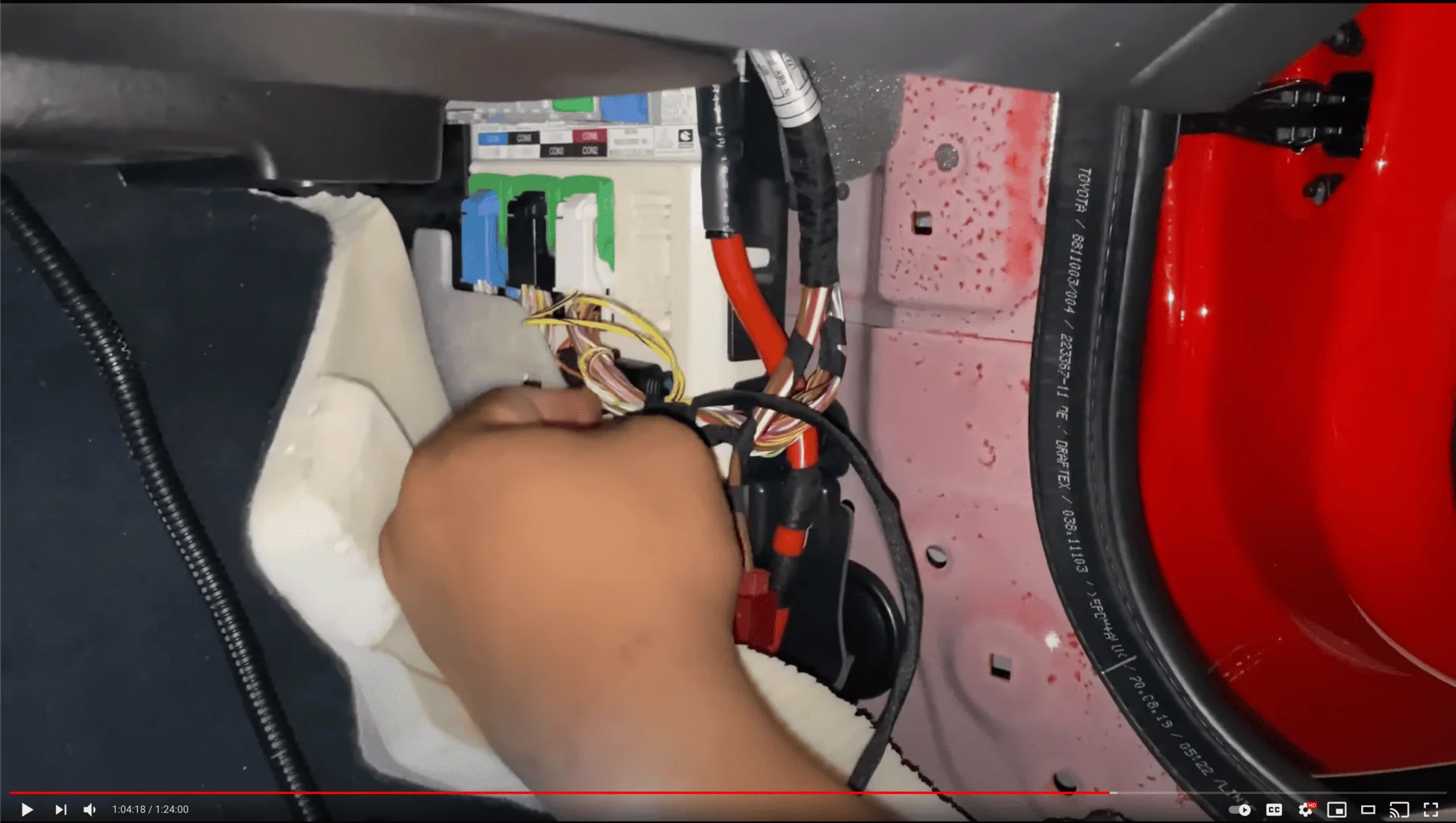

Here's how it looks in the Supra. This is a screenshot taken from some random guy's Flex Fuel install.
Video is here:
Look at about 1 hour into the video.
