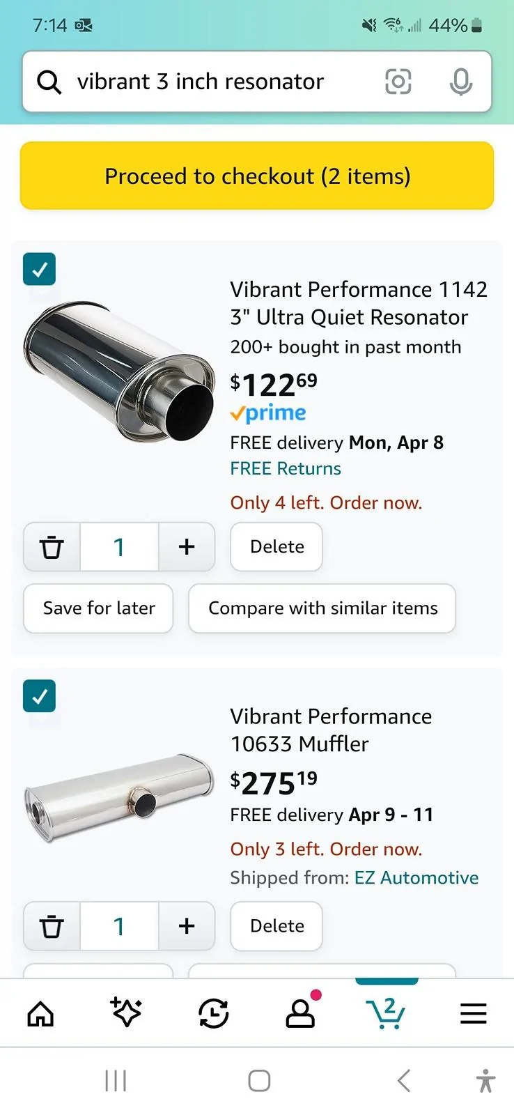

Hey so I'm looking to custom fab an exhaust for my 2022 a91-cf supra. And I need to know what is the size diameter of the outlet section of the down pipe. So I order the correct size piping, resonator, and muffler. I'm thinking about coming off the dp cut the suitcase resonator and put a single inlet, single outlet vibrant ultra quiet resonator. Then single pipe all the way to the back of the diff. And then use the vibrant transverse muffler with single inlet center, dual outlet side. Suitcase style muffler and utilize the stock tips and stock valve on passenger side. I read that the outlet size for a91 is 3.5in from the dp then the rest of the pipeing 3 inchafter the suitcase resonator. and i want to make sure or if its 3 inch from the dp to 2.5 the rest.

Stock dp. Stock exhaust ATM just want different sound I've had vibrant before on a 2017 Volvo s90 t6 with the exhaust flap on passenger side just like this set up and sounded good. But was a twin charged 2.0l 4 banger. As where this a91-cf edition is the 3.0l inline 6. I have simular set up on my wife's bmw x5 35d the vibrant transverse muffler in the rear but vrsf catted dp and bottle resonator on the x5. Sound is good from there as well. Dimensions wize the vibrant muffler for the rear is a little bit smaller in overall size than the factory muffler. Also instead of breaking up and splitting the exhaust from single to dual back to single it stays single same diameter all the way back.

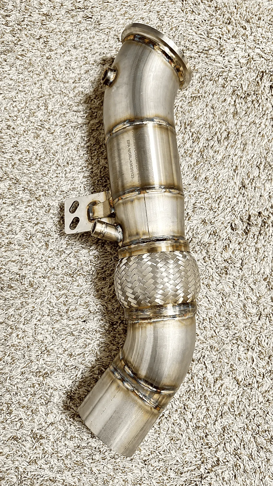

Outlet size of the OEM DP should be 3.15", not sure if that's the ID or OD tho. Plenty of aftermarket options and several threads in here mention it in case you want to confirm. I'd suggest not even worrying about modifying the OEM catback and just do everything after the DP. I'm gonna be going custom route as well but got the true 4" ETS DP into 4" oval pipe and then split to dual 3" with resonators and possibly small mufflers too.

understandable. All of the titanium options I've seen are just too pricey for just being a light weight option without any flow benefits. A lot of aftermarket DP call out their size using the biggest pipe they use for marketing but they all have to reduce to 3.15" if they want to be compatible with OEM catback. Marketing BS causes all sorts of confusion.
In terms of performance, everything that is compatible with OEM DP will perform the same since the smallest part in the exhaust will define the maximum flow you can have. That's why I went with the ETS (4.5" turbo outlet to 4" exit). I did keep it catted (GESI 850HP EPA rated cat) cuz I'm not tuning yet, really hoping for Ecutek to be available soon for '23+.
Nice dp BTW. Gesi cats are a great well known cat. And being obd2 and epa compliant are great. I how ever don't plan on tuning yet either I want to keep my oem warranty. Lol. But once warranty is out I may go full bolts ons. Or if the motor ever goes I may rip it out and replace with a 2jz gte.
