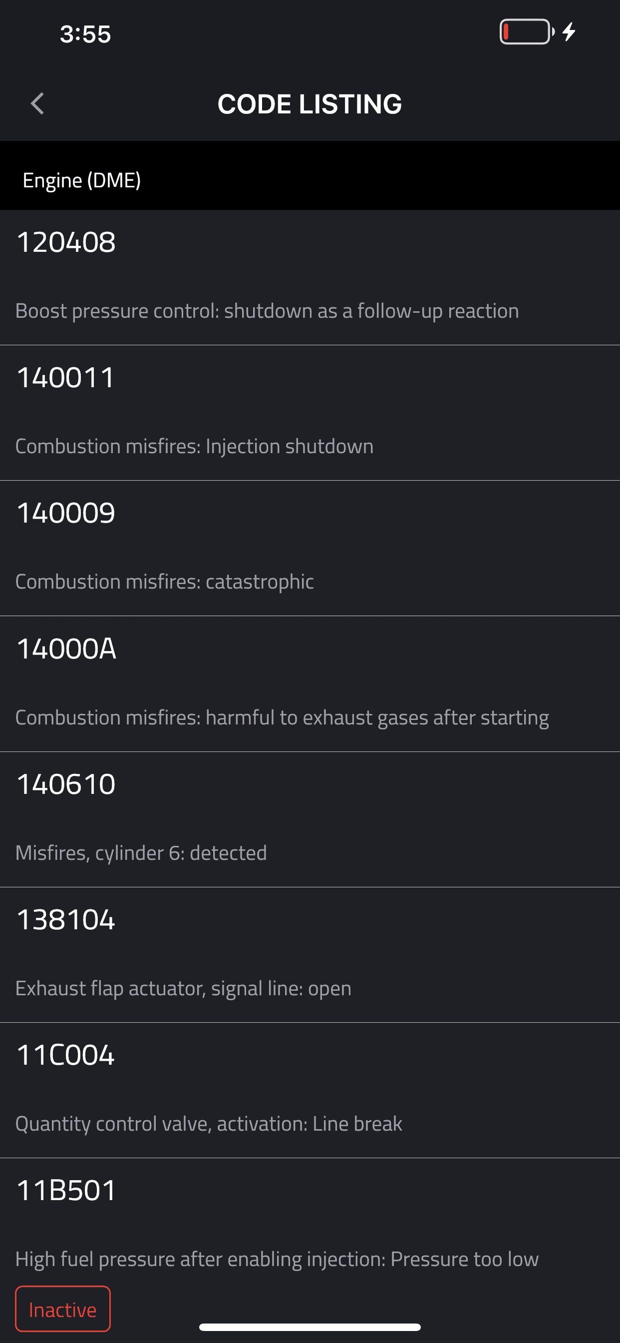

Backstory: Car has been running fine and I finally had time to get my DME unlocked. While my ECU was sent out, I installed the BM3 Flex Fuel Kit and waited for my DME to come back. After installing everything, I decided to flash the customrom map and the car felt way too shaky so I checked the logs. It seems cylinder 6 is misfiring even though everything was fine before. Any info would help.

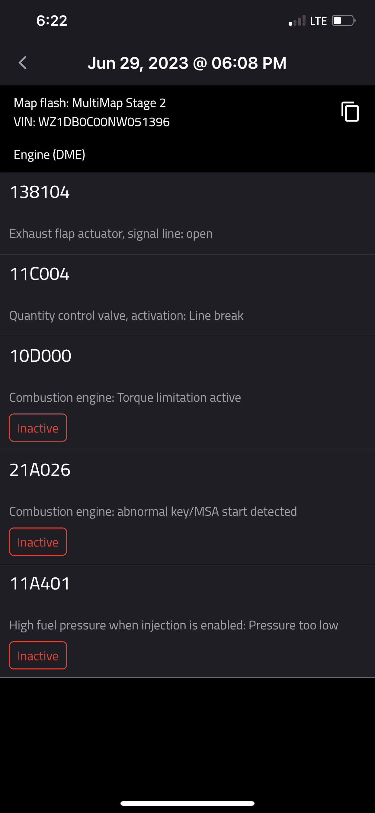

Update: Tried a variety of things including the help of Bootmod3. They are closed now so I am here asking for more advice.
Through my findings, flashing back to stock made the car not start up. This was weird because with CustomROM Stage 2 flash, the car started up. Customrom Stage 2 flash made the car very shaky as mentioned before with the same codes from the original post.
Maybe if I plug cylinder 6's electrical connector back in, I thought it might do something different. To my surprise, it did. The car started up and wasn't shaky. Although a drivetrain message did pop up, I drove the car around my neighborhood just fine. Keep in mind, I tried with Stock Map & CustomROM Stage 2 Map, and only Stage 2 worked.
I'm curious though since BM3's Flex Fuel install video said to keep the electrical connection for cylinder 6 to be unplugged. Did anyone leave the plug installed or uninstalled?
Screenshot of codes listed when the car was able to drive with the drivetrain warning.
